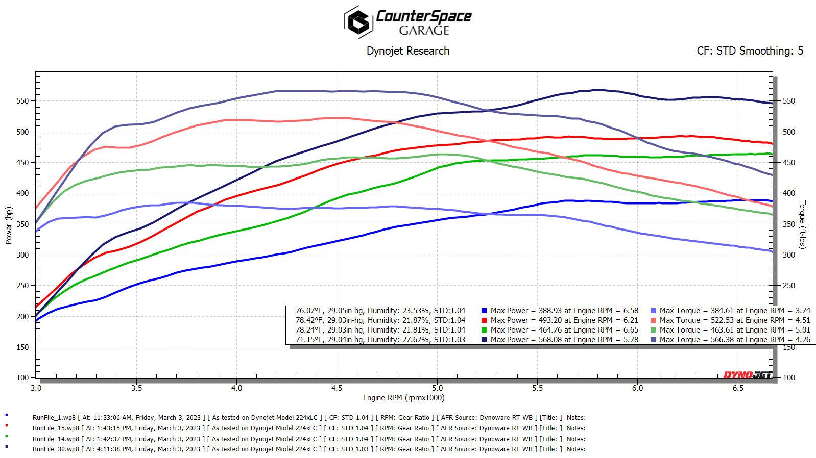

DAW Ultraflow
Conservative track tune with stock fuel system.
No PI, no HPFP, no meth.
Just stock direct injection.
Bright blue line is stock map
Red line is 93 pump gas
Black line is MS109
Numbers are legit numbers at the the wheels
A lot more in the turbo but was heavily fuel limited.
Hey @kyle9, since the new DAW naming is ultra confusing, which one is this? The Flow Max or the Ultra Flow R? Flow max being smaller than the Ultra Flow R.

That’s the original gen 2 ultraflow. It’s similar to the Flow Max but has a slightly smaller compressor wheel.

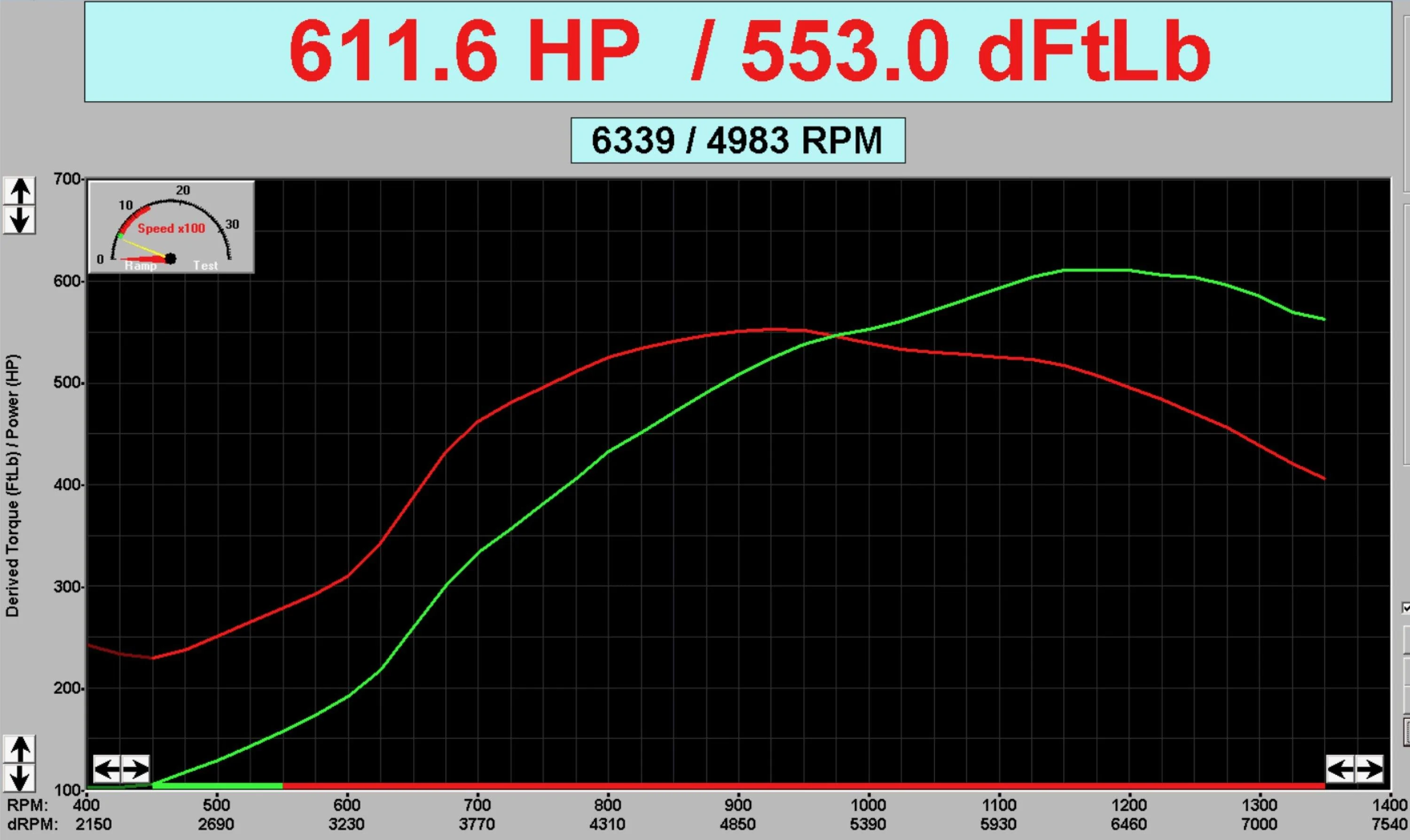

Here is the new Flow Max dyno with PI. It was done on a completely different dyno which AMS says it reads 6-7% lower than their dyno jet.
in terms of real world, I consistently gained about 3mph of top speed at Gingerman (139 -> 142). I think there is more power in the tune if we push the timing a bit more, but boost is pretty much maxed out at 32psi. Technically, you could run more boost but it’s out of its ideal efficiency range already.

Is this new graph on MS109?
kyle9
Kyle
May 19, 2022
426
574
Yeah ms109. They said the 611whp was equivalent to about 650whp on their previous dynojet.
For reference I was hitting similar speeds as Jackie’s supra on the straights at Gingerman (when he last brought it there). Slightly different aero setup but equivalent tires.
