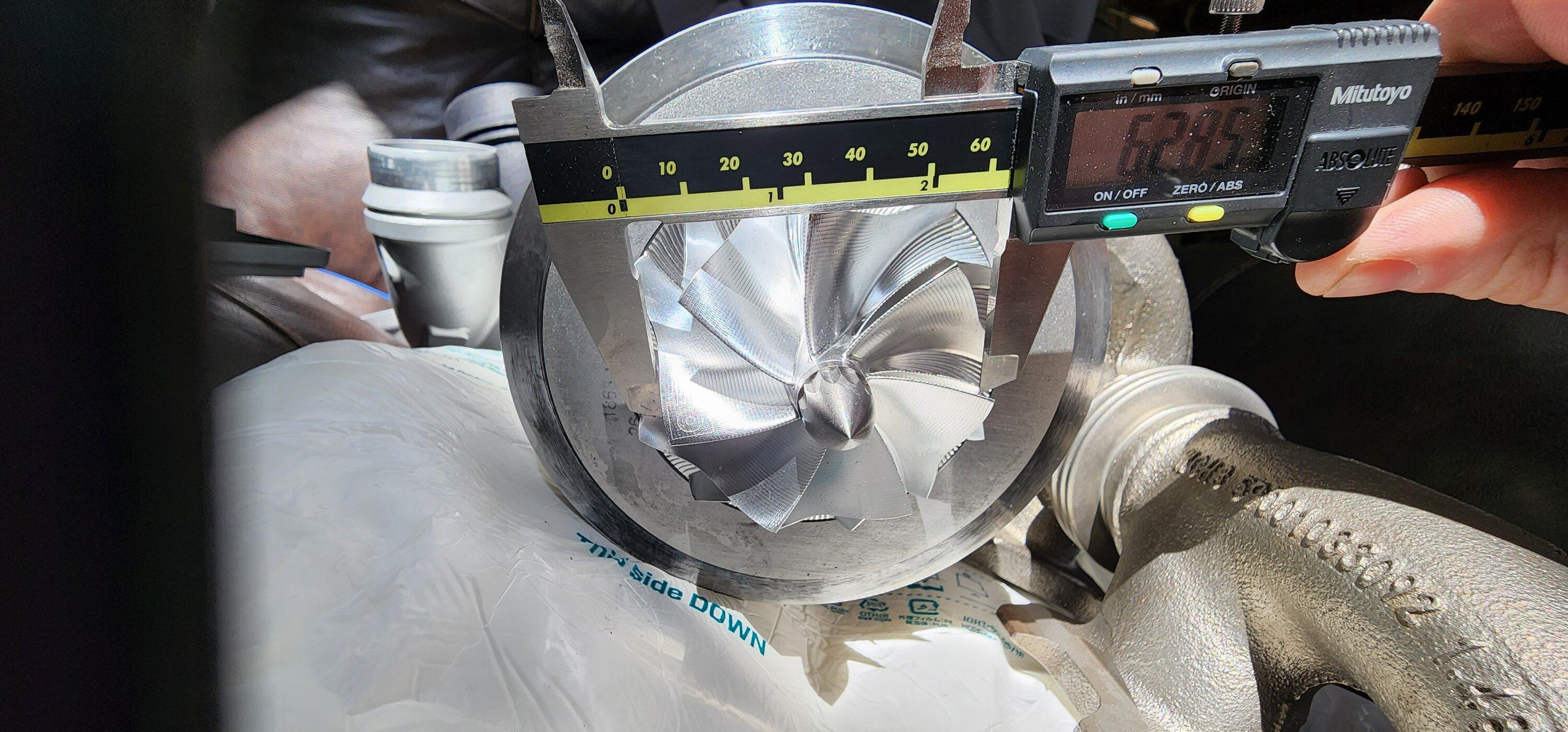

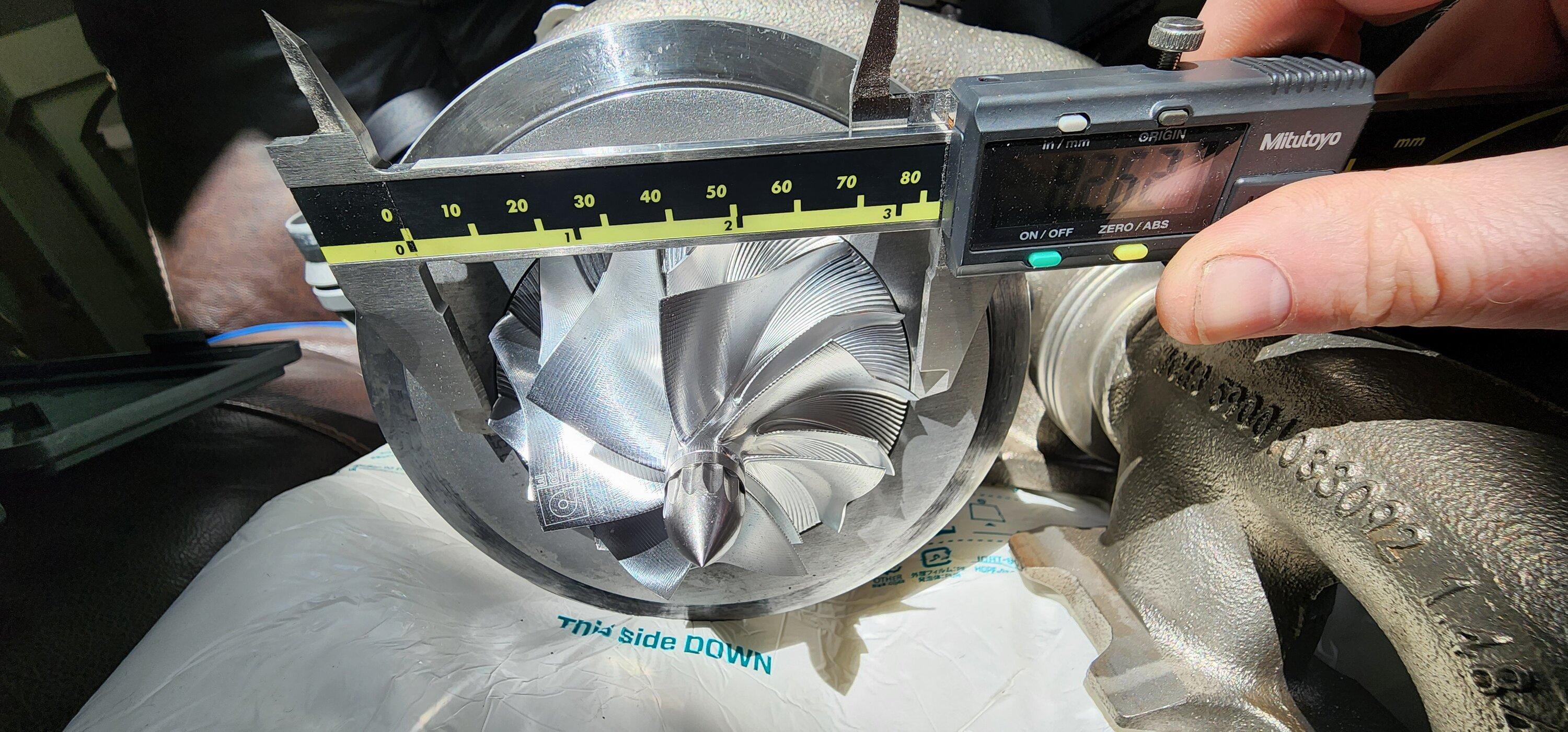

Already on the car but quoting Chris from Vargas:
and then the difference between GC and GC mid is whole casting and G30 (770) turbine wheel.
Those are compressor wheel measurements I assume?
8,757
17,169
Correct. Unsure of the GC+ turbine size.
So which is the compressor inducer size? I'm putting all inducer (compressor) in the list as that is mainly how people publish turbo wheel sizes, exducer on the exhaust side.
It can't be 46mm since that is smaller than stock. Not 100% sure what you mean by 58x46.
Looks like the G30-770 Exhaust Exducer is 55mm.
