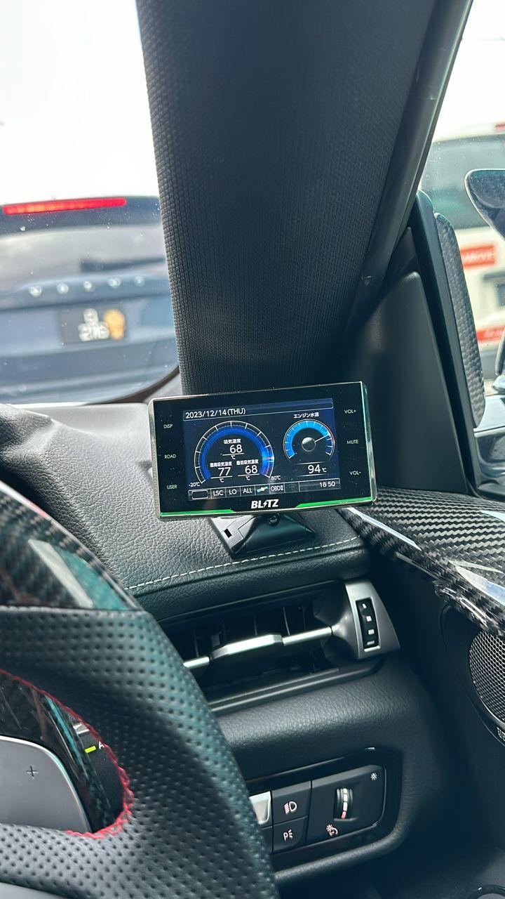

RIP? IAT ?
My IAT went up after turbo upgrade, since there are no turbo blankets for Omega 65, just had mi wrapped (laser welded) by Headershield.
Well post improvements after install.
I would expect engine bay temps to drop but unfortunately that won't provide a significant improvement in IATs.

This. Unless he is running an open cone filter sitting on the manifold.

def running open intake/filter, I know it’s higher IAT’s, but sorry just love the sounds ? of running open especially with a T51R Mod setup.
