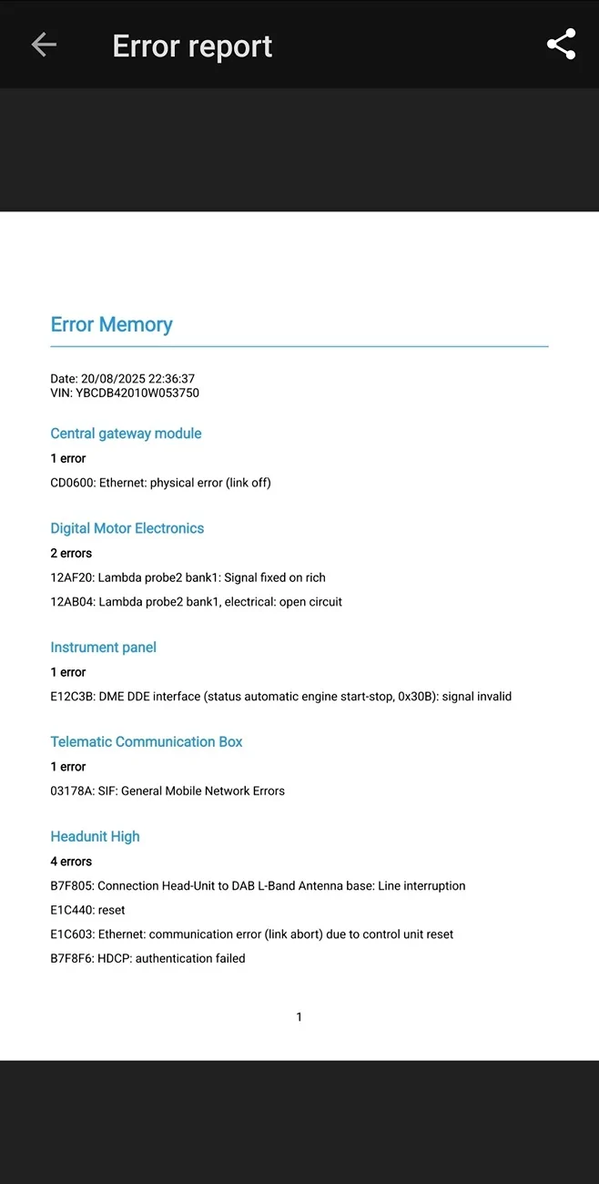

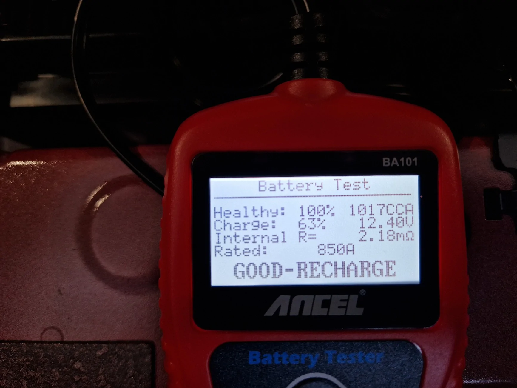

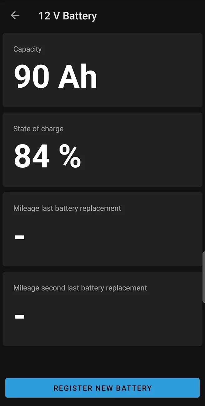

You had to burst my bubble 😅 I really hope that's not the case... And this code is just a by-product of the battery failing 🙏🏻
I measured the battery directly before I reconnected it (I disconnected it to charge it fully). That said, I think when I checked via BimmerLink a couple minutes later it was reporting 97%. Going back to the initial test though, which was 63% less than 48hours after driving it a good 3-4 hours, that surely doesn't seem right?

It’s hard to say and depends so much on your driving profile. I wish we had access to the algorithm, but from the documentation that is available, IBS charges the battery during deceleration events (an oversimplification, there’s plenty of disparate information out there if you want to read more).
I drive my Supra on average once every week or 2 and hook up a trickle charger afterwards until it shows as fully charged. Battery is 5 years old and seems to be in great shape, but I rarely check the SoC. My G20 however struggles to keep above 50% but also isn’t driven a lot. It has the mild hybrid system, so I suspect the (12V AGM) charging strategy is a bit different and possibly even less aggressive. I’ve had the SoC decrease after taking it for a drive, but this is sort of anecdotal as it’s not a controlled test and is limited data.

I guess I've gotta start somewhere, and the best possible outcome would be it's the battery... So I'll try that first. If the issue remains then it's going to become a right headache dealing with Toyota.. I have read (somewhere) there's a possibility that my DME might get bricked when attempting to update it, which would be an extremely costly problem, I think I'll speak to Femto and see what they say

Ordered a replacement AGM battery, hopefully it'll arrive tomorrow, once it's fitted and I've tested driven the car again I'll report back 🤞🏻🤞🏻🙏🏻

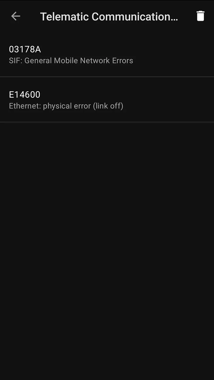

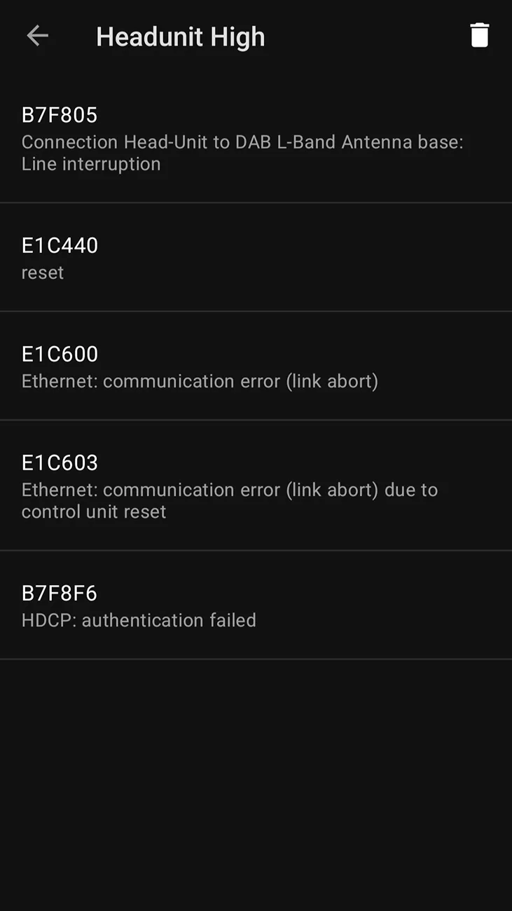

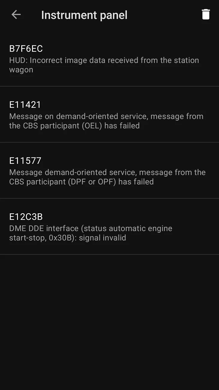

Good news.. I can rule out the battery 😢
So that was £170 wasted; problem still occurs. Looks like I'm going to have to speak to Toyota.. I can see this being a complete sh*t show for me (as the cars fairly heavily modified).
Can anyone tell me, a second hand headunit, I'm assuming this will need to be coded to the car? I'm just thinking that maybe a more cost effective route now, as I cannot see Toyota doing this under warranty and I dread to think how much a new unit would cost.

If you go to an indie shop, they can update just the specific control units with eSys. I'd try that route before letting the dealer update everything with ISTA.
Fair warning - labor cost is going to be high, HU still runs on a HDD and not a SSD, so update time will be incredibly slow.
If you're technically inclined, you could try it yourself, though you'll need to buy a power supply to power every electronic control system in the car.
https://www.supramkv.com/threads/any-interest-in-guide-to-doing-istep-update-yourself.13044/
I'd definitely ask an indie shop who's experienced with esys first.

in terms of licensed/legit software there is a separate Toyota instance of ISTA. If you are interested in performing the update you can purchase a short duration subscription. There’s a thread (here) floating around this forum with fairly good instructions.
@nanaisu covered the other route you could take. I’m not terribly knowledgeable on E-Sys but it‘s important to find someone who knows what they’re doing. There are people who offer this service remotely, but I don’t have firsthand experience (and have general security concerns). I’ve seen a few mentioned on BMW rebuild YouTube channels.
Probably obvious but reflashing the HU isn’t a guaranteed fix; it’s the next step to try before replacing the hardware.
