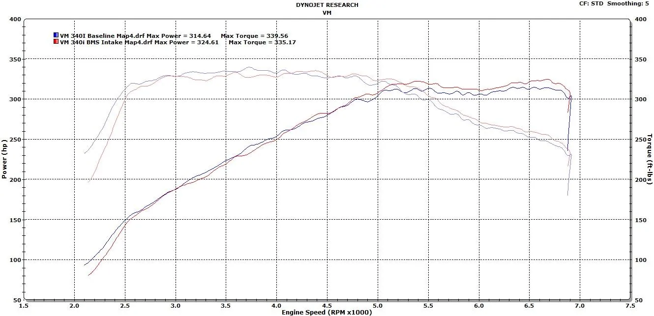

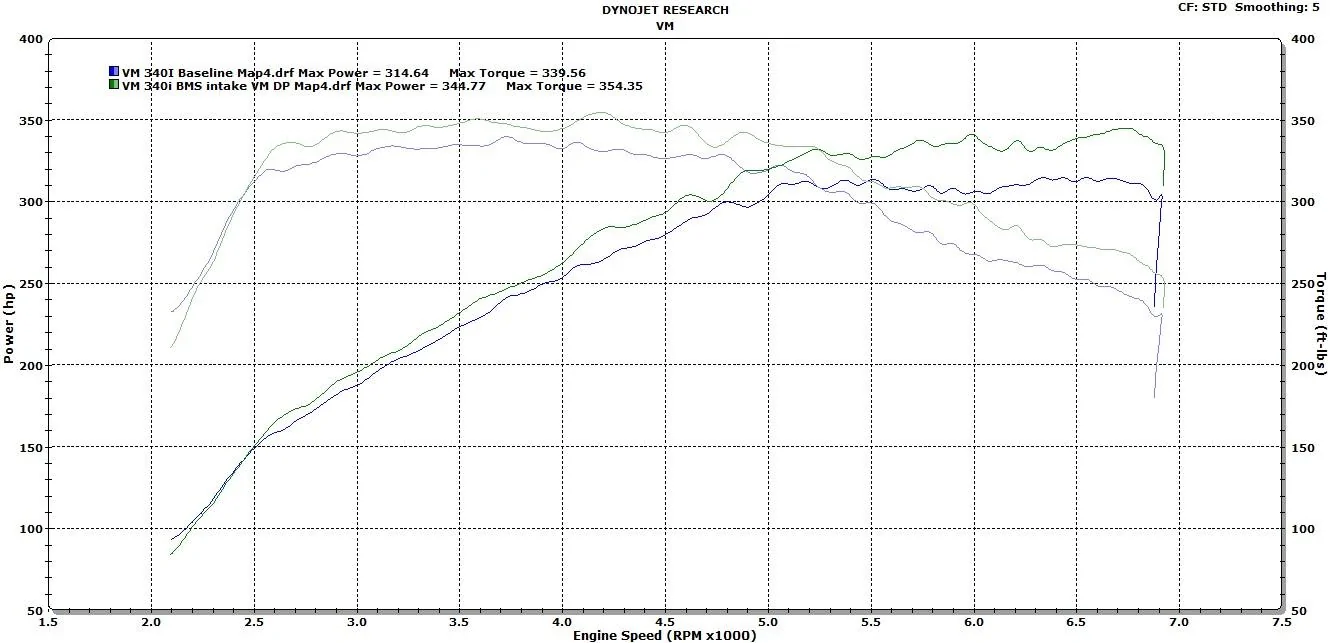

Lots of dynos posted show gains from downpipes even without a tune. here is one with the Jb4 on map4 (turned off). its a 340, same engine, same downpipe.
the intake on its own added 10 whp with the same setup, the downpipe added 20whp
here is a dyno with the intake without the downpipe
What intake and downpipe was this on the 340I? Also what year was this? Thank You
This was when the BMW 340 was first released so probably 2016
the intake was the BMS B58 intake and the downpipe is VM 4" B58 downpipe (no longer offered).
