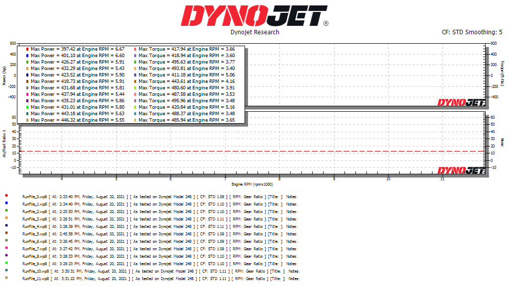

You can expect to get between 390 to 400hp with an e30 blend on a 2021 3.0 Supra with intake and downpipe.
Below is an image of a Dyno run I had today. I have a JB4 with an MST intake, AMS catted dp and magnaflow exhaust on E35 fuel. First 2 pulls are map 0 which is stock setting. The rest are different maps from 3,4 and 5.
Last 2 are a custom map 6 I’m working with @DaBears on (which is not done) and so far had pretty good results. All in all I don’t think I will get anymore out of the JB4 but will see. I’m very happy with what the car is doing with out a real tune to the ECU. I am hoping that the unlocks comes out soon to get the full potential out of these bolt on’s. Hope this helps.
Add meth, you can squeeze out more. I'm floating around E40-E45 with a locked 2021, Meth, JB4 and @DaBears on the tune.
