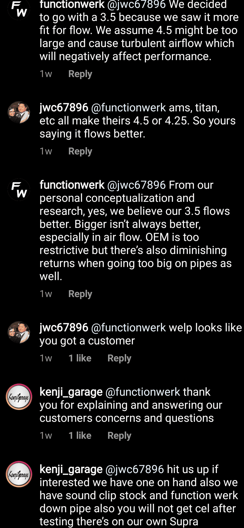

Most other downpipes start off between 4-5" with 4" flex. Not that 3.5 across won't do you good, but fyi... Is a bit pricey for what it is, but not so expensive... Maybe because of the cel delete...
Also spoke to tuners and they said no major gain from a 3.5 to a 4.5. Yes I'm running it on my a91 no issues no cel so far.
