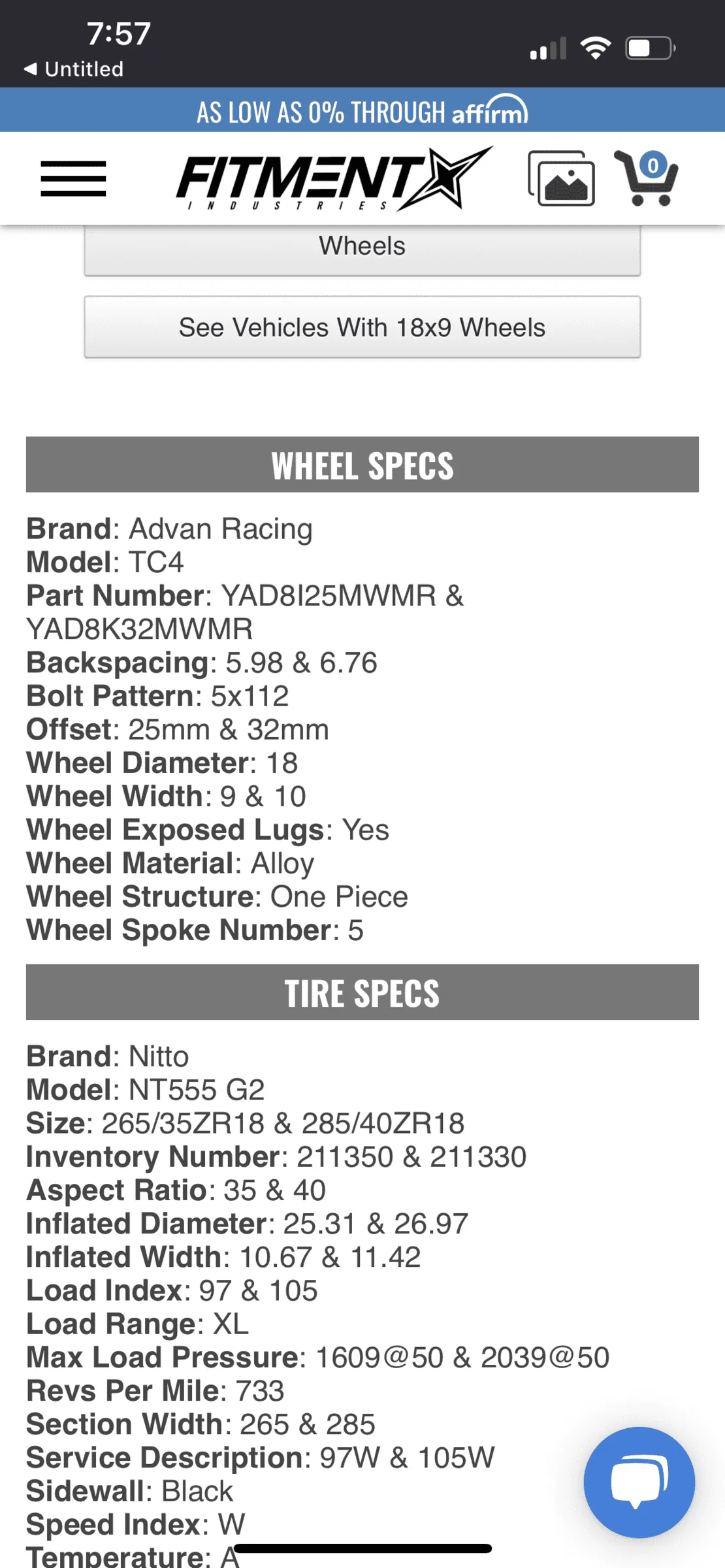

so with these specs everything should fit fine just spacers to be flush? Sorry it’s my first set of time and just want to make sure because I get a warning of “hub bore on the wheel is smaller than on vehicle”. But I’ve seen others with the same size albeit wider but haven’t seen anything about issues on fitment.

If you post a screenshot or link of what your looking at it will be easier. Also if you are spending 2k or more get specs that fit your car. Don’t run a spacer get something that fits the first time.

this is the setup I had laid out. From calculator it’s seems to sit about the same as stock setup

I don’t see a bore size on there at all. Also those offsets look a bit off. You should ask figment industries. Also you can use this website to help you see if your wheels will fit and what the difference will be. https://www.willtheyfit.com/

Yea I’ve been using that calculator and comparing with others and they seem fine but was curious about the bore size warning on the site. Thanks for the help, I’ll wait to see what they’re response is about fitment.

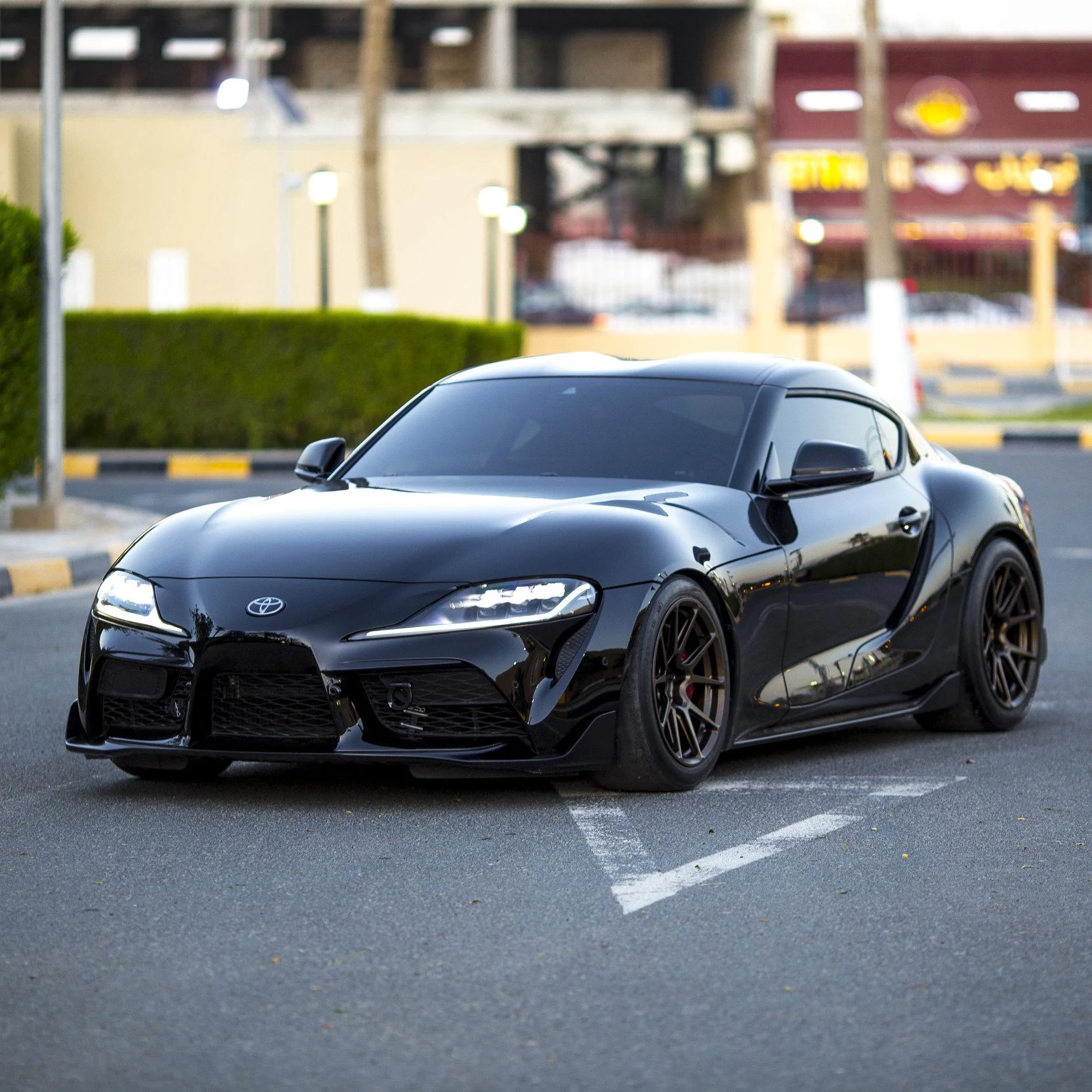

Decided to go with Forgeline staggered setup. Increased the width by 1" (10"F 11"R) since the car had great balance as is. Also 10" is the widest you can go in the front without rubbing on stock suspension perch or fender.
