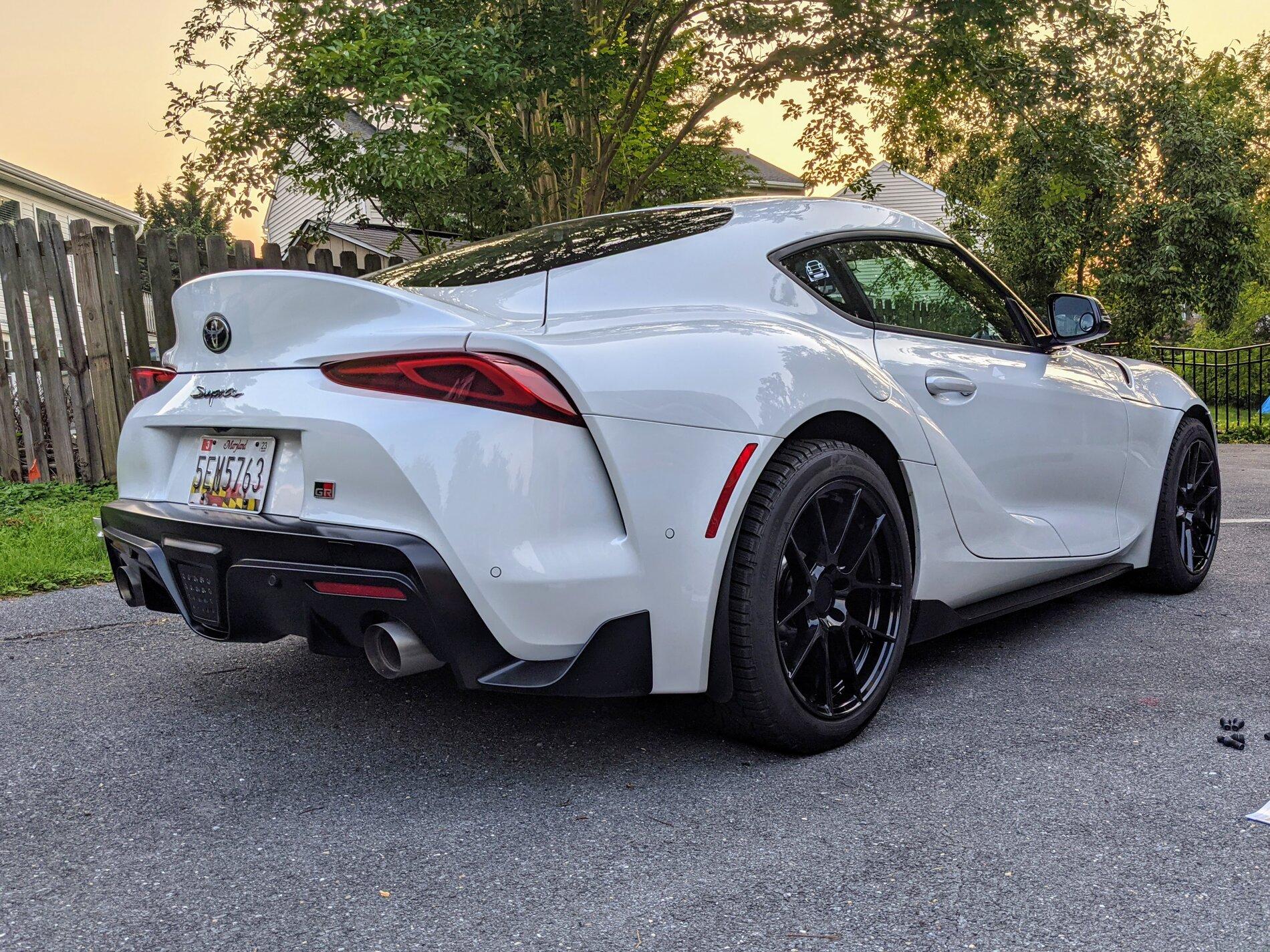

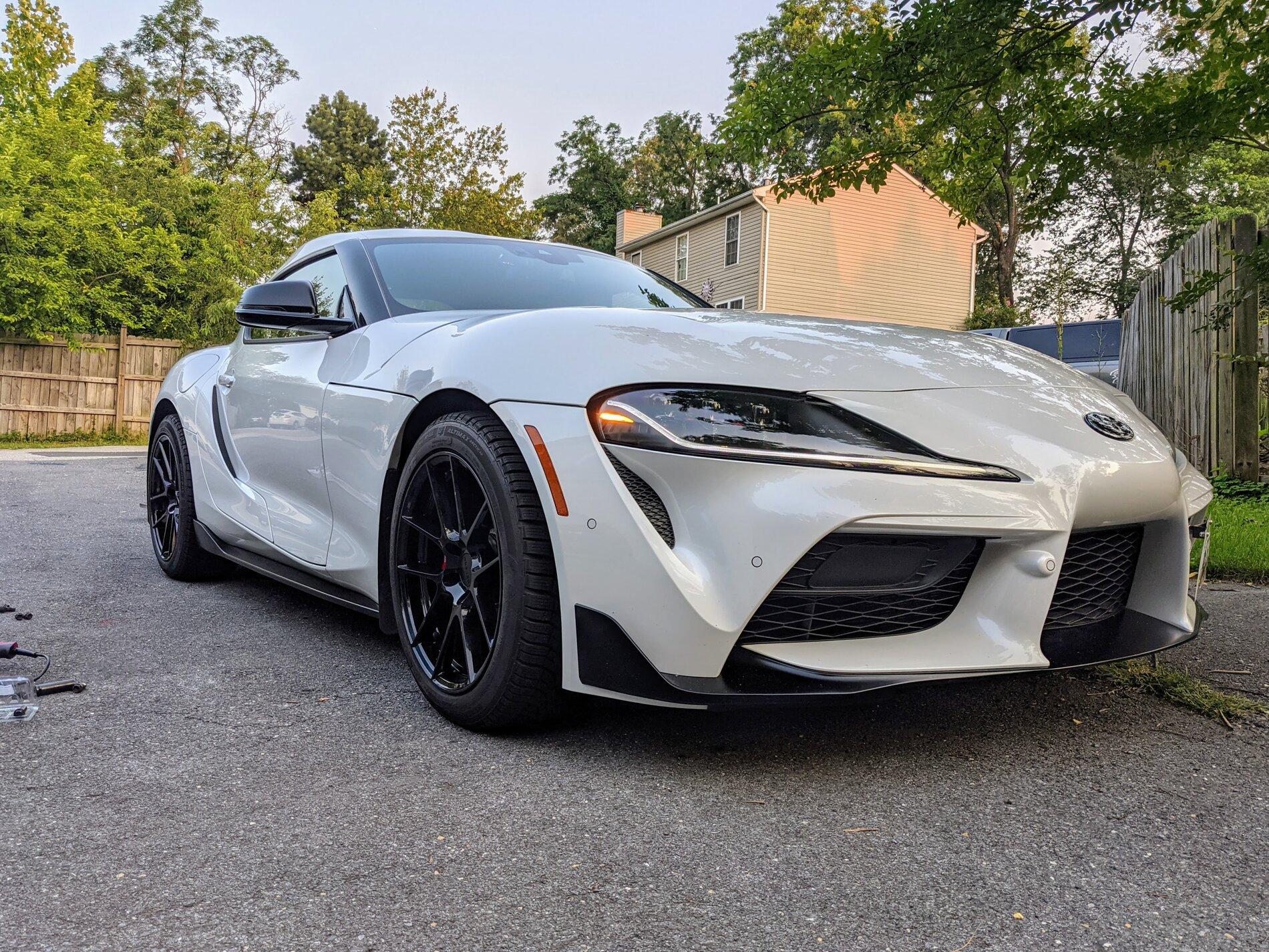

Just picked up a set of 18" Beyern Ritz wrapped in winters from the forum's marketplace. Threw them on just to see what they'd look like while installing spacers on my summer wheels, and honestly I think I might like them better than my powdered OEMs lol. 18s with a bit more sidewall suits this car really well compared to 19s. Definitely considering slapping some all seasons on these and drive them year round, and save my OEM wheels as track wheels.

Hey man, I love my Corolla as much as I love my Supra. I can't fit a Costco run in the Supra, and I need to get my toilet paper home somehow

Looks chunky in a good way, like it's ready to hit the track any given time

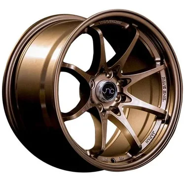

Newbie here. Will be tracking my Supra also. Looking forward to learning from everyone. I ordered a square set of 275/35/ZR18’s made by Federal (595-Pro) to go on 18x9.5 +35mm offset JNC006 wheels for track/autox days. I can't wait to show you them on my 3.0L and compete!

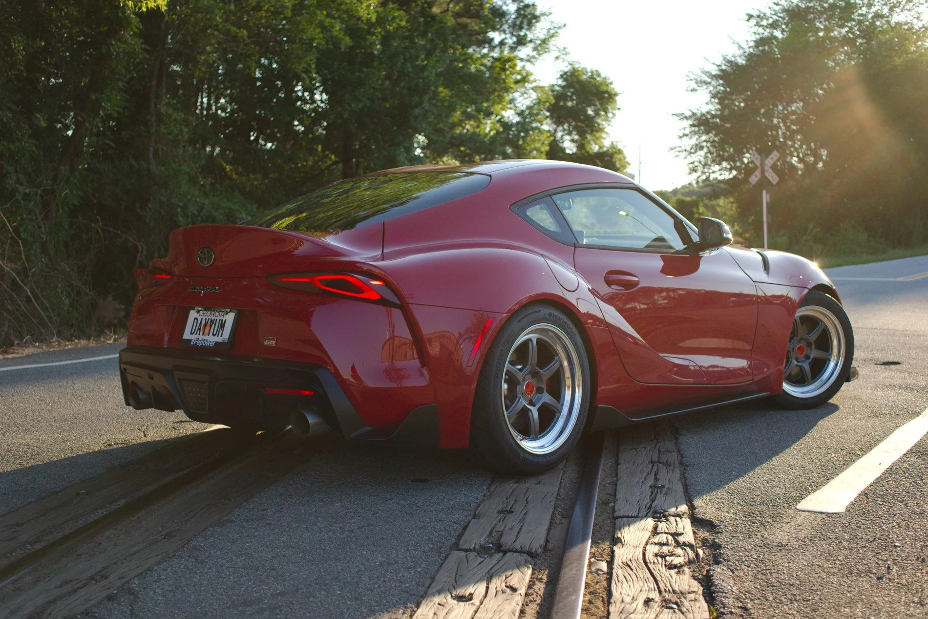

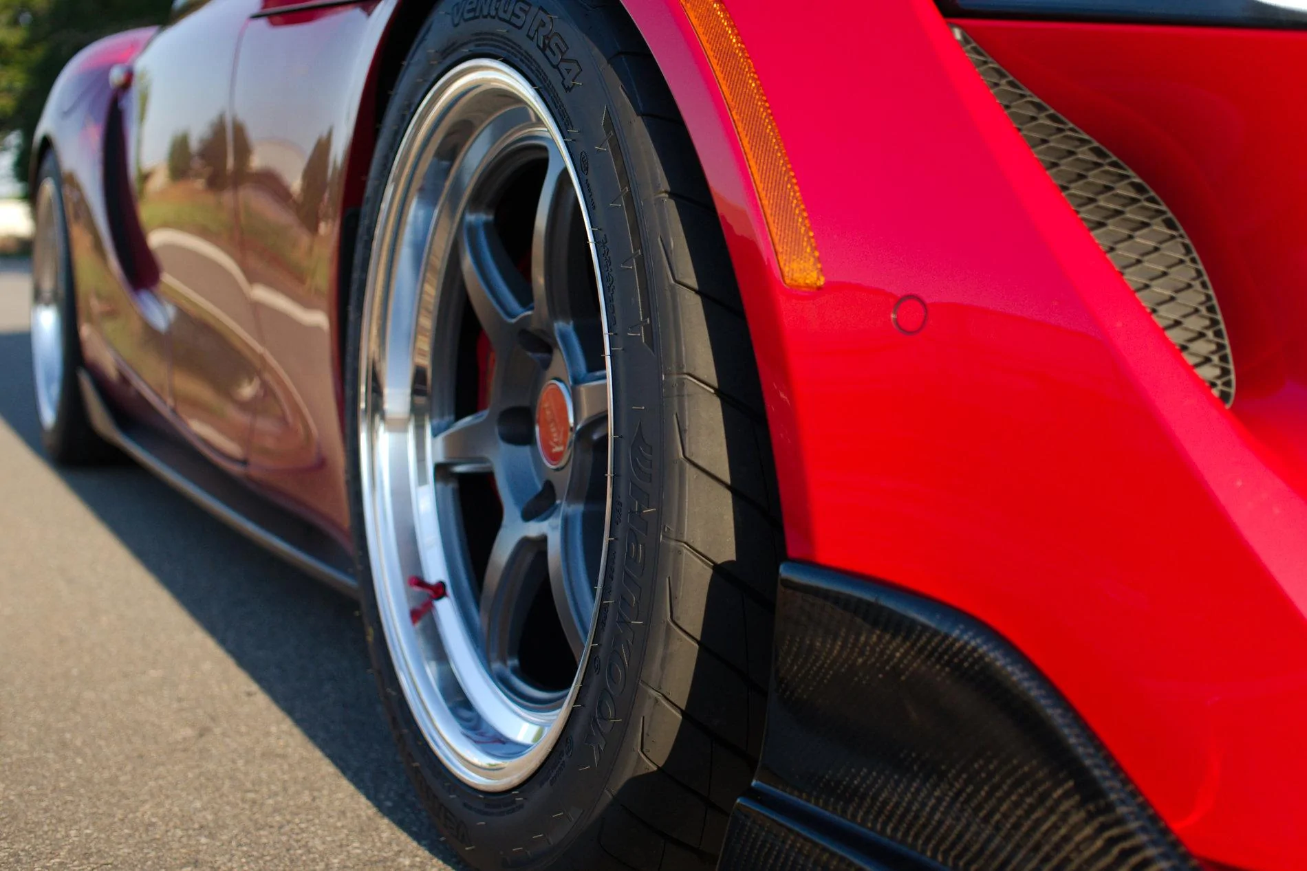

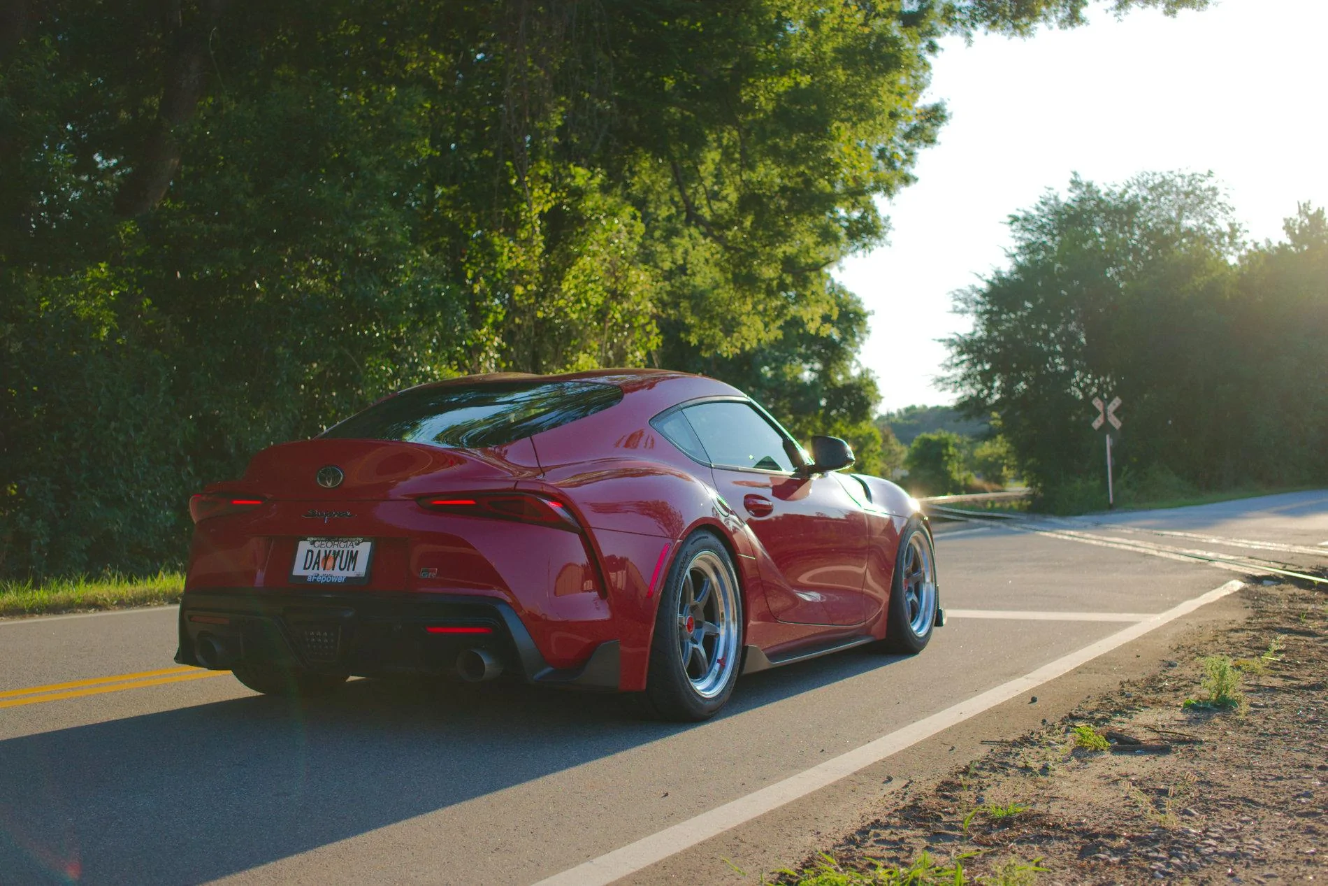

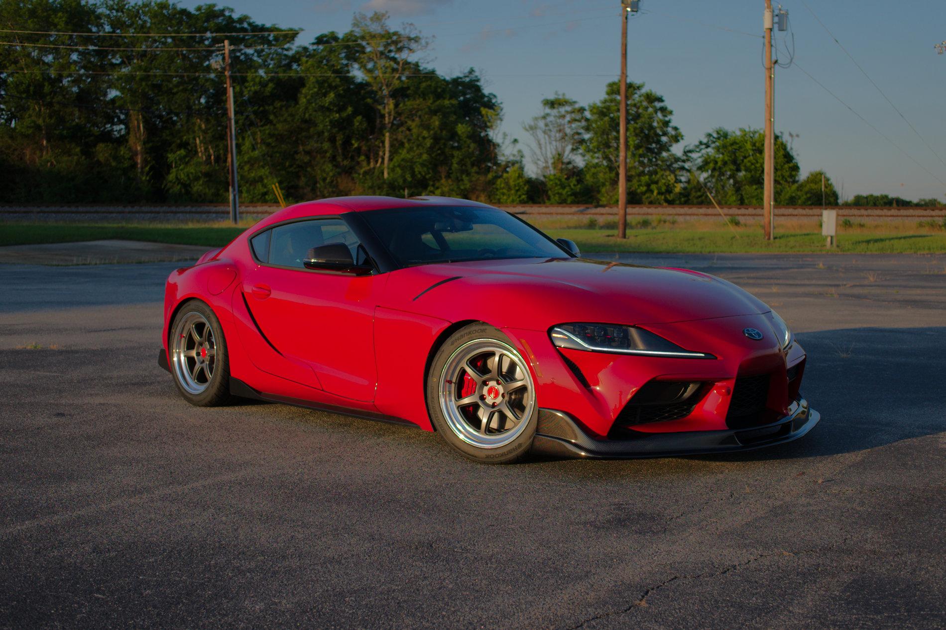

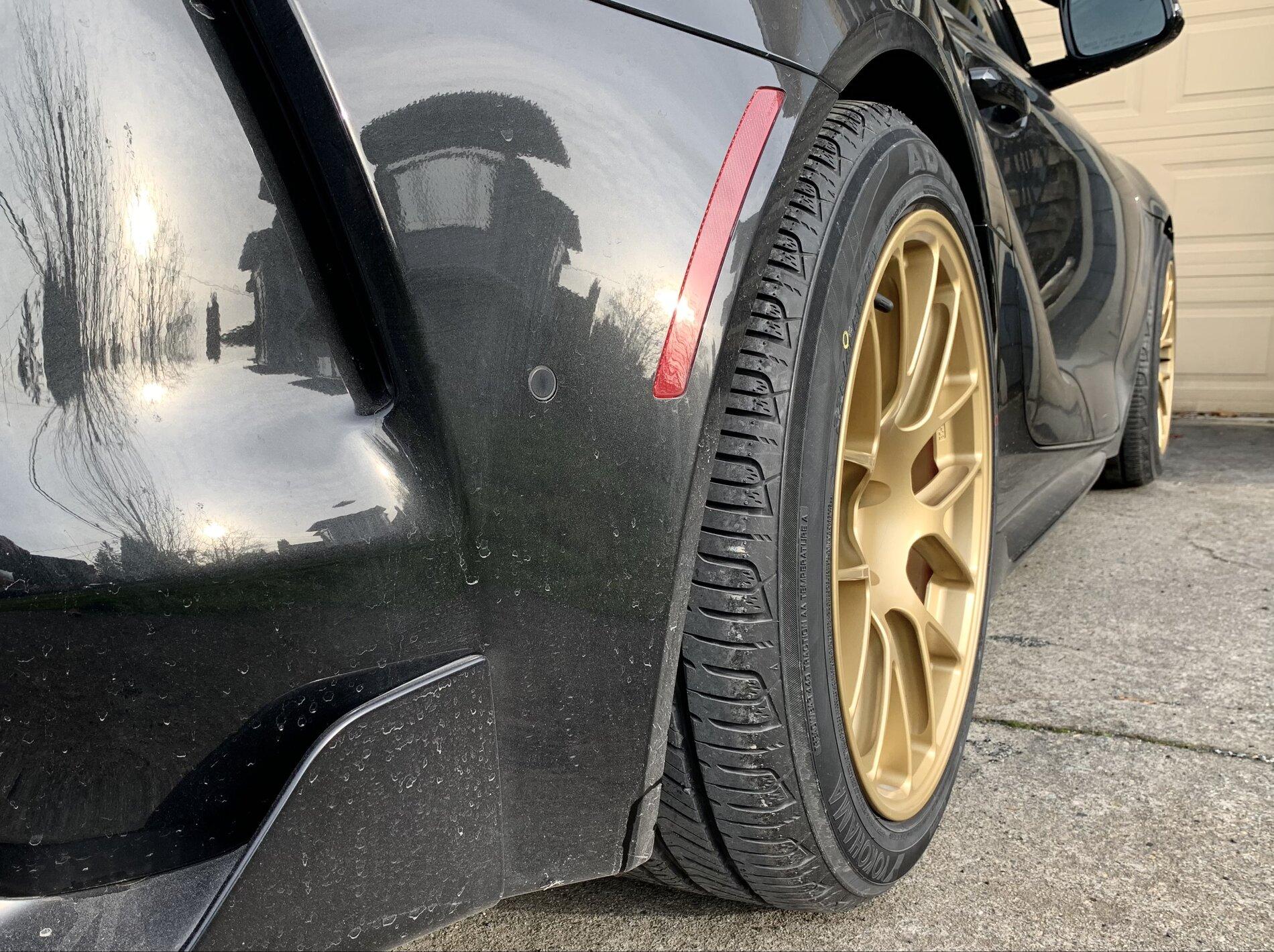

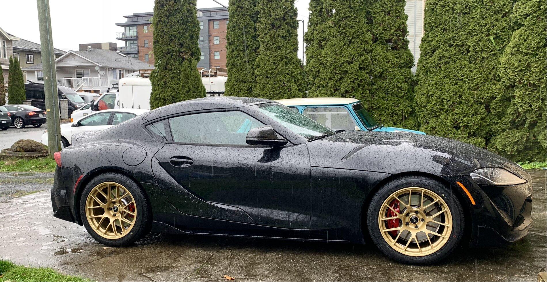

Here's my '21 Supra with a square 18 x 10.5" Apex EC-7R (+13/15mm spacers) setup and new 275/18/40 Yoko all-seasons. I had the A052s on until the weather turned for the worse; we get a ton of standing water here and the A052S are as bad as you'd expect - this is much better. It's also on Ă–hlins Road & Tracks and is sitting a touch lower than stock, but not much.
Apex Wheels
Oct 15, 2020
31
375
351
GR Supra Sponsor
Man those wheels look good. I love this gold finish. We only have one set left of these wheels and I kind of don't want to sell them. I want to hoard them for myself. :oops:
