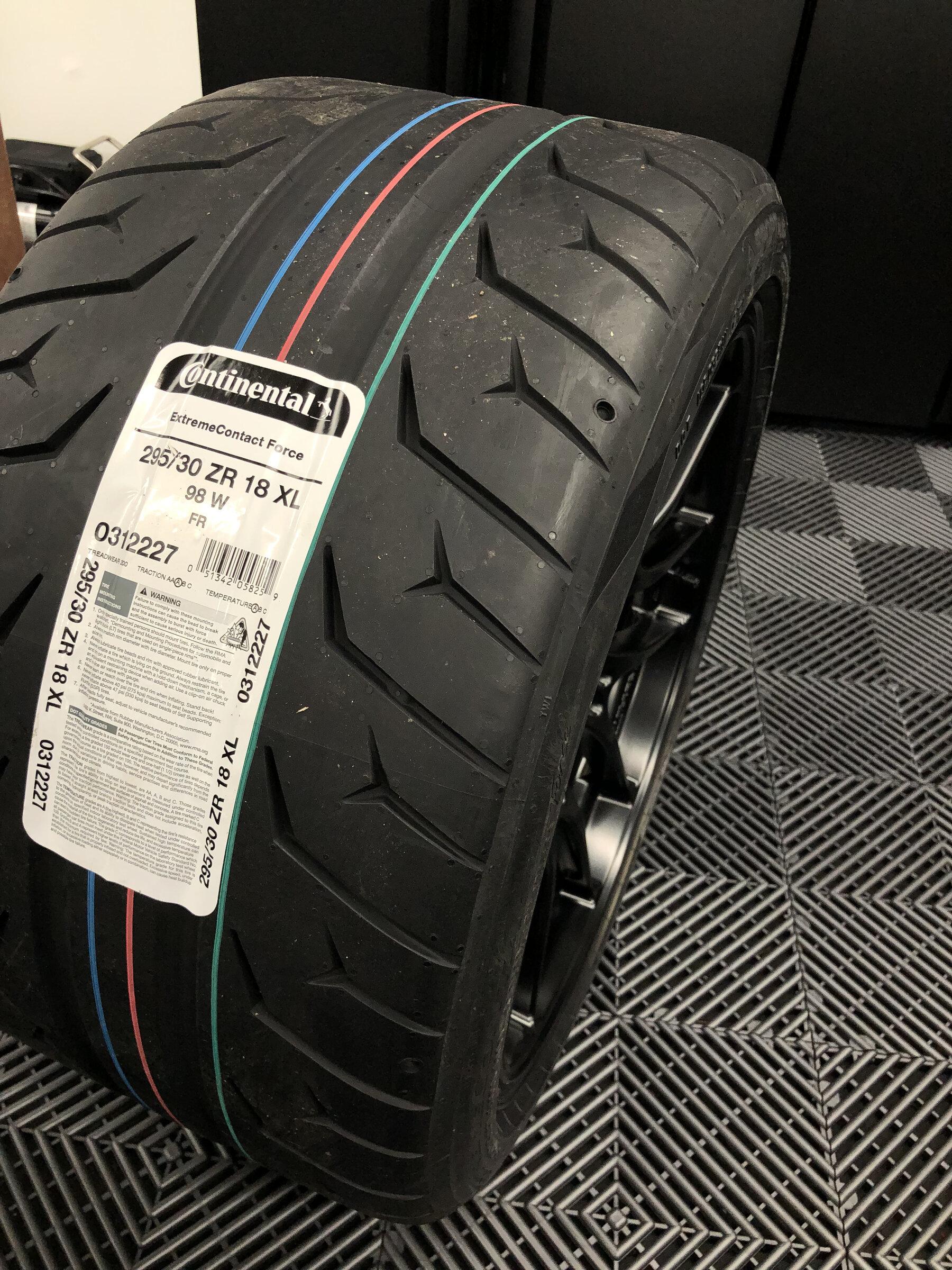

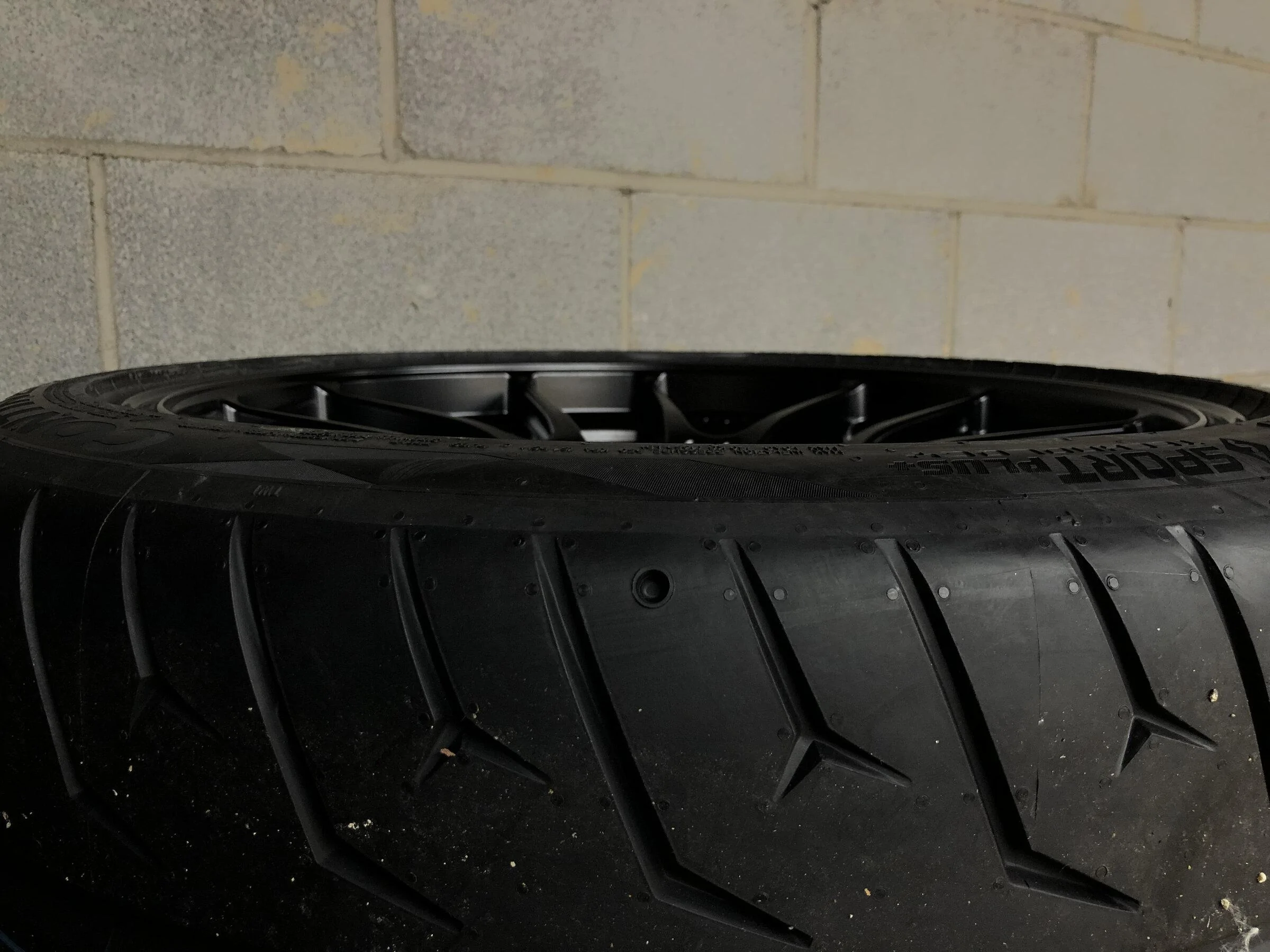

For more reference, this is what my 295/30/18 Conti Force tires look like on 18x10.5 GTC02.
Your mileage might very depending on the tire you are going to be using.

Sheeshhh that look like a beast of a wheel I can’t wait !!!

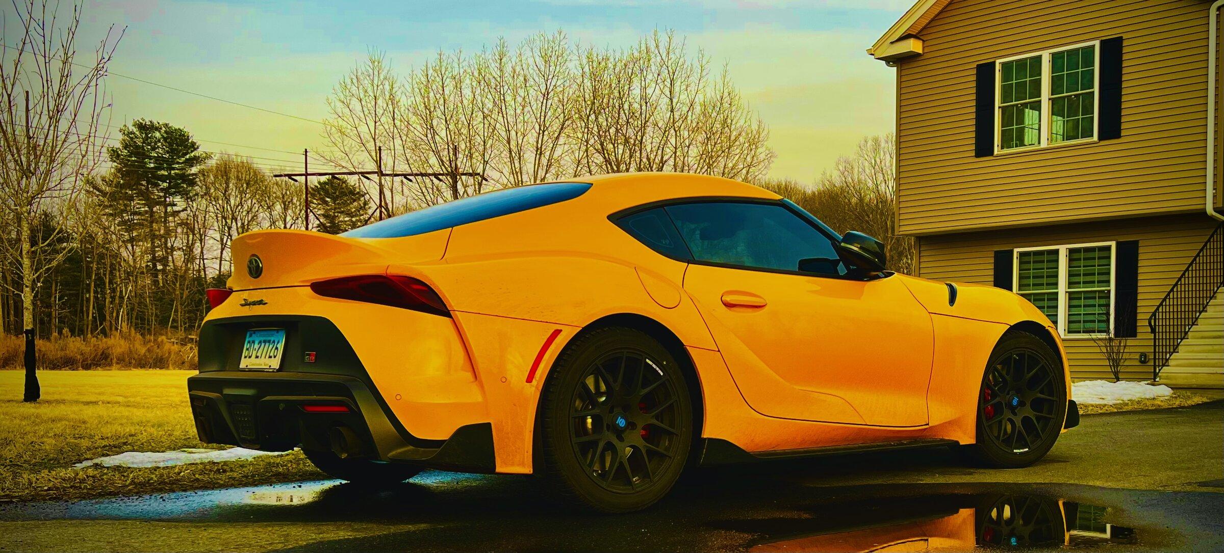

I don't know if anyone noticed.. speed on speedometer is dependent on Overall Diameter of tire. Goal is to match the OD as close to OEM tires as much as possible and that is greatly effected by profile size (30, 35, 40, etc). It is also effected by construction of the tire as well. OD can be looked up by searching on internet for most of the tires.
Having said that, if you are using different tire than what car came with, speed on car's speedometer can offset and my previous cars stayed that way for obvious reason. On GR Supra, as you may know, I'm using 285/35-18 Pirelli P Zero tires which is smaller OD than OEM. Meaning, when my speedometer reads 65mph, it's actually 61 ish.. this was determined by driving on highway with Waze App turned on which showed the speed based on GPS. So far, all this was expected. However, what I didn't expect was, on return trip, speed on speedometer and Waze were very close at marginal 1~2% instead of 3~5% difference I had when tire was mounted first time.
So it looks like GR Supra has ability to adjust its speedometer based on telemetry it's reading. whether this is reflected on odometer is unknown though..

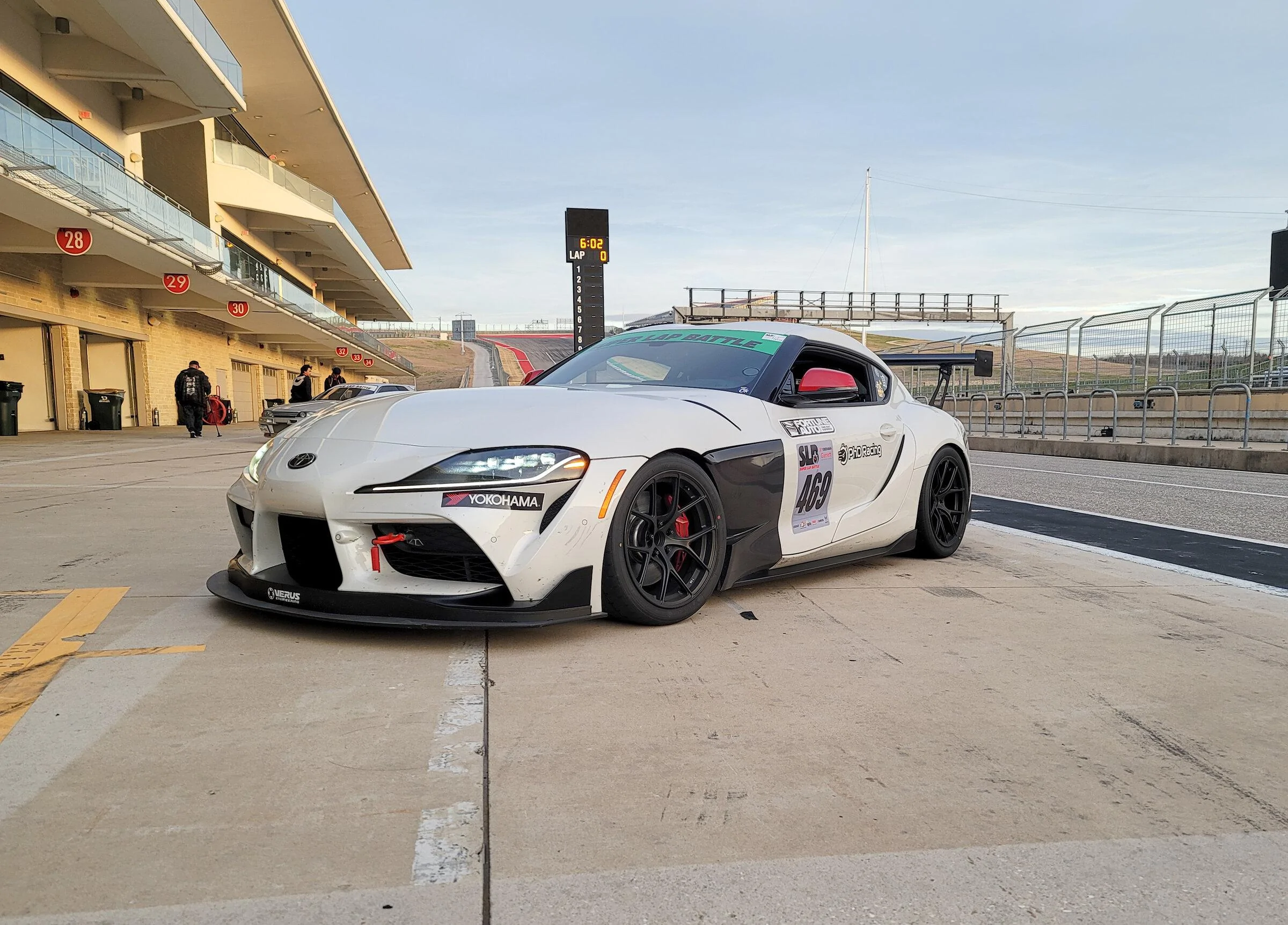

Track setup - Titan7 D6 18x10.7 +38 - Toyo R888Rs - 275/35 square
18mm spacer required up front to clear suspension
Suspension completely stock in this photo

I had these tires as my track setup for my Camaro and they were crazy noisy. It almost sounded like I had straight cut gears. Are they any quieter on the Supra?
Aside from the roar, I absolutely loved the tires on the track.
