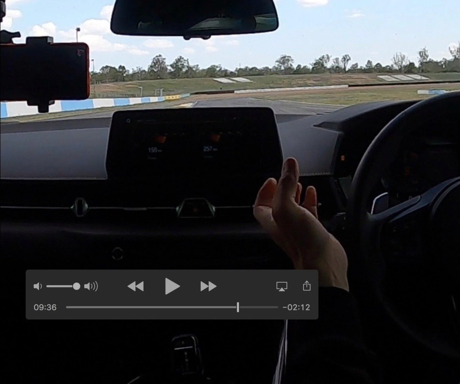

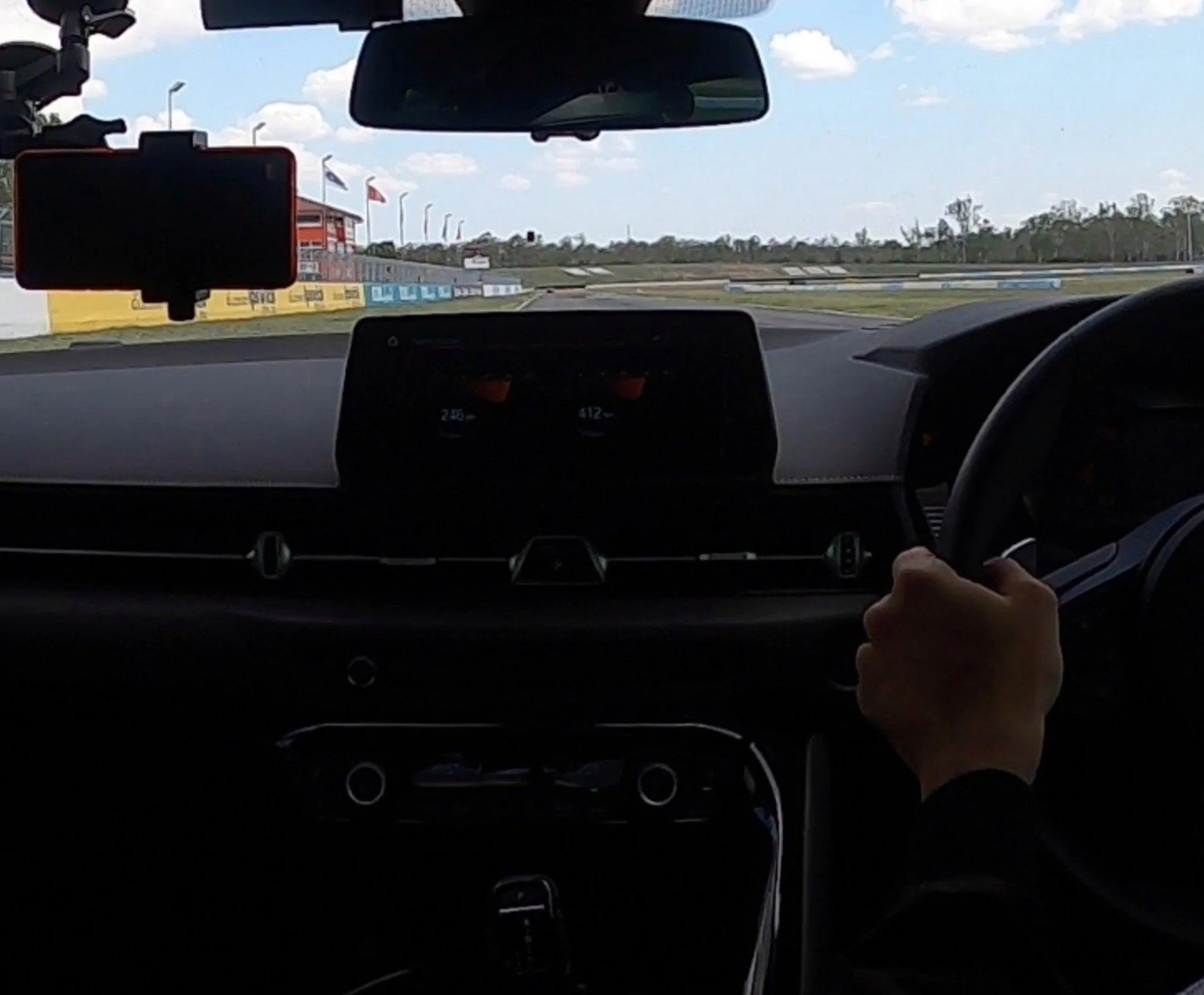

Just for reference, here's the power "sport display", showing 246kw/412nm when it was working fine, then shortly after, while still at full throttle, showing 146kw/257nm and feeling like it was NA..
