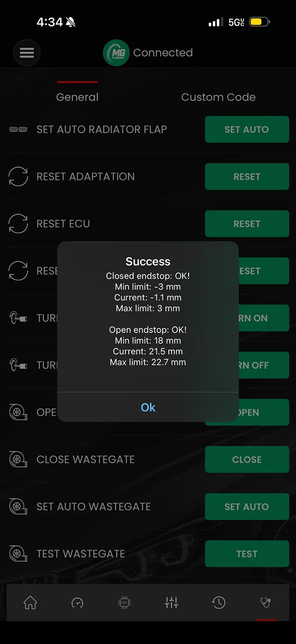

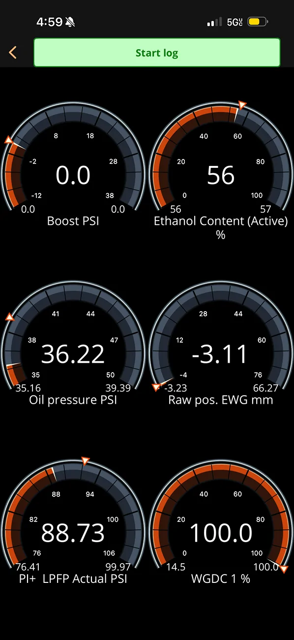

Alright kind of going crazy trying to figure out if I have a boost leak.Tried doing some logs after installing the DAW FloxMax.Making 19PSI on 90% duty cycle.Yesterday did a smoke test with 10PSi and intake was fine,PI Rings and charge pipe were fine.Kind of going crazy rn.Car was fine on stock turbo

It's actually hitting 23psi at 92 WGDC, then drops. Boost tuning needs some love but that WGDC does seem a bit high for the boost level. Did you carry over your WGA and make sure it didn't accidentally get turned? I would also log WGA position.

Yeah I carried it over.Im currently taking everything off everything making sure all the seals and O rings are good to triple check myself.Im guessing its the WGA.Once I put everything back on im going to take a couple more logs

Kinda lost on what to do.
WG seems to be fine.
Could it be the daw?
Thraxbert
Robert
May 3, 2021
1,391
2,372
Make your WG arm 2.2±0.2mm shorter.
