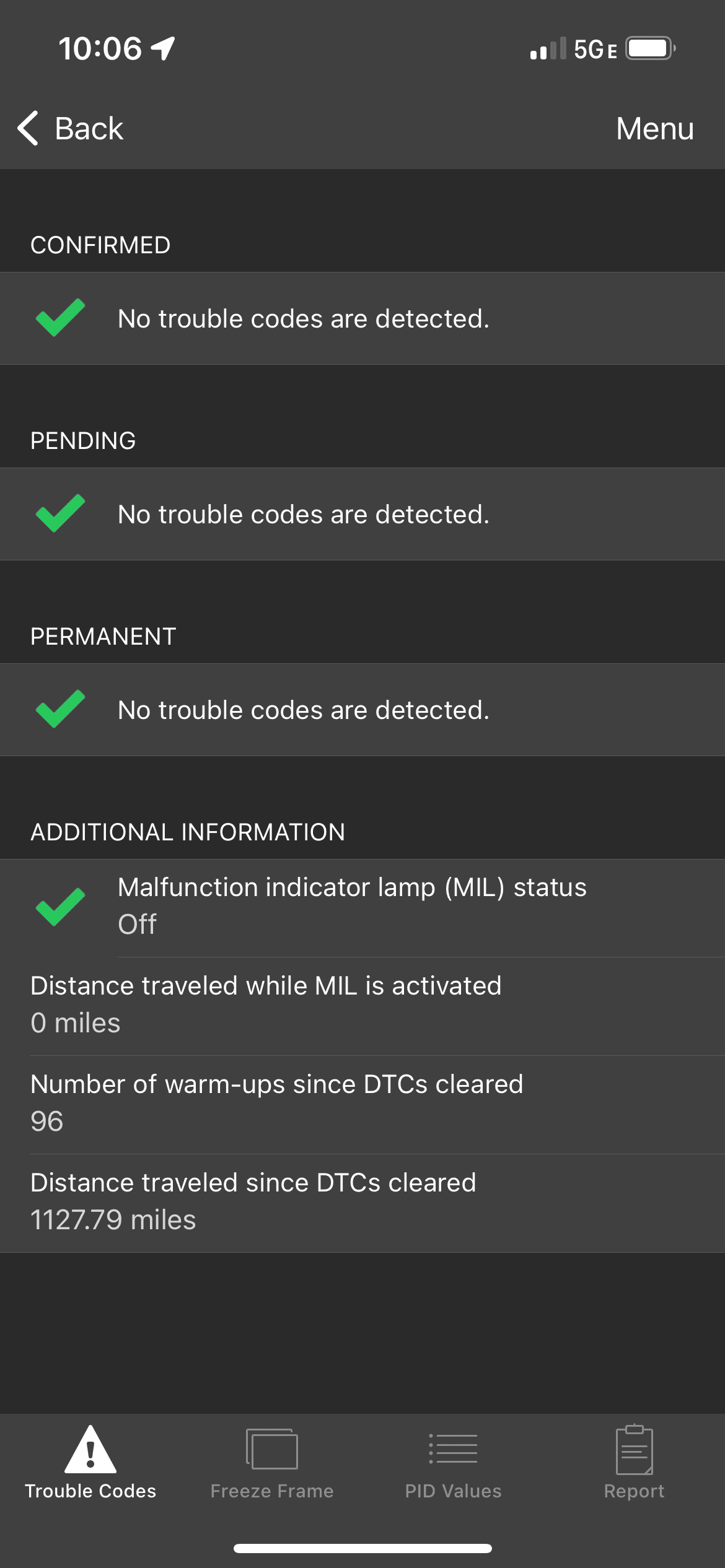

Last weekend I installed the EOS manifold, got it all buttoned up, went for a drive, and was only making 3 psi. I figured it was a boost leak, in pulling the manifold back off I found that the FTP charge pipe was ovaled from over-tightening the clamp. This weekend I replaced the charge pipe, did my best not to over-tighten the clamp, went out for a drive, and the car is still only making 3 psi.
This time I decided to take a log though, and it appears the car is only making 3 psi because it's only targeting 3 psi.
What would cause the car to drop the boost target to basically zero? There is no CEL, no DTCs, nothing appears to be out of the ordinary other than the low boost target.
