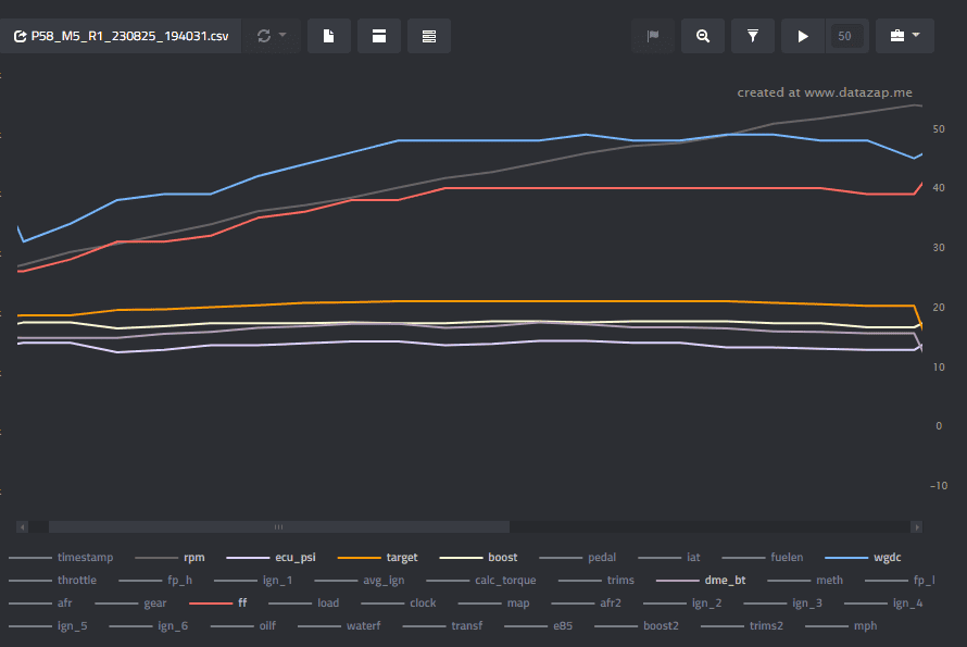

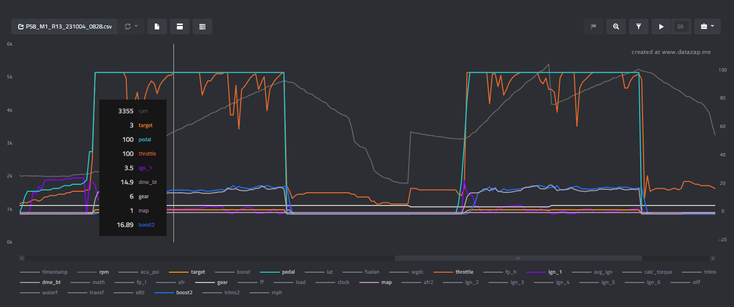

Why don't your boost targets in the log match your Map 6 settings? (shown below)
map6_15map6_20map6_25map6_30map6_35map6_40map6_45map6_50map6_55map6_60map6_65map6_70
14​
14​
15.1​
19​
19​
19​
19​
19​
19​
19​
19​
19​
These won't work anyway. you need to taper boost targets on either end.

Ah, I was trying to force the jb4 to start a new log grouping by changing settings, but it wouldn't let me and kept throwing everything into the same CSV. Is there a way to do that manually? I suppose I could just delete the existing CSV.
I thought I was going nuts, the boost kept tapering no matter what I did with duty bias at the high end (that's why the bias is a crazy value at redline, something like 65). Maybe a new downpipe will help VolEff at the top end?

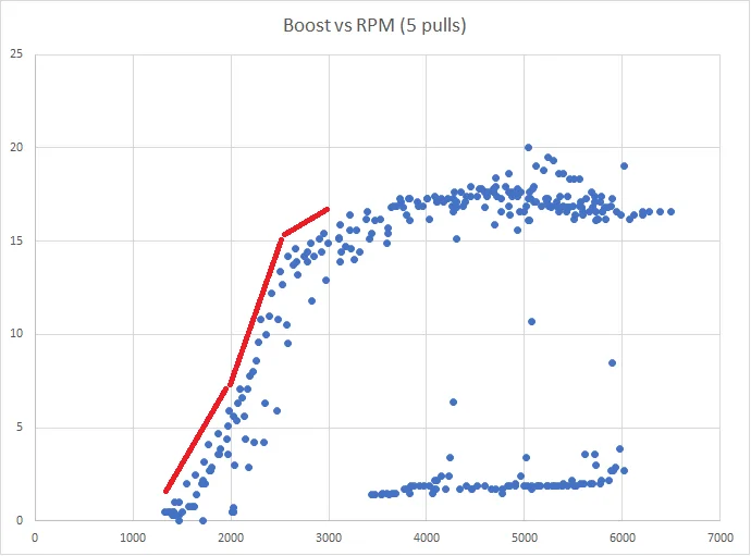

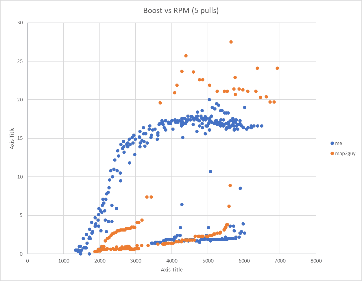

After your suggestion i looked more closely at my logs on my desktop. I now see the turbo is only capable of generating 15 psi at 3000 during my 4th gear pulls. that request of 18/19 psi at 3000 is probably contributing some wonky behavior too.
Using the upper-bound of this 5-pull scatter plot, I wonder if something like this would minimize PID windup.
481617
I honestly don't pay much attention to any of the values below 3000 since you should rarely go WOT there anyway. I would recommend just putting whatever DME_BT reads for any RPM below 3000 to run stock targets. To make it a passthrough basically. Your log suggests that value is about 14-15 psi.

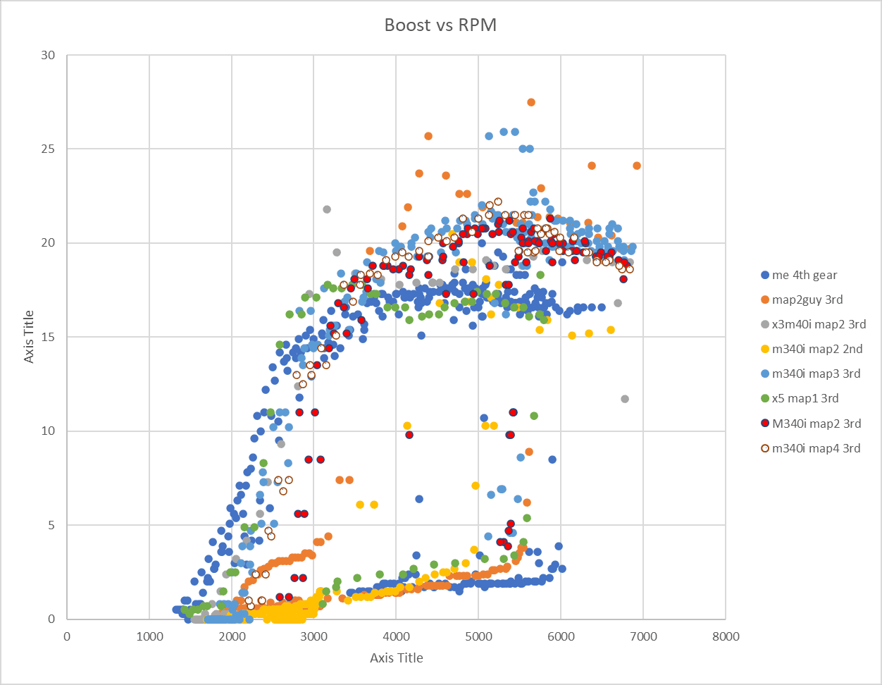

Merged a bunch of logs from here as well as jb4 forums. Boost thresholds seem to be +/-500 rpm even though everyone seems to be using 3rd and has an automatic (2 quick upshifts upon lift gives it away). I'm guessing it's probably software-related rather than gearing, assuming zf8's aren't drastically different from car to car.
One fellow with an m340 (yellow dots) found out that in 2nd gear the engine outruns the turbo and it doesn't spool up until 4500. But on the other hand, it looks like his transient had a maximum spoolup time of about ~5 timesteps from 5psi to max boost.
Pretty fascinating scatterplot. Thanks for sharing.
