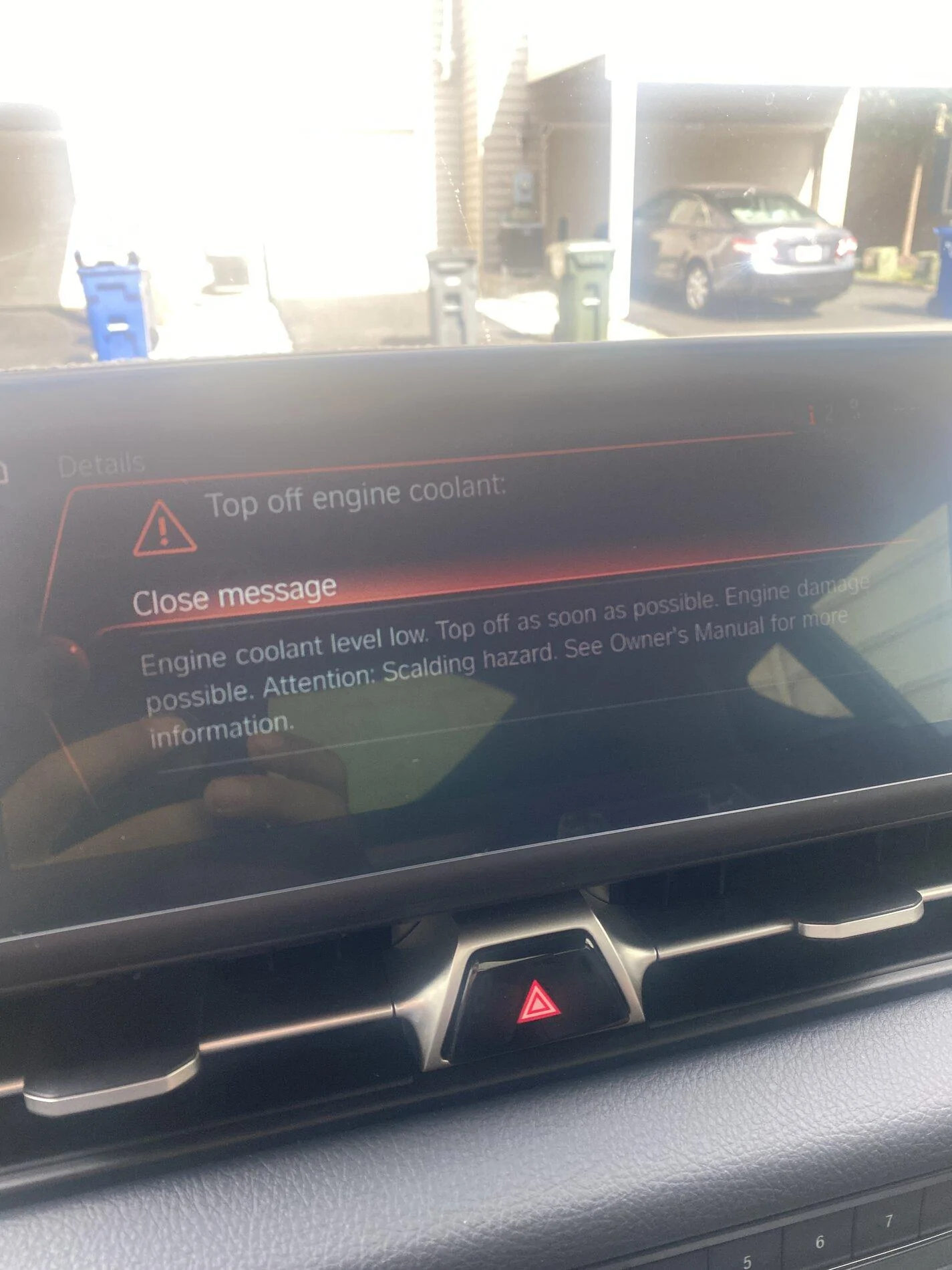

Got this warning right st start up
Car has 4k miles. No leaks or white smoke…
checked the big coolant bottle was nearly empty.

Thats the plan. Hoping it just had an air pocket ?

I had this happen too. Mine appears to be evaporating around the seals of the sensors and caps on the reservoir. Had the system pressure tested last month and inspected by a shop but they said it was all as should be. Just watching levels and filling it up as needed

Have you had to refill more than once?

No. Only filled once in about 10k miles. The link below looks pretty spot on with it being the caps. I’m going to purchase some new ones and see if that fixes that. I wonder if putting something on the threads might help temporarily to seal a little better.

Yeah, it appears to be a common issue on the B58's. But on mine, I had to REMOVE coolant as it was completely overfilled.. like the level indicator has at the bottom of the ocean deep.
When I did the Ti bleeder I had to towel catch like a full cup of coolant.. completely cold engine.. and it's still high. :crazy:

I just had this happen last night. I added the Ti bleeder a few weeks ago and figured I just didn't tighten it quite enough - going from plastic with phillips head to Ti with allen wrench, I was a little hesitant to put too much torque on it and strip the threads.
Looked it over in bright sunlight today and can't see anywhere that is obvious as far as any leaks.
I'm not too concerned considering I've got just over 26K miles and haven't checked it in over a year (doh!). Only had to add about 20oz of distilled to completely fill so despite being below "low" on the little marker, the reservoir wasn't completely empty thankfully. ?
Even wiped everything down with a white towel to see if I could detect residue on the side of the reservoir and surrounding areas... nothing there so must have just been a very slow push-out that was evaporating almost as fast as it was weeping.
Now I'll be more religious in checking it at least once every month or two.

I just did my bleeder screw today... nothing came out when i removed my stock one, it just depressurized... i'm gonna check my coolant now. ?

Had this happen to me this morning at 20k miles. The Toyota dealer was nearby work so I drove there first. They topped the coolant off and said the found no leaks.

Unless you're smelling burnt coolant after a drive, I wouldn't worry.. it's a typical thing I maintain on all my cars. Even a few months ago on my daily drivers they both needed some coolant added.. and no leaks on those cars either. I recommend just checking it every 5-6 months or when you do an oil change.
