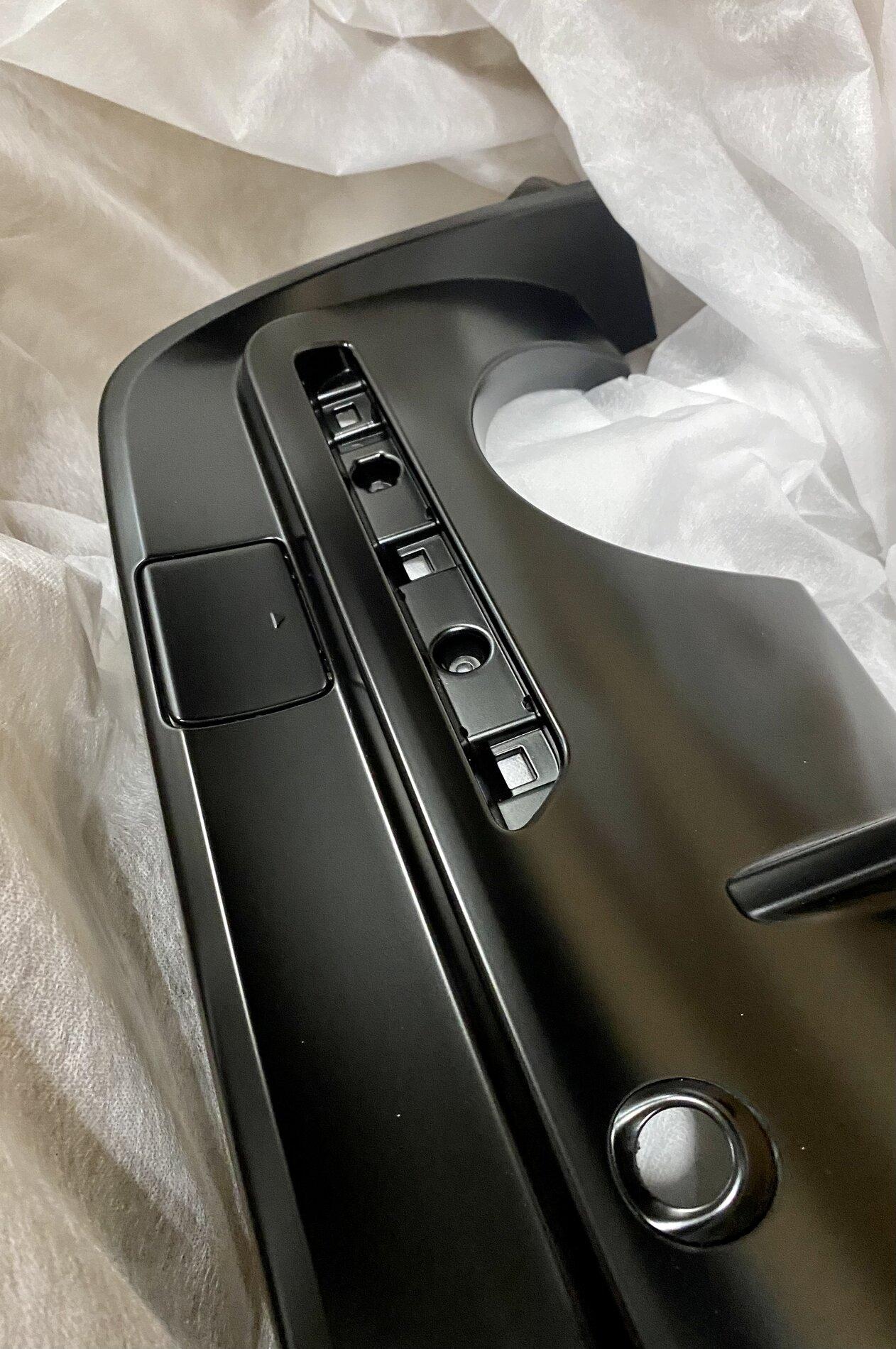

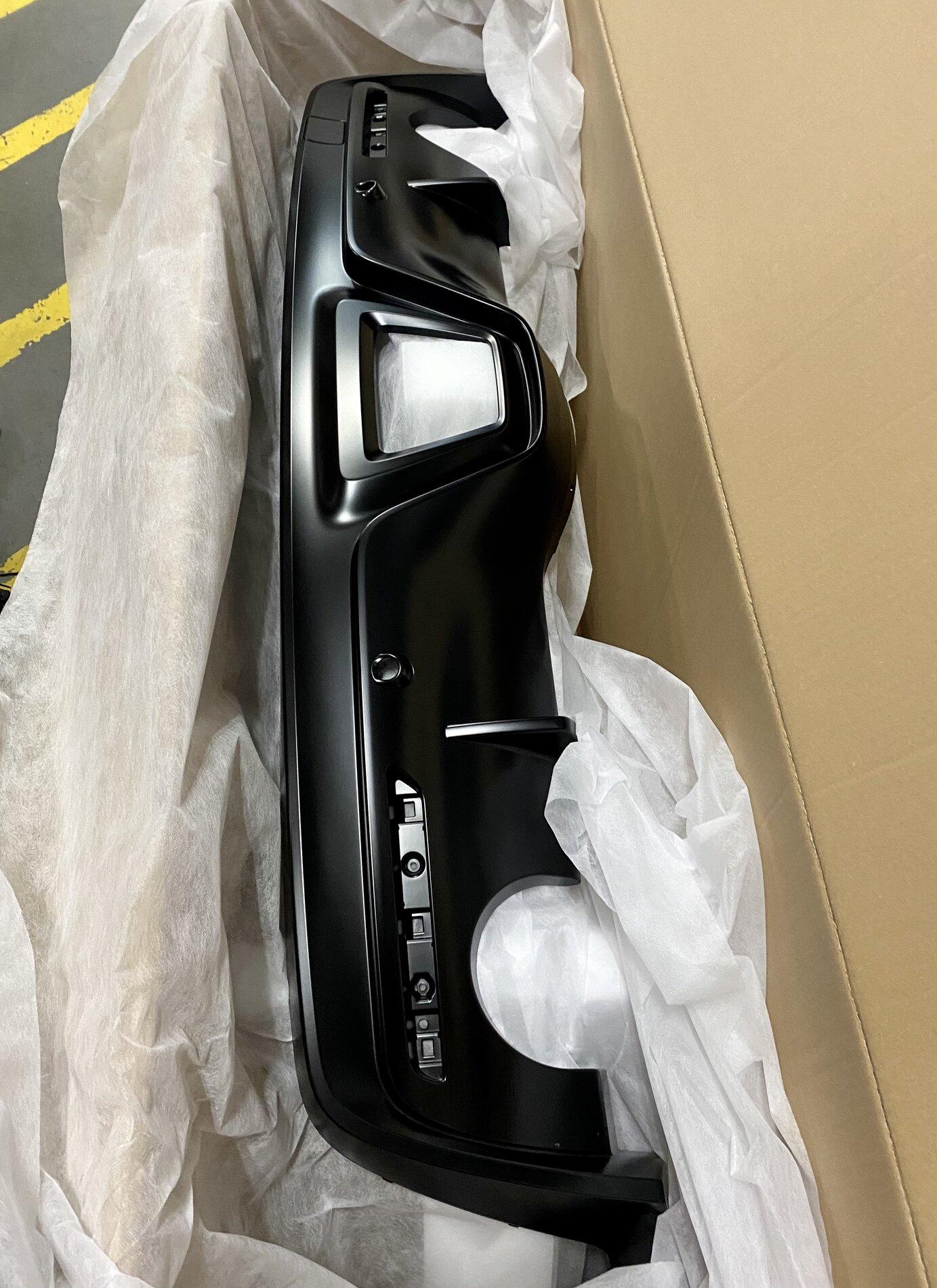

Does this part come "painted" or is it molded plastic?
Idiot rear ended me yesterday (VERY minor, but bolt from her license plate dented) Need to replace.
~ Yes it does come painted in the factory satin matte black. I saw one in person at my local dealers parts dept and took a few photos.
See below.

Shit yup-- you're right. The satin pieces come satin. It's early, and I was thinking about color matching body panels.

Yup, comes black already. I replaced mine already due to a hairline scratch.. ? the price isn't bad neither, for what it is, it's on the inexpensive side.. BUUUT just a warning now, you have to remove the whole rear bumper to replace it... and removing the rear bumper kinda sucks lol.

Did you replace the lower bumper cover yourself, or did you have the dealer install it? Also, did you have to reprogram the two sensors in the rear bumper? The bumper itself is very reasonably priced (almost like a disposable item), but if you had someone else do it, how much did they charge? Thanks for your help.

I did everything myself. Just unplug what needs to be unplugged to remove the bumper and to take it away from the car.. no reprogramming needed, everything worked fine for me, idk what i did if people have issues with their sensors needing to be reprogrammed but i didn't need any of that. Lol

How do you remove the rear diffuser? Did you have to take off the whole rear? Or just the black diffuser

You have to remove the whole rear bumper, which is ridiculously easy compared to a lot of other cars. There are a couple youtube videos explaining how. Takes about 15 min. Once off, you can just pull the plugs on the sensors, and then remove the lower piece and replace.
