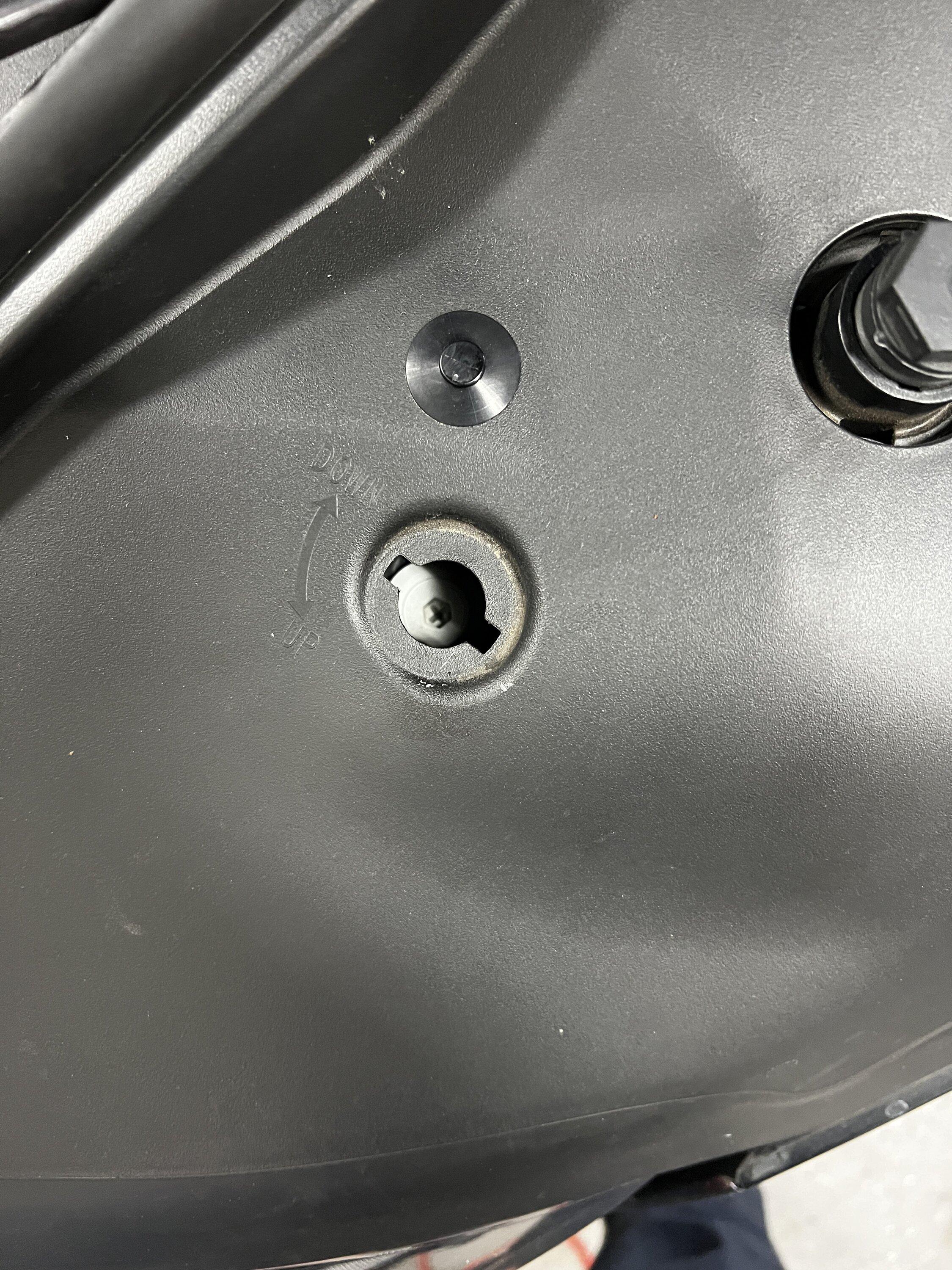

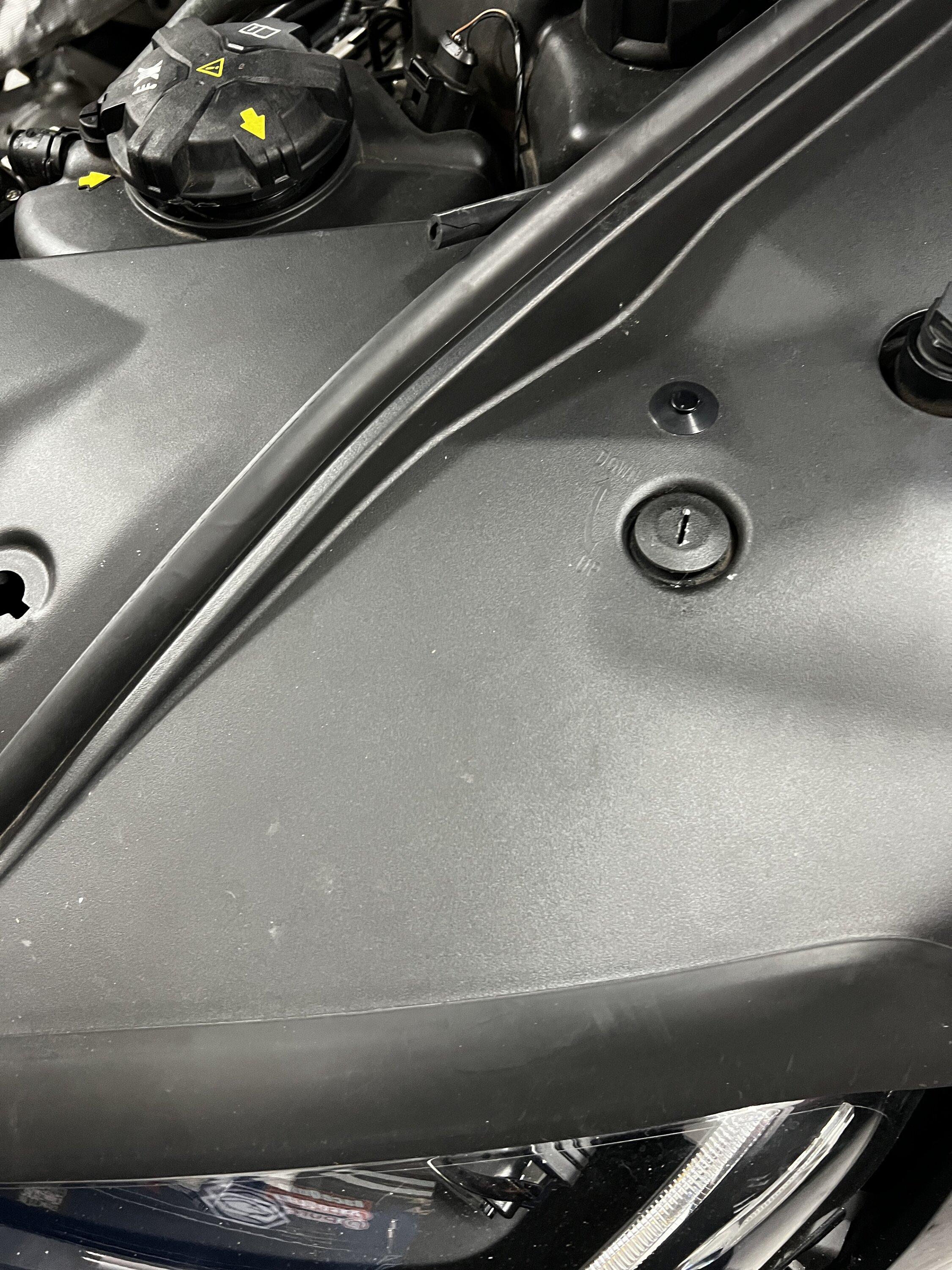

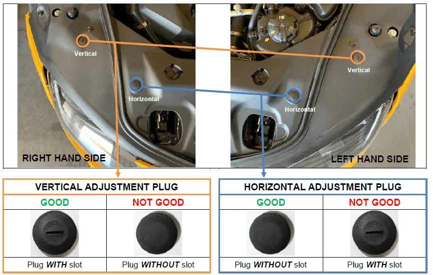

If you had to do this "recall" you'd have known about it, like I did, lol.
Anyhow, vertical/horizontal:
