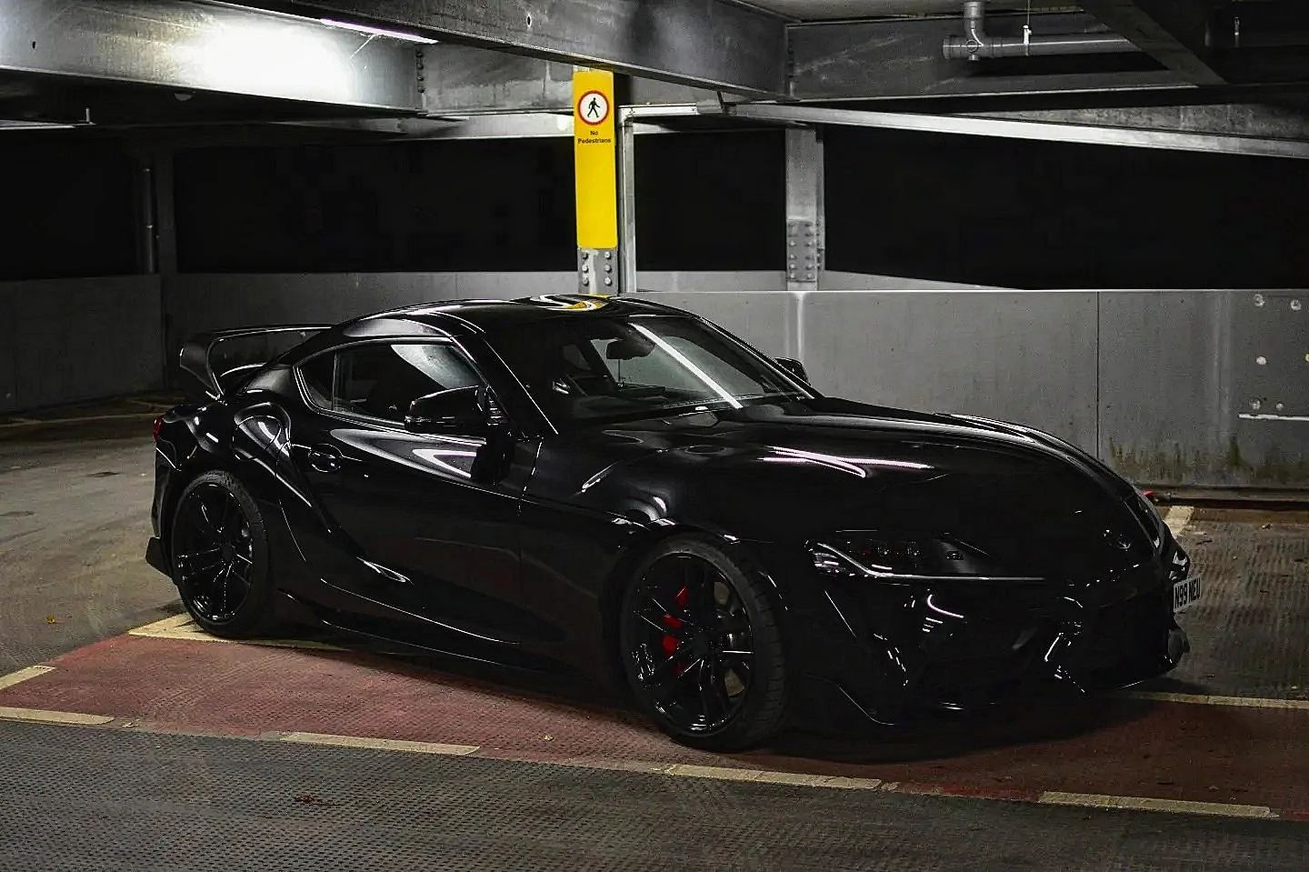

I've had the Eibach Pro-Kit Springs fitted for about a year now, and generally, they're fine and shouldn't cause you any problems.
The problems come if you add a large front splitter.
I recently fitted the Maxton Street Pro front splitter. and now find that I need to take it super slow and at an angle over some speed bumps. I've also had minor scraping in multi-story car parks and on some really uneven roads.
I had the Maxton V2 splitter fitted before this one and it wasn't as much of an issue.
The Street pro one looks 10x better though, so swings and roundabouts!
