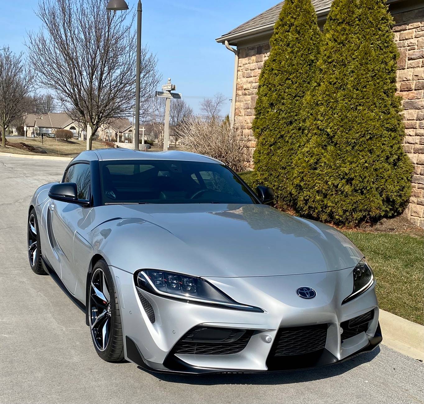

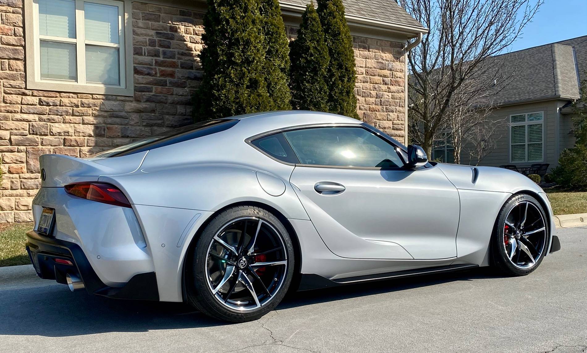

Andrew4Supra
Andrew
Jan 20, 2021
100
2,014
3,561
Powell, Ohio
I have the same set up but with 10/13mm spacers. A clean look without being slammed. No issues with rubbing or scraping.

Andrew, your Supra looks great on those. I wasn't sure if having less weight in the 2.0 would negatively affect spring rate or make the ride too bouncy since the springs are made for the M40i Z4, or if it's close enough where it won't be a factor.
