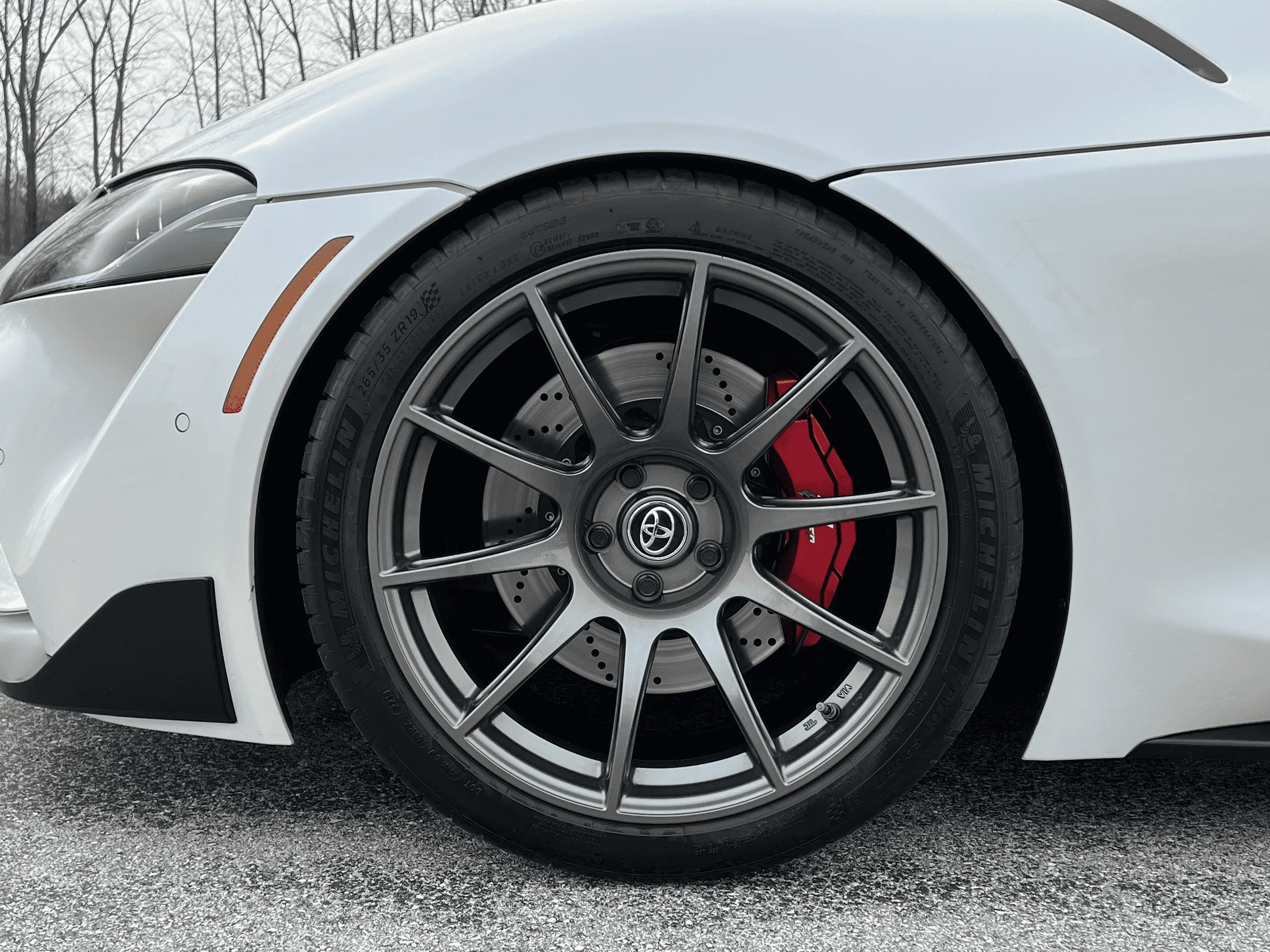

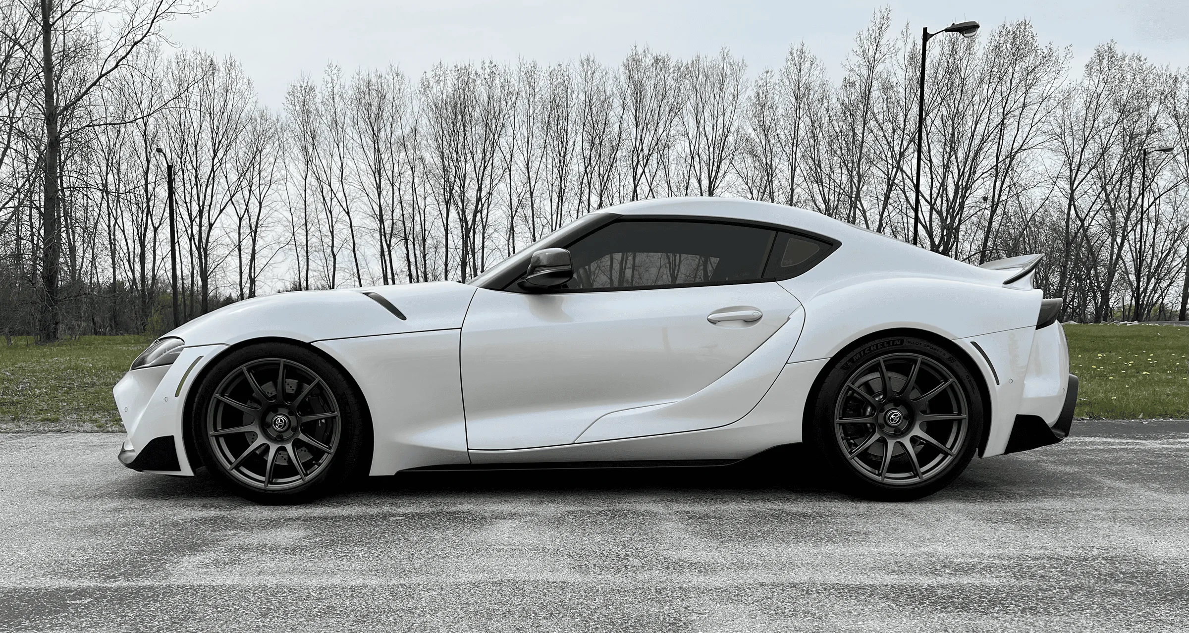

You're still pairing an aftermarket lowering spring with an OEM shock and strut that was never meant to accommodate said springs. While you're right on vehicle model specific parts, it's not drastic by any means to run any of the springs currently available for the A90.

PS. SupraMKV2.0 the car looks great!
