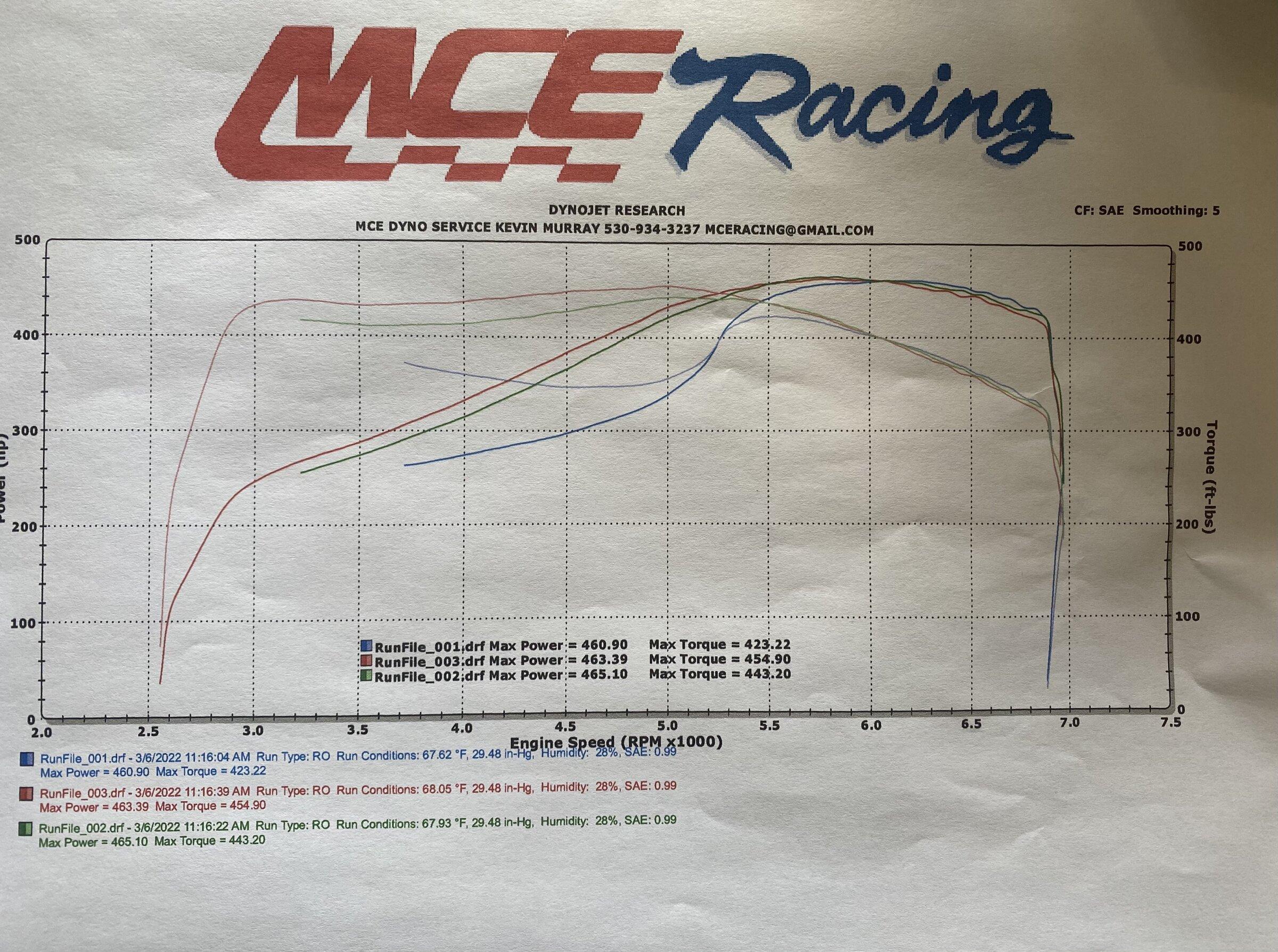

Pureboost in Germany.
The tune is Solid is fuck, only thing is you have to translate the website for application for the custom tune to make sure you're inputting the correct info lol, other than that, you're fine after. The way Fabian tunes is to make your car feel like it came stock from factory with XXX amount of hp, that's how smooth power delivery is.
My tune is setup with gradual boost, basically a boost by gear setup. I'm on E50 and i hook 2nd on warm tires no issues.
79
8,415
13,772
460 is pretty good I guess.
