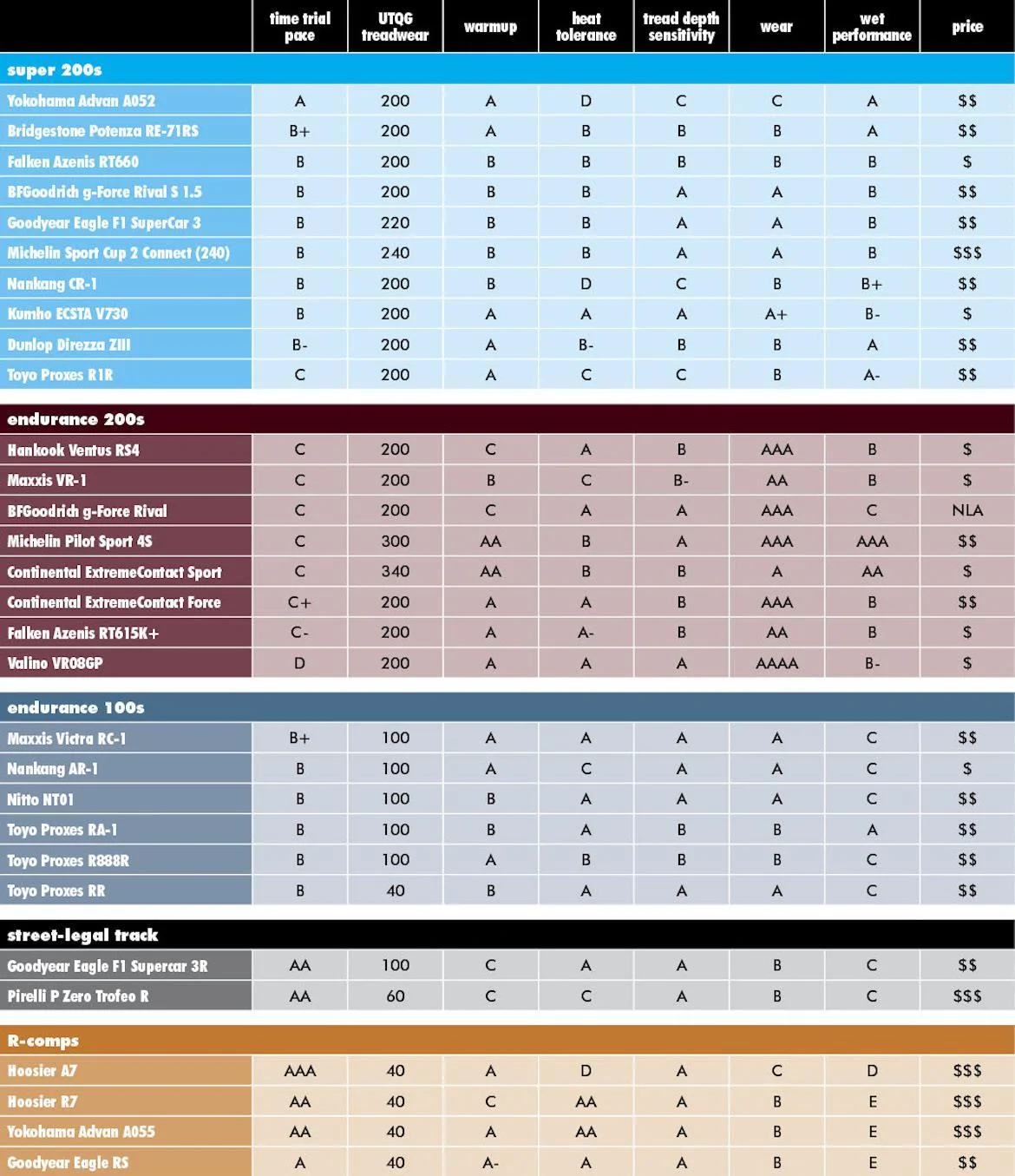

Running Bridgestone RE-71RS on mine. They are an endurance 200TW, really like these so far when it's warm. But it's not my daily now.
8,828
17,319
I wouldn't put the RE71RS in the endurance category of 200TW, I would put them in the Super200 category, with Yoko A052, Nankang CR-S, and Falken RT600

8,828
17,319
My understanding from Bridgestone, these were designed for endurance vs the RE-71R.
Is this not the case?
They use that word to state that the RE71RS takes longer to overheat compared to the RE71R but they are 100% for sure a Super200 tire still.
Here is a great table to see what tires fall in which bucket:
