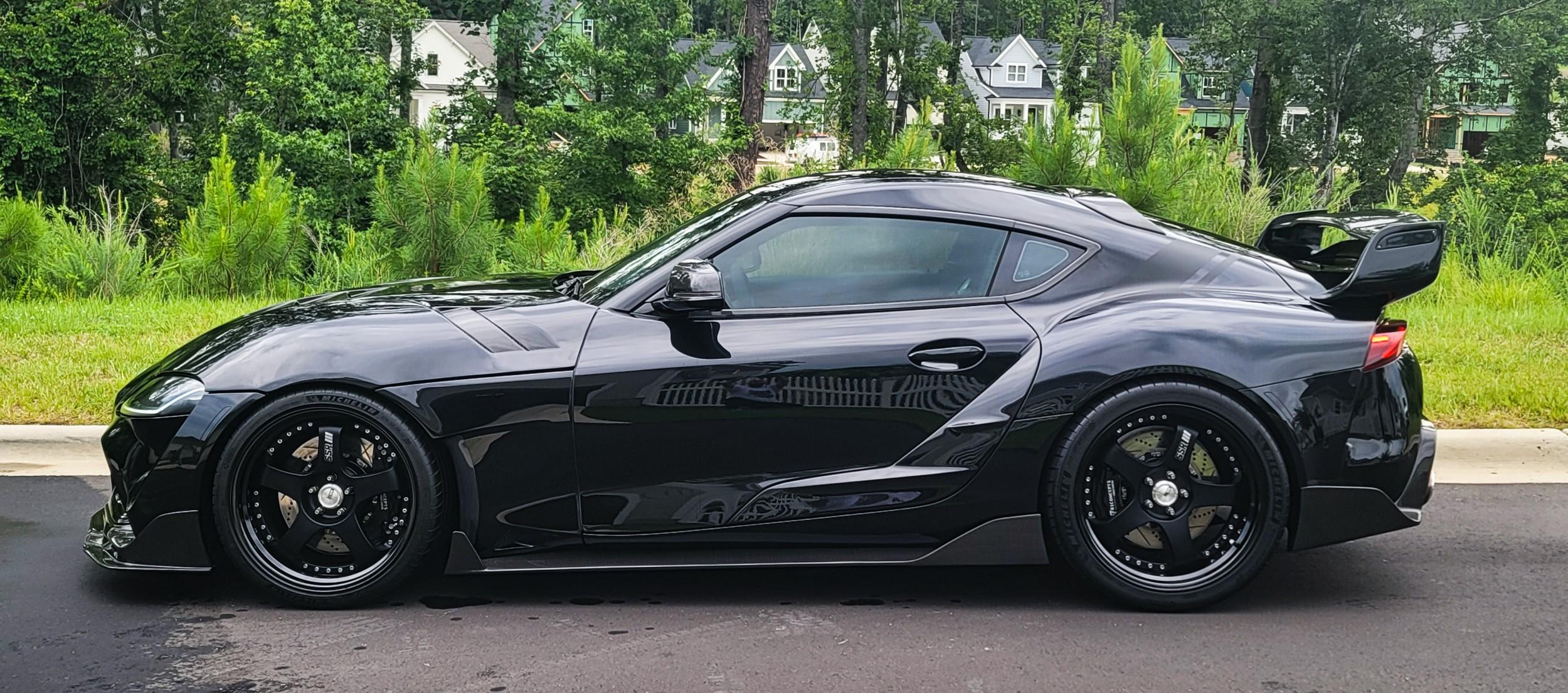

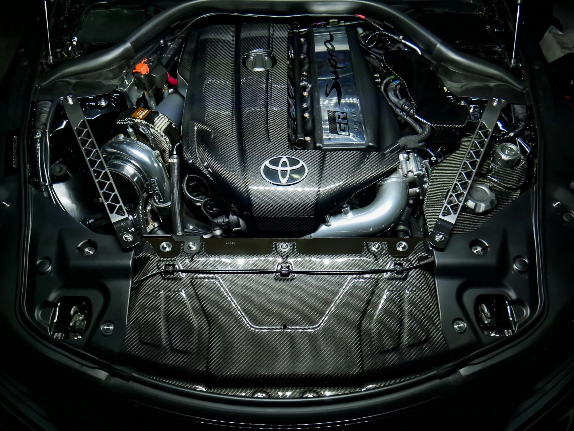

Moving the history of my first build here to clean up the original post for my next project:

BUILD SHEET:
  • MECHANICAL/PERFORMANCE
    • Tuning
      • Femto/Visconti Cloned ECU
      • XHP Transmission Tune Stage 2
      • EcuTek Tuned by Botti
        • Map 1 on 93: 480whp / 430wtq
        • Map 2 on 93: 520whp / 470wtq
        • Map 1 on E70: 630whp / 580wtq
        • Map 2 on E70: 740 whp / 680 wtq
        • Map 3 on E70: 830 whp / 760 wtq
    • Engine/Cooling/Exhaust/Powertrain/Fueling:
      • Visconti Fueling Kit:
        • Sequential Port Injection w/ID 1050x injectors
        • Flex Fuel Kit with Motiv Reflex Controller
        • Low Pressure Fuel Pump
      • Full Race Turbo Kit
        • Full Race Downpipe (Ceramic Coated)
        • 2X Tial Wastegates
        • Tial BOV
        • 2X Full Race Dump Tubes(Ceramic Coated)
        • Full Race 6 Port Manifold(Ceramic Coated)
        • Full Race Charge Pipe
      • PTE 6466 - Polished w/ T51R mod
      • Remark Catback Exhaust
      • CSF Heat Exchanger
      • CSF Transmission Cooler
      • CSF Aux Radiator
      • EOS Intake/Intercooler Manifold
      • EOS Oil Filter Relocation kit (Kia Stinger filter now used)
      • Torque Solutions Turbo Blanket
      • Radium Dual Catch Can
      • DSS Axles
      • Stage 1 Pure Transmission Rebuild (1000hp / 850tq)
    • Suspension/Wheels/Frame:
      • RS*R Best-i Active Coilove
      • Allstar Performance Spring Perch Spacer (seat rounded off to fit rubber perch)
      • R1 Concepts Big Brake Kit- 6 piston front and 6 piston rear with E-brake
      • Torque Solution Strut Bars (Customized)
      • MRG 82mm Stud Conversion Kit
      • Cusco Trunk Brace
      • SPL Front Lower Control Arm
      • 20" SSR SP1 Wheels (Customized to mount TPMS)
        • Front: 20x9.5 +22 MD 80mm Lip (+19 with spacers)
          • 3mm Wheel Spacers in the front
        • Rear: 20x10.5 +30 SL 105mm Lip
      • Michelin PS4S Tires
        • Front: 275/30 20
        • Rear: 305/30 20
      • Visconti Ride Height Sensor Bracket Upgrade
  • AESTHETICS/AERO/RICE
    • Engine Bay:
      • Verus Washer Fluid Cap
      • Verus Engine Bay Cap Kit
      • Verus Gas Cap
      • Verus A/C Cap Kit
      • Titanium Works Rear Toyota Emblem w/backplate
      • AMS Engine cover
      • AMS ECU cover
      • NV Specialties CF Radiator cover
      • NV Specialties Rear Engine Bay Covers
      • SCS Intake Manifold plaque
      • Dress Up Bolts Stage 1 Kit
      • JD Custom Bolts
      • HPS Bleeder Bolt
      • Rexpeed Coolant Cover
    • Interior:
      • ECS Steering Wheel
      • AutoTecknic Paddle Shifters
    • Exterior:
      • AutoTecknic Carbon Mirror Cover
      • Revel CF Door Moulding Cover
      • AMS Gloss Black Wind Deflectors
      • STREETHUNTER Wing (customized to fit A91 Spoiler)
      • Lift Support Depot 152 lbs Quick Release Trunk
      • A91 Spoiler Painted Body Color
      • P2uned Door Garnish (CF finished in body color)
      • Seibon Roof Spoiler
      • Seibon MB Diffuser
      • Seibon MB Skirts
      • Seibon MB Front Lip
      • Seibon TSII Hood
      • Varis Track Edition Fenders
      • Varis Carbon Fiber Fender Protectors
      • OEM Reflectors Shaved and Painted
      • Bumper Reflectors Smoked

The first part of my build will focus solely on wheels/brakes/suspension. This is my current plan:
WHEELS
Right now I'm working to have some bespoke 19" 2 piece wheels created. It will be a thick 5 spoke design. I just can't pull myself away from having 5 spokes. I'll try to add a bit of soul to it so it doesn't look like another Work Meister or SSR Professor.
Measurements are 19x9.5 ET+19 for the front and 19x11 ET+38 for the rear. Tires will be Sport Cup 2s in 265/35 and 315/30.
This is the secret sauce formula for perfect flush fitment without rubbing under full load + maximum turning angle.
BRAKES
I've also been talking to a APG rep for brakes. I'm looking at 8 piston front with a 365mm rotor and 6 piston rear with a 356mm rotor.
SUSPENSION
Reached out to SPL to help me put together a kit specifically for the streets.
As for coilovers, I'm looking at the KW DDC instead of RSR Best-i Active this go around. I'm still doing some research.
BRACING
I'm looking at:
  • Sard front body damper
  • Sard rear body damper
  • HKS Trunk Brace (need something for my GoPro)
  • TRD Strut Brace (Trying to find it without the rear body damper. Seems like it comes together no matter what)
  • aFe Front Sway Bar
  • aFe Rear Sway Bar
  • CPM rear bottom brace (Keeping stock one)
  • CPM front member brace (Does nothing)
That should be about it for the handling/wheel setup.
