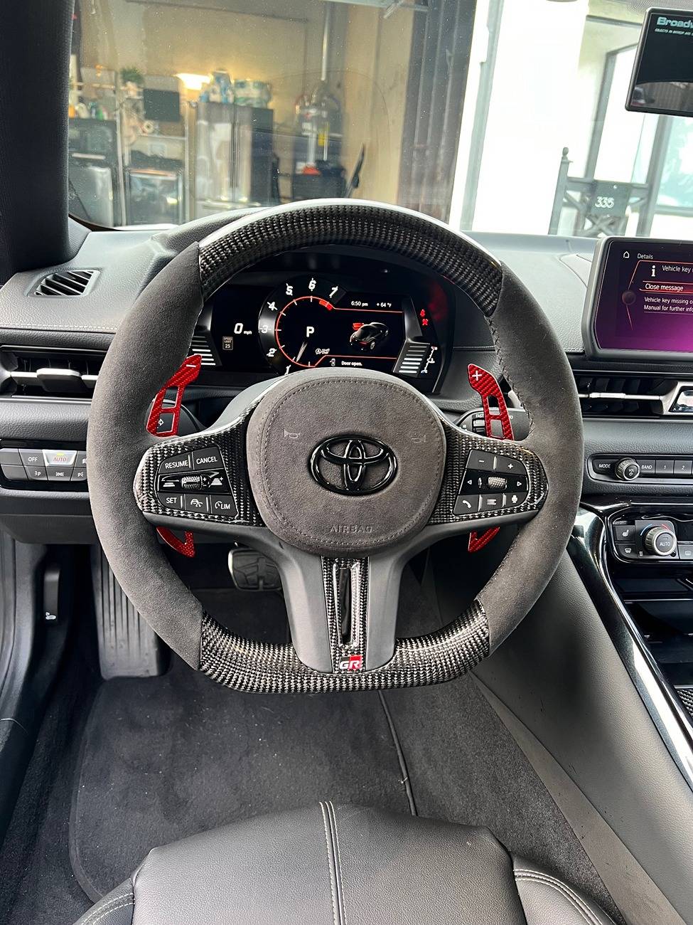

Well a few months ago I had an OEM G8x LCI wheel turned into a supra wheel and think it came out amazing! So far I have done a handful more of these and it really is a great looking swap! Been meaning to post this sooner but life has been busy as some of you know I started law school, it has been a hell of a journey so far and time has been hard to come by, but still very much active in our groups and in this community!
Going to be running some aggressive Black Friday/ Veterans Day/ Thanksgiving sales over the next few weeks and a lot of great deals on in stock stuff. In the mean time check this out, I love it. Like with all G series swaps, you risk loosing your gap adjustment for ACC, but from personal experience and dozens of customers, it is not a big deal, 99% of people have it set to the shortest anyway. As always, whenever you have any questions or to place an order you can reach out through here or my website (berktuning.com).
Nice wheel. Of course the ACC distance set is a moot point for the manual cars.

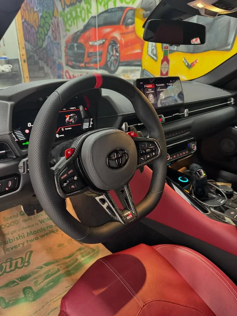

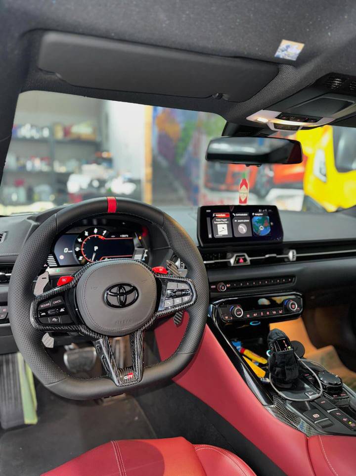

Bump for Phillip! Great communication and kept me updated on my order. I went with carbon fiber top, carbon fiber flat bottom, and alcantara sides with matching air bag. I love the wheel, and it's a huge upgrade compared to the stock wheel.
PS I went back to matte cf paddle shifters to tone it down.

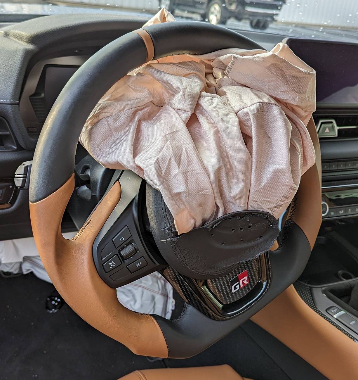

My question on all of these, which I don't think any of the modders can adequately answer without a lot of expensive testing, is how safe is that airbag after having a custom cover with a plastic badge sewn onto it?
Airbags are, at the best of times, a carefully controlled explosion next to your head designed to inflate a bag that's safe for your face to impact into. If you attempt to contain that explosion in ANY way, it will turn what's containing it into a grenade. If the plastic beauty cover of the airbag doesn't fail at the built-in weak points which allow flaps of the material to get out of the way of the airbag in a controlled way, that airbag cover is going to break apart in an uncontrolled way, and it will send fragments of plastic at high speed into your eyeballs.
This isn't even easy for huge corporations to get right all of the time, ask Takata. What are the odds these cottage industry guys modifying airbags are going to get it right at all?

Hey, very valid question! And one that I have had tested already a handful of times inadvertently, So these airbag covers do not go over the OEM cover, as you said that would inherently hinder the airbag and result in unexpected possible consequences, instead, I provide replacement airbag covers that are wrapped in leather instead of the faux vinyl/ rubber toyota uses. This is still an oem airbag cover that has an extremely thin layer of leather and an OEM toyota badge installed the same way you would find on the standard airbag cover. For the LCI wheel in particular, the OE bmw bag that comes with it is leather wrapped as standard. For the supra airbags I provide a leather airbag cover, it functions the exact same way. Some vendors/ manufacturers, do provide overlays, or I have even seen Carbon airbag covers, this is extremely dangerous, and as a law students, boggles my mind as it opens people up to unthinkable levels of product liability. This is why I use OEM Cores + oem airbag covers.
