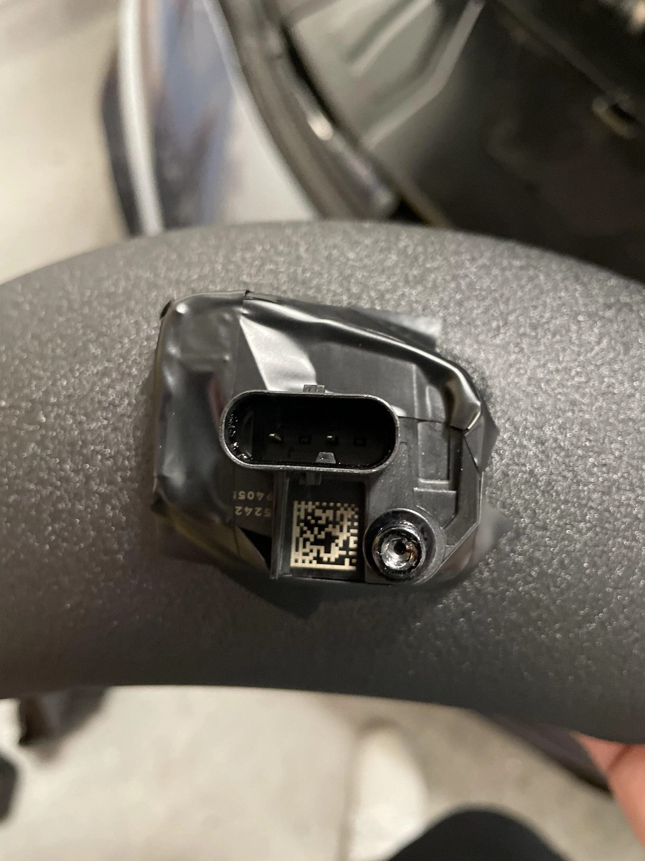

Sorry to dig up this old thread, but I literally did the same thing today when installing my intake. Screw head came right off and it was basically flush with the hole. I tried drilling but wasn’t successful with that either and just made the problem worse.
For now I have the intake installed with one of the 2 hex screws in and then wrapped the whole thing in electrical tape to keep the other corner flush as well. It was the only thing I could think of in the time being as I was losing patience lol. Do you guys think this will cause issues or throw a CEL? I took the car for a drive after install to test and didn’t throw any codes but I’m not sure long term.
Really would like to avoid having to buy a whole other intake pipe 🥴

The intake side doesn't matter -at all-. This is a bullshit temp sensor. Big turbo folks just zip time this sensor anywhere it'll fit. These cars don't have a MAF.
That’s reassuring to hear then. I’ll probably just run it with the tape for now to keep it from fluttering around all over the place. My biggest concern was having the car run too lean if this sensor’s readings were off.
Thanks for the help!

Car will not run lean from this sensor for sure. You're good. <3
