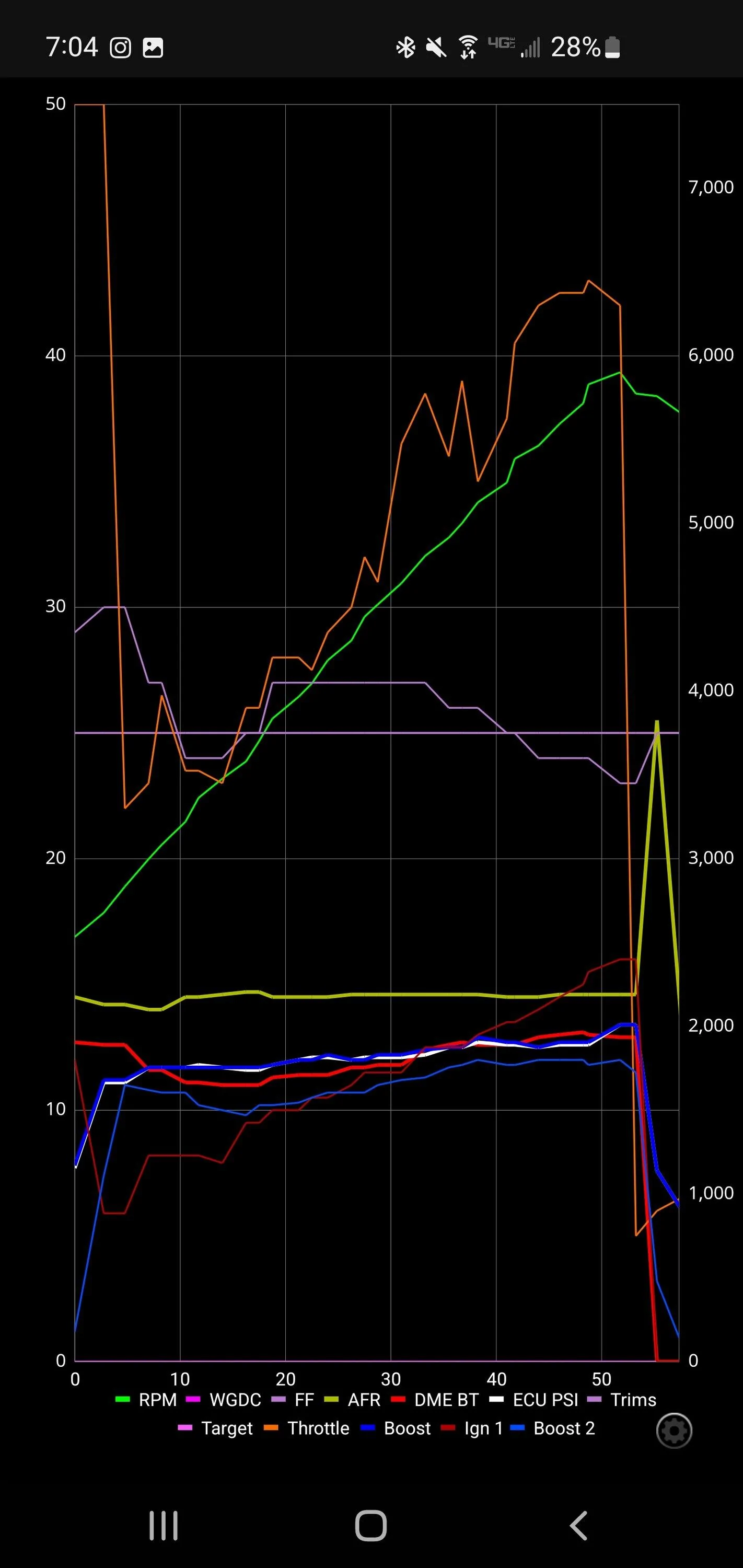

MT Supra overboosting/throttle closure with catless dp
