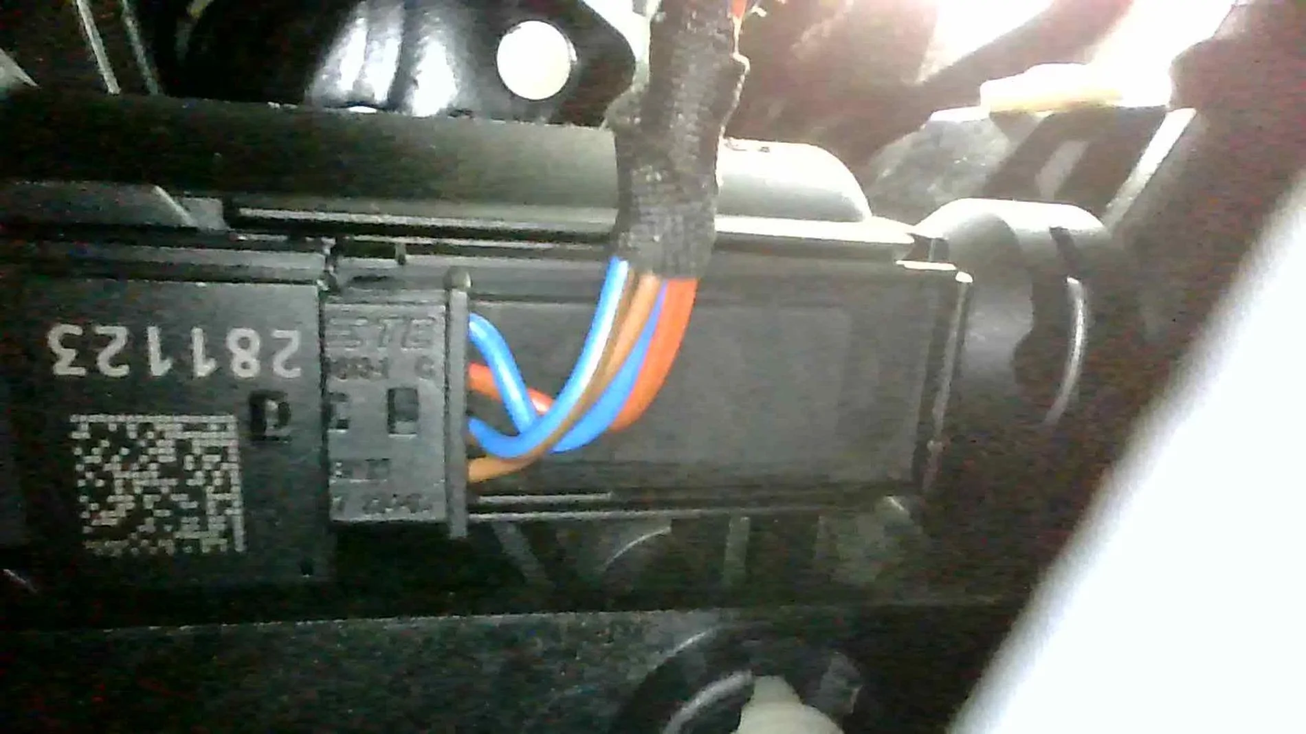

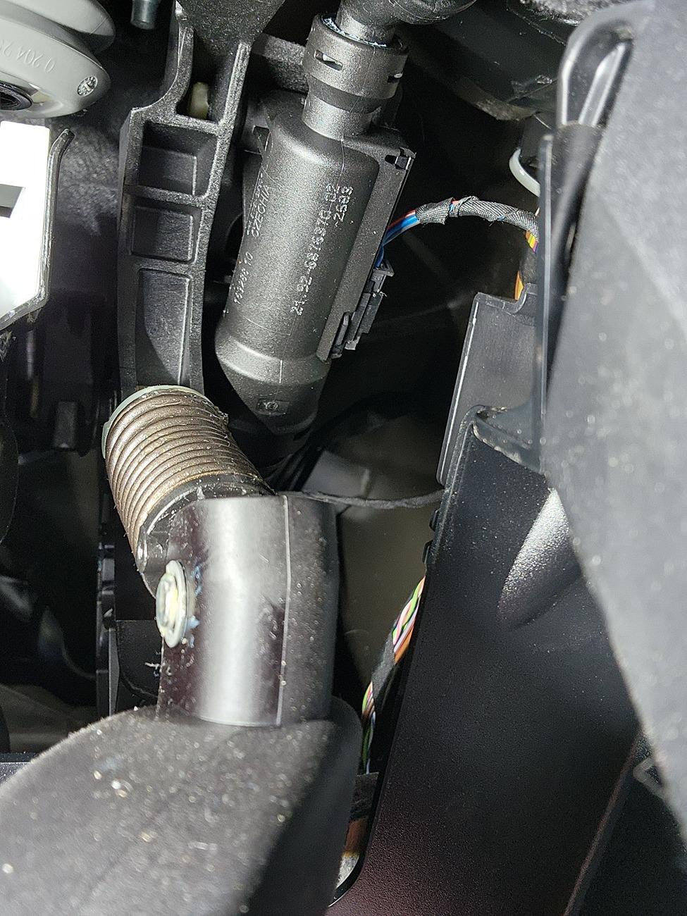

On my '24, the point at which the throttle map switches over is at roughly 1-2 inches of travel up from the floor, and far enough below the clutch bite point that there is room to let the pedal up a bit after the map switches and before the clutch bite begins. It otherwise acts just as OP describes. I'm planning to look at this a little more though i do not have the tools to look at maps, etc. (stock, locked ecu).
Edit: not 1/2 pedal travel, more like 1 to 2 inches up from the floor.
Mf1ve
Mike
Mar 12, 2024
43
Huntsville, AL
2024 Supra MT, 1993 EG Civic, 2014 Tacoma
Definitely a switch or sensor on the clutch master.
Mf1ve
Mike
Mar 12, 2024
43
Huntsville, AL
The connector faces towards the outside of the car and is easy to touch but difficult to get to.

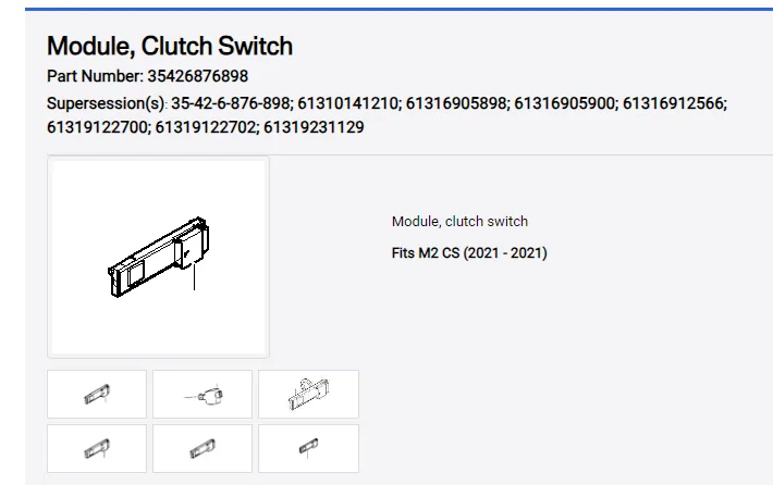

Kinda looks like a Hall effect sensor. Here's a similar (or the same) part on a BMW:
And per this link, this switch does interact with a magnet on the clutch master cylinder piston - and acts as the clutch safety interlock for starting the car. The link is about spoofing the switch signal to allow for starting without depressing the clutch when desired (via a second switch). It does mention that the clutch switch/sensor supplies more than one signal, " Other features like cruise control and automatic idle-up are unaffected since they use a different signal on the clutch switch."
