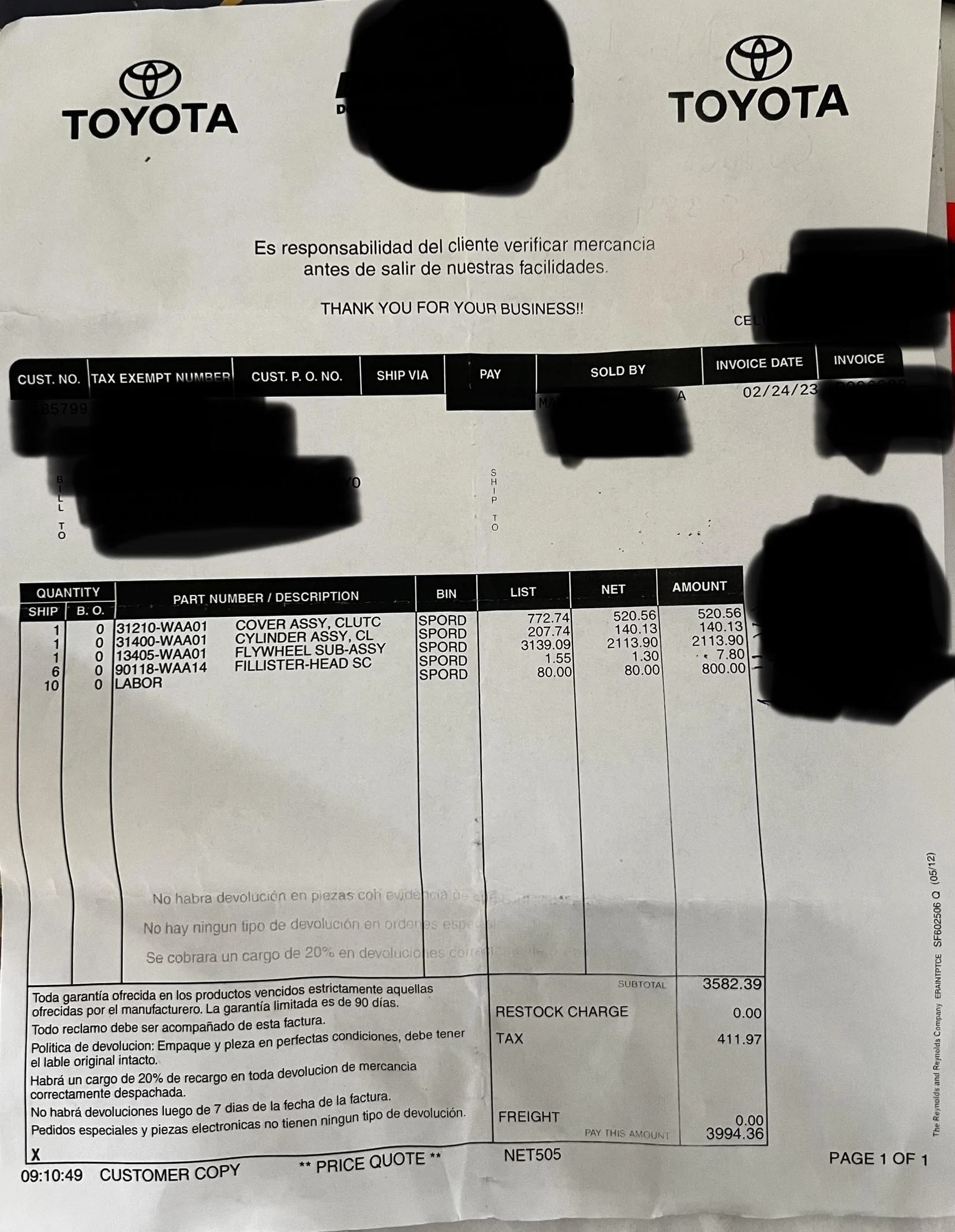

I love the car but definitely didn't expect to have such unreliable clutch!!
Simply put the clutch went out and the dealer says is not a repair under warranty unless Toyota approves this repair as a factory defect.
Waiting on Toyota corporate to find a solutions that doesn't involve me paying for a defective new platform problem.

flywheel replaced? Takes quite a bit to warp a flywheel. Clutch was either hanging or someone don't know how to shift. Hope they replace it for you, also hope you broke in the clutch before hot rodding it.

The only way to purchase the clutch disc is along with the flywheel. They don't sell it any other way right now.
