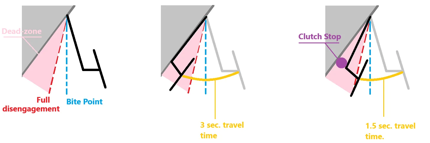

I’ve also been interested in a clutch stop since the pedal travel is so long it makes me adjust my seat further up than I would normally. I think it’s a totally different situation as CDV that looks to improve shift quality vs pedal throw.
Right, they are 2 separate items. I guess what i was more looking for, was the ability to shift from 1st to 2nd faster.
I figured the CDV delete would improve the 1-2 speed by reducing the time the clutch slipped.
And adding the clutch stop would reduce overall shifting time in general.

A stop limits movements, so I'm trying to figure out how it would help with shifting.
My intention on using a clutch stop is to reduce the deadzone in the clutch pedal.
I can reach the end of the clutch travel faster, meaning I can get ON and OFF the clutch faster, resulting in faster shifts.

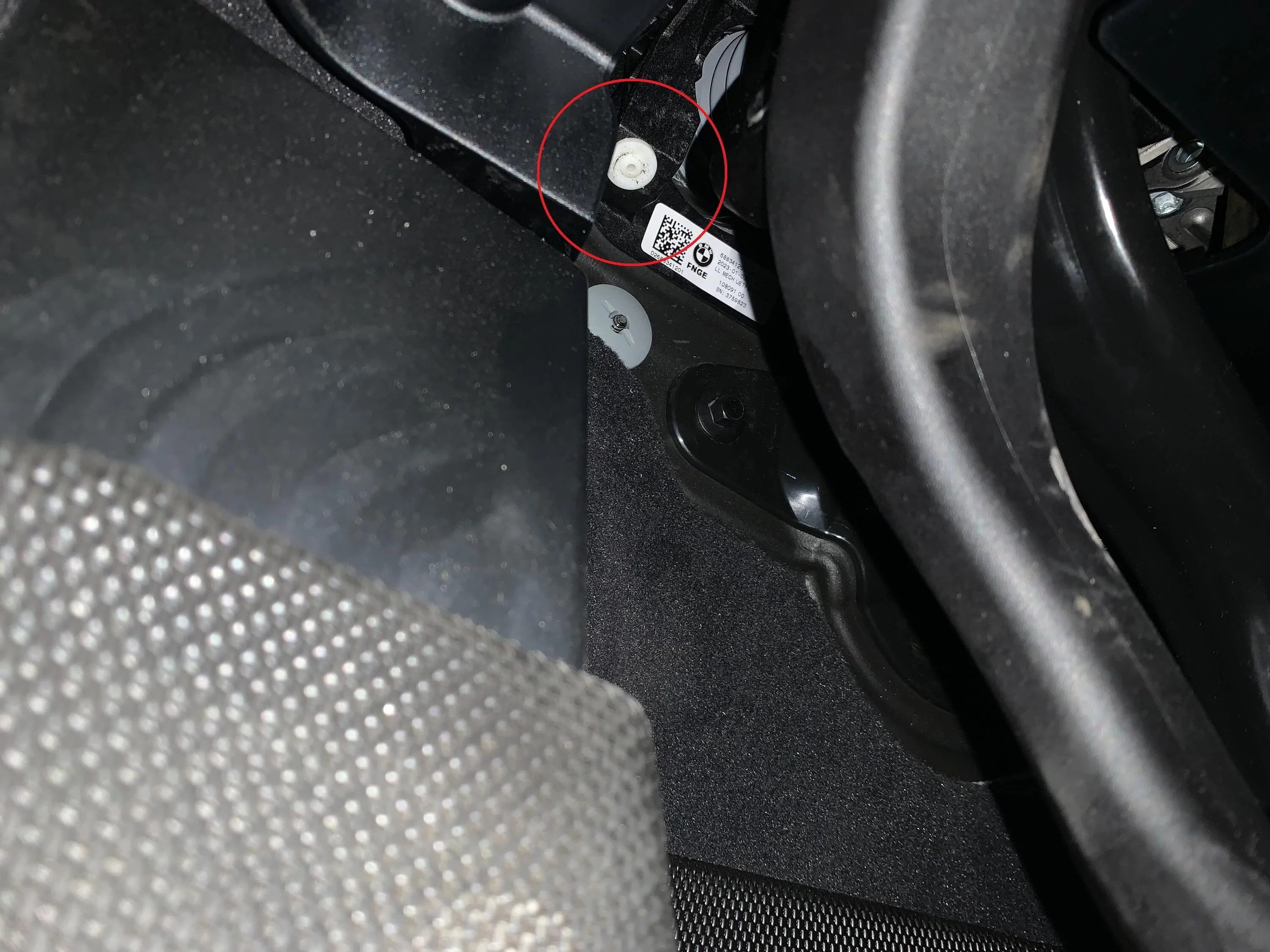

FWIW, I went ahead and installed the clutch-stop, after the CDV delete.
Ive got about 1200 miles or so using the Clutch-stop, and I can confidently say it has dramatically increased my ability to shift faster. There is still a good bit of travel after the bite-point, so I am able to fully disengage the clutch. I haven't maxed out the clutch stop either (there is about 25% or so before i max out).
The CDV delete got rid of the weirdness between shifts, and allowed for a more predictable experience.
Overall, I love this setup. The car is much more predictable and shifting is faster, is easier than ever.
That's not usually how a clutch stop works, so still trying to figure out how it helps. I realize these cars have some whacky, German engineering, so maybe there is something I'm missing.
It shouldn't have any effect on your clutch pedal, nor how fast you can shift.
Getting rid of the CDV is what helps you shift faster.

:D I might not be explaining it correct. I guess it doesn't improve shift time directly.
It reduces the travel time at the clutch pedal, which overall reduces time take to complete a full shift.
kaj
Jason
Aug 6, 2022
2,223
2,558
Fresno, CA
'00 360 / '69 Charger
I guess if the clutch still works correctly, then I can kinda see how it would speed things up. I've never pushed a clutch pedal more than needed to disengage before.. definitely not to the floor. So this is a clutch PEDAL stop. When most of us hear "clutch stop" we think of a part that usually goes on the trans somewhere that limits the movement of the TOB in some way. Long story... not important. LOL. Anyway, now I see what you mean.
But isn't it just easier to not push the pedal until it hits something?
Yess! I think a Clutch Pedal Stop is probably the right term for it.
It a little tricky with the Supra. The bite point is already pretty low, so imo it's safer to go nearly all the way, rather then risking grinding something like the transmission synchros. Also prevents me from overthinking every darn shift :p
