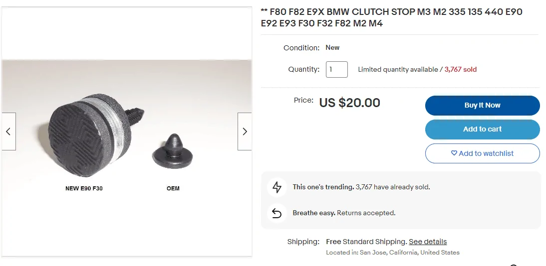

This weekend, I chatted with the owner of a F30 340i with a MT, and he basically described the same issues regarding the 1-2 weird shifts. He hadn't heard of the CDV delete yet, and said he was going to investigate. However, he did mention that his 1 mod (the Clutch Stop), basically improved shifting speed and launching ability, specially 1-2nd gear.
He let me drive his car, and I first noticed that the shifter feel is eerily similar to my A90MT, with slightly less resistance (about 5-10%) and slightly less notchy-ness. Felt great and familiar, nonetheless.
Secondly, shifting from 1-2 was way faster, and the clutch engagement was much more "immediate" and smoother. Granted I don't know what the un-modded shifting is like.
I am curious if any other A90MT owners have thought about this and/or installed one of these?
I know we can swap our slaves with an E90 slave, so presumably a clutch-stop from a E90 might work for us ?

You don't need to install the E90 slave in order to do the clutch delay valve delete-you should be able to just disconnect the line to the slave and carefully remove the o-ring and CDV from the existing slave cylinder.
I would recommend just doing the CDV delete instead of adding a clutch stop. It's a relatively easy process and doesn't cost anything. Additionally, you're not adding any risk of premature clutch wear down the line, since this clutch stop seems to mess with your clutch engagement point.
Shifting from 1-2 can be quicker and less jerky, from my experience with the CDV delete. I didn't notice a more "immediate" clutch engagement, since the bite point is still the same.

I'd also definitely advise against a 'clutch stop' and encourage the CDV delete procedure instead if you're that set on making a change.
How many miles are on your MTs so far? The sticky 1-2 shift gets much better over time as the parts wear-in together. I rolled over 4,000 miles this morning, and have noticed substantial improvement already, especially from 2,500 onward. I can't wait to feel how nice it'll be after 7,500-10,000!

True, you can simply remove the CDV from the OEM ring instead of the full swap.
The clutch stop should technically be adjusted to prevent any change in clutch engagement point and premature wear. Effectively it should simply remove or reduce the "deadzone". It does seem very sketchy and could go horribly wrong if not done right.
Im glad simply doing the CDV delete vastly improves 1-2 shifts. I might just stop here lol.

+1 on not doing the stop. I did one on a car and had to keep adjusting it as the clutch would wear. The stop didn't allow the fork and slave to move with wear, so I'd get clutch slippage.
yikes, does the clutch still not completely disengage a few inches after the bite point?
I figured if the clutch was still engaged, the shifter would lock out or grind?
My car had a pull -type clutch so was opposite. Falling to fully disengage would be even worse, as you would kill synchros instead of just a clutch.
