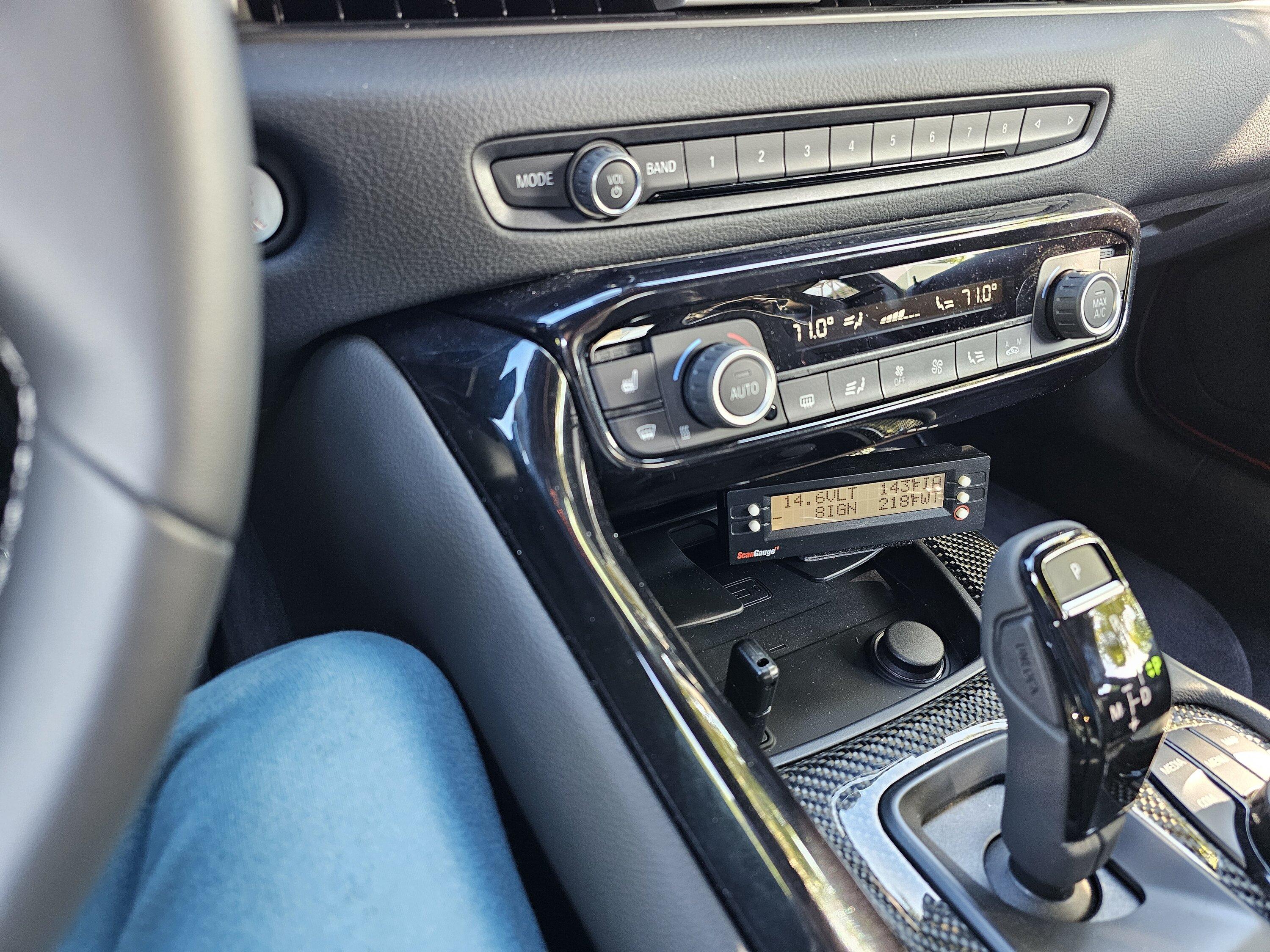

lol at 143F IAT's.
Anything over 110 F in my 01 Corvette would trigger the ECU to retard the ignition. That's why I had installed a cold air "scoop" of sorts under the engine. After that, temps rarely exceeded 90 degrees.
8,772
17,214
You're in for a surprise then. ;)
8,772
17,214
Good to know.....perhaps a CAI is in my future.
OEM takes air from the outside. The Supra is turbocharged. The actual charge temps pre intercooler are more like 300F+. The IAT you are seeing on that gauge is most likely after the intake manifold intercooler.
I'm assuming it was 70F+ out that day.
Yes, it was low to mid 70s today. So the OEM intake path is essentially a CAI, correct?

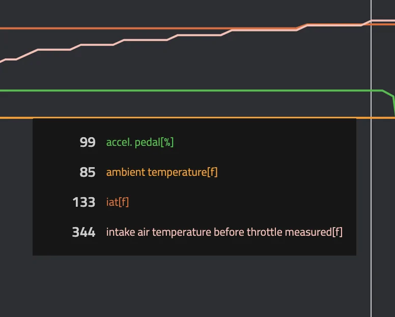

Sorta kinda. It takes air in right behind the right headlight.
My point is, the turbo heats the air up a ton, the intercooler cools it.
