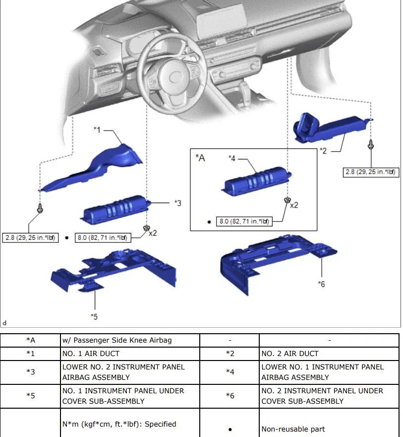

I just recently looked at the panels that probably need to be removed if I am to snake the ScanGauge cable underneath the center console and over to the OBD II port.
Has anyone done this? This assembly image seems to show that there are no fasteners. Then again, this may be the wrong assembly image. I can't find anything else.

Why do you need to route it across the dash? Where are you putting the gauge?
5 and 6 in that diagram have twist lock fasteners. You just turn them with your fingers or a flathead screwdriver and the panels are loose. The fasteners are captive.

I vaguely remember panel 6 having finger twist fasteners, but panel number 5 either needed a 10mm socket or a Phillips screwdriver. I do recall being annoyed that it wasn't twist lock on both sides

Twist lock on both sides on my 2020

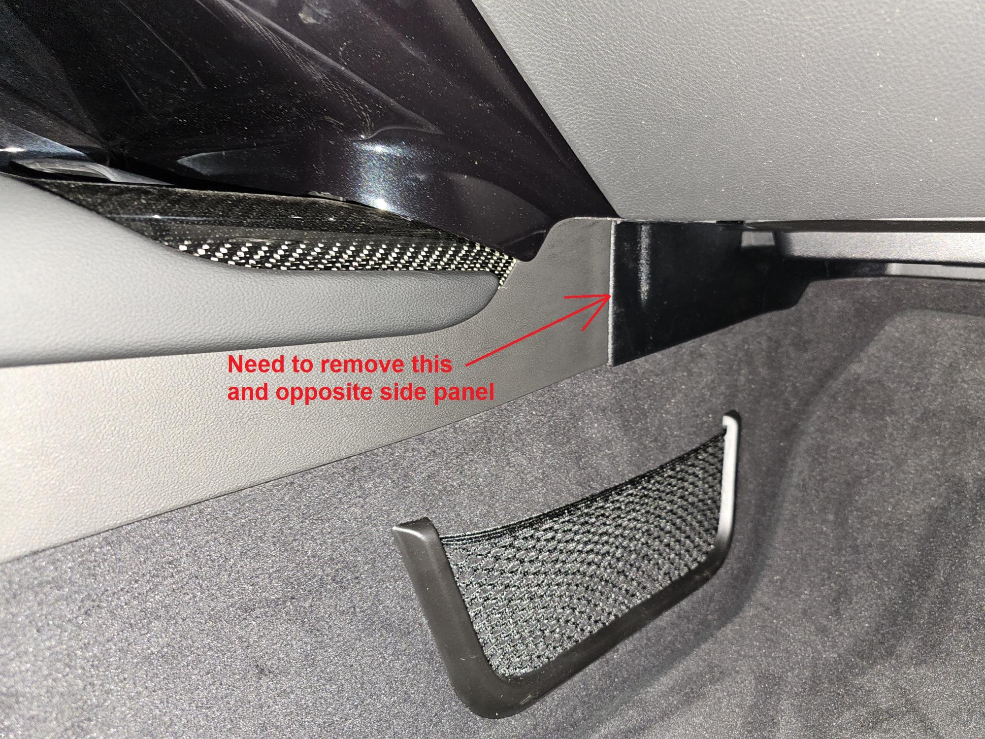

Now why would they go and make a trivial change like this, but then ignore the wind buffeting problem. and only half-ass the change, to boot.
how it looks on the 2023:
