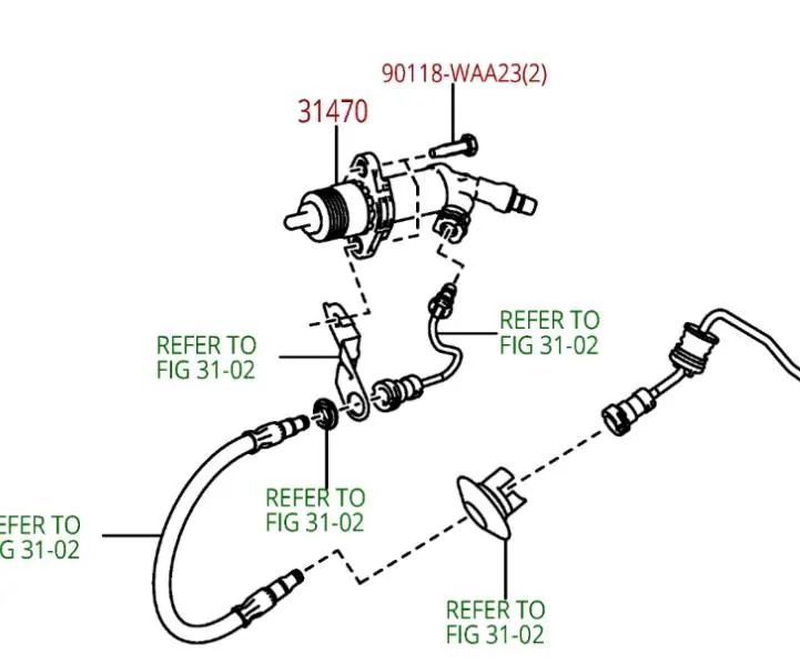

Has anyone confirmed whether the supra actually has a clutch delay valve or not? The G80 M3 has it and this is essentially the same transmission so I'm guessing it does.

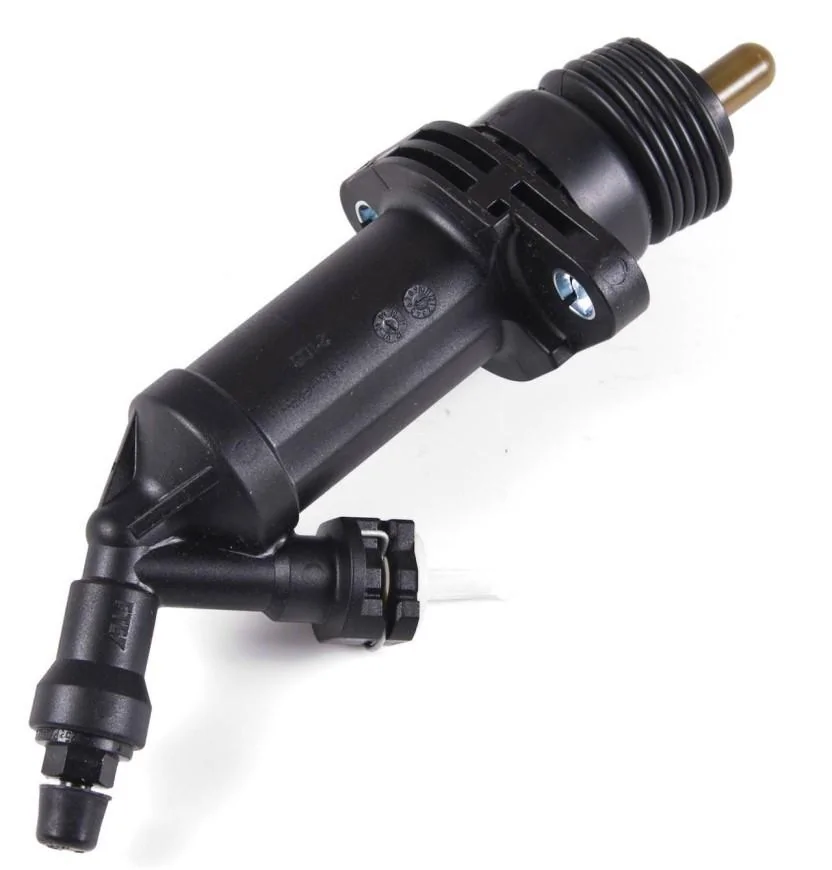

Hmmmmmm, I'm tempted to try something...
In the G80 the CDV is in the line connecting to the slave cylinder. I know BMW has done it both ways but I'd start with checking that line first.
I looked on parts.toyota.com but didn't see it available to order.
The slave cylinder and line are not available, as they don't even have a valid part number for them yet, along with many other MT and clutch-related parts. Pretty frustrating, as they started building actual production MT models in July of 2022, and test mules waaayy before that. Let me make a couple phone calls and see where we are in this process...
Forget removing the restrictor, it has no influence on clutch failure. I've seen the same supposed "solution" of removing the restrictor on other makes and it has no effect other than making the clutch slightly harder to modulate. People remove it looking for a "magic bullet" to absolutely any clutch issue and even clutch "non issues". It's a pity the clowns in the video didn't take the time to sit down at the bench with a good light and a magnifier and try and see what happened to the plate. IE did it shed some lining due to a friction plate rivet failing or had it been chronically slipping and overheated and then failed or had the friction plate failed mechanically initially and then it shed material. Or did they just want to destroy the std clutch so they could fit a new unit they had waiting to go on.
