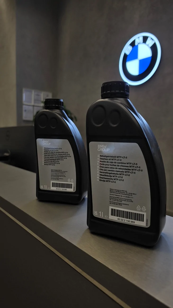

Nothing yet. I did already buy the OEM BMW MTF-LT-5 though, so my next step is to completely drain the Motul 75W-90 that's currently in the transmission and refill it with the OEM fluid.
I want to try that first and see if it makes any difference to the 2nd → 3rd / 3rd → 2nd shift feel. I'll definitely update the thread once I've changed it and had some time to drive the car.
