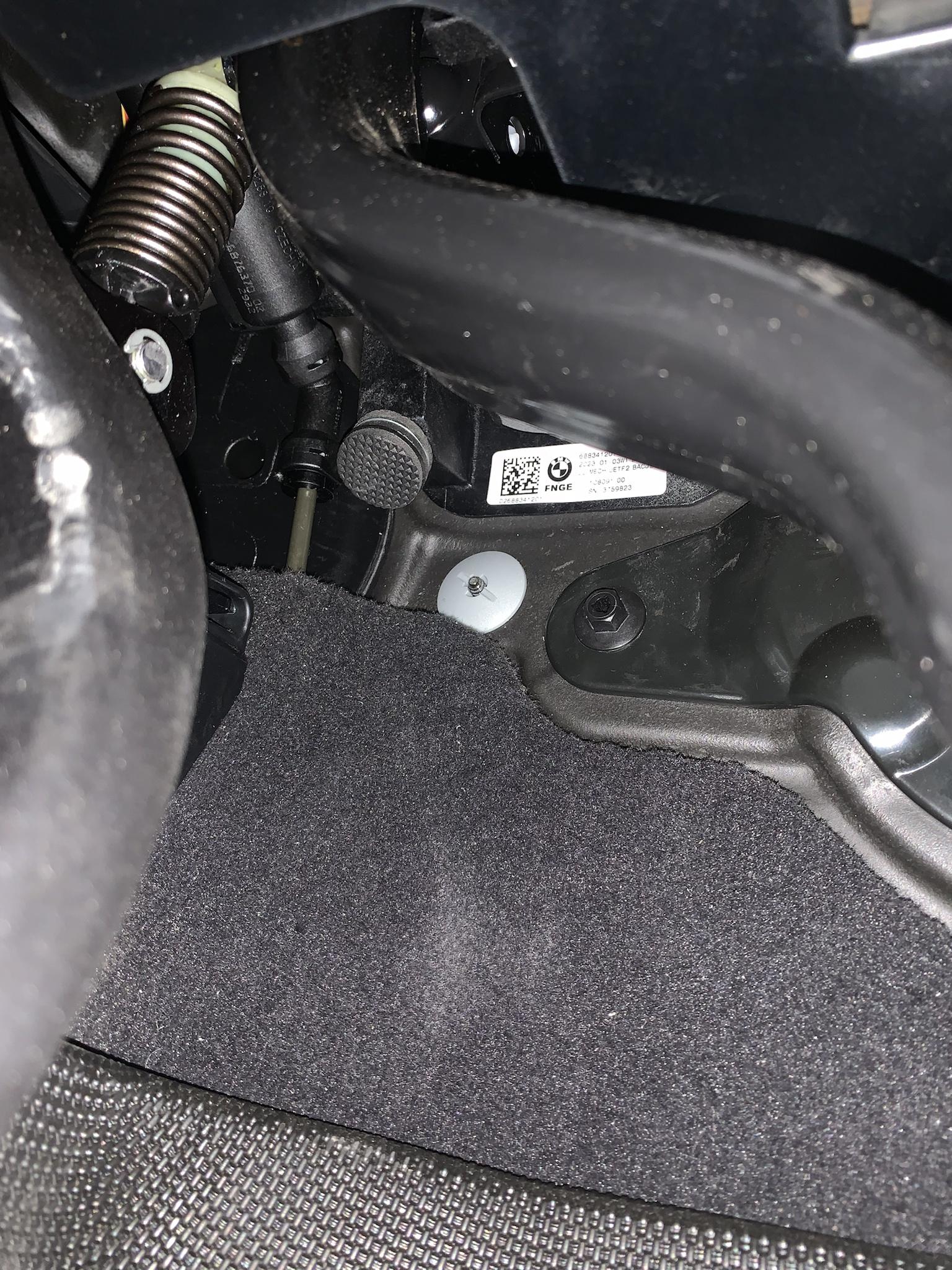

Just installed mine, definitely worth the $10. Now instead of going 4"+ past the engagement point of the clutch (when depressing the pedal) you only go down 2-3". Next up will be the CDV delete.

So I bought and installed the $10 eBay clutch stop and I gotta say wow what a difference. I sort of never realized I how the pedal was being pushed back further than it needed to go until now. I took the advice of a user here and removed two of the shims and it seems pretty on the money. I’m no mechanic but I’m almost certain at that level the clutch is fully disengaged and no grinding occurs when shifting gears. I’ve driven it only a handful of times since but it don’t think it will be an issue in traffic or for daily use. Clutch engagement it’s about an inch to an inch and a half off the the stop so you can still ride it so to speak. I think I will play around with it though and remove just one more shim (metal washer) as I’d like for it to go just a little bit further back. I’ve got long legs! I have done the cdv delete too and have a 500g shift knob so the car is really waking up now!

Update I did end up removing one washer from the stop and immediately it felt better than with two. It only lasted about a week before the whole thing snapped maybe from the cold weather or from being removed and reinstalled as it seems this thing is a one time use. I did buy another one but I’ve sort of gotten used to the really long pedal press now and I swear I think it’s easier to modulate the clutch grab and gear change now so I don’t think I’m gonna ever put it back in. Something you try and then realize it was fine from the factory haha! Placebo in full effect
