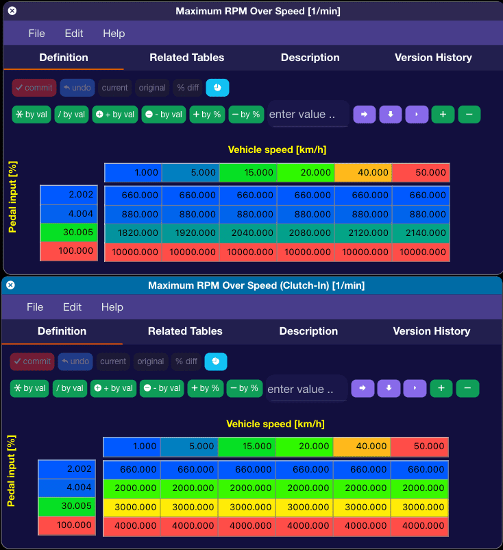

Okay, someone here was kind enough to provide me with their 2023 MT stock ROM.
Overall, when comparing to a 2023 Auto ROM, almost everything is identical. There are some scaling changes and obviously gear ratio changes and such. The throttle mapping for the 6MT maps are identical in both ROMs.
However, I did find these two tables that are pretty interesting. Obviously the clutch-in table is not used on a Auto Supra. This could be the table that flares the RPM up with the clutch switch.

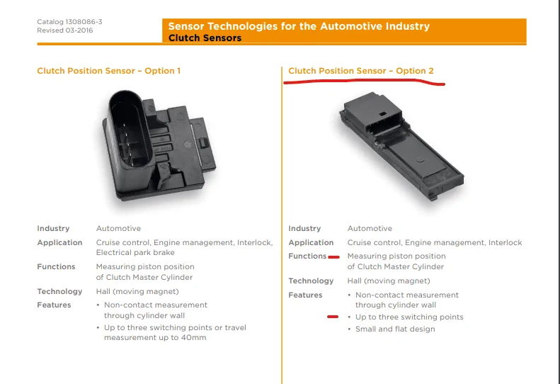

Im wondering if its even worth a try to bypass "clutch-in" signal? for the mean time with a locked DME?
Also, does it compare to other neutrals too like gear neutral as a ( OR ) condition along with the clutch?
Have to check what connector they use from TE Connectivity if I decided to make a patch cable without splicing the existing one...
https://www.te.com/content/dam/te-com/documents/sensors/global/1308086-3-clutch-sensors.pdf
Yes! A patch cable would be awesome anyway. We could put some logic probes on it and see what's going on, then interrupt signals and see the effects.

The more I look at these tables the more I think they aren't what we are looking for. This is MAX RPM per speed.
I still think it's the neutral throttle mapping table I mentioned earlier in this thread.
Fair enough. I think uncovering all the ways that the clutch sensor affects the ECU is important so thank you for exploring the data.

I suspect Toyota/BMW originally designed the throttle mappings for the AT. It had the de-tuned mapping for "Neutral" which we are seeing. This is totally fine for an AT.
When the MT came out, they kept the mappings the same, applying the "Neutral" map to the clutch-in condition. Regardless, this is a design error by Toyota/BMW which hopefully will be fixed by the OEM!
