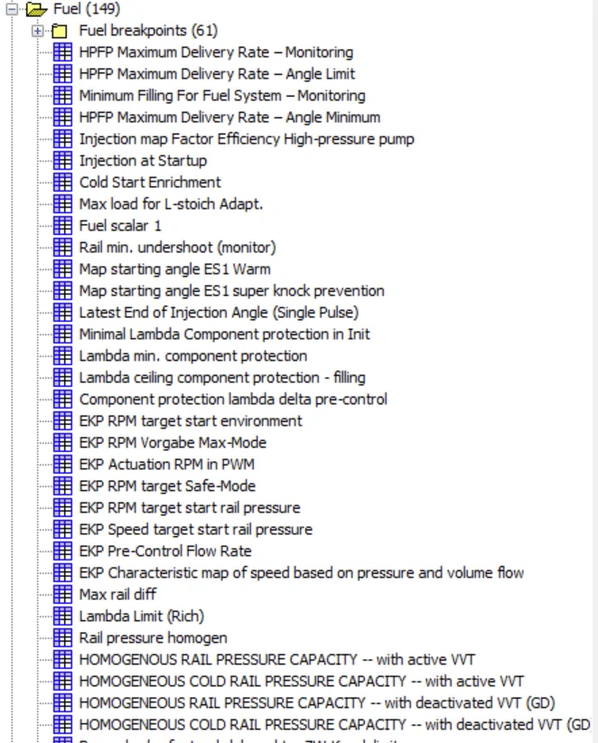

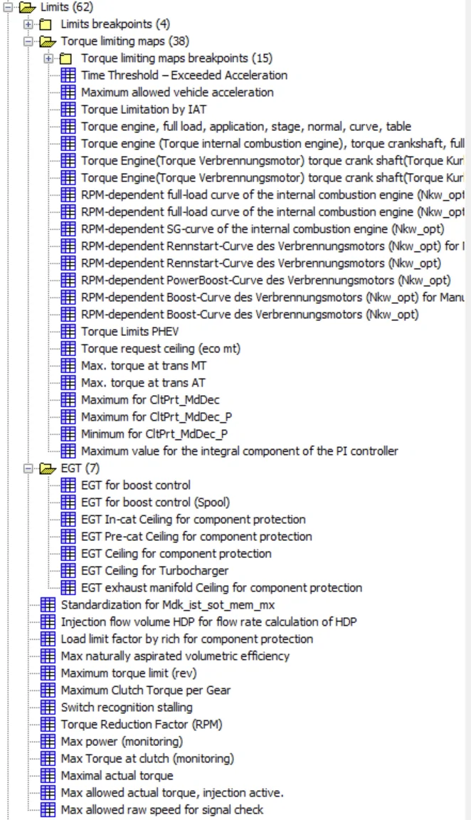

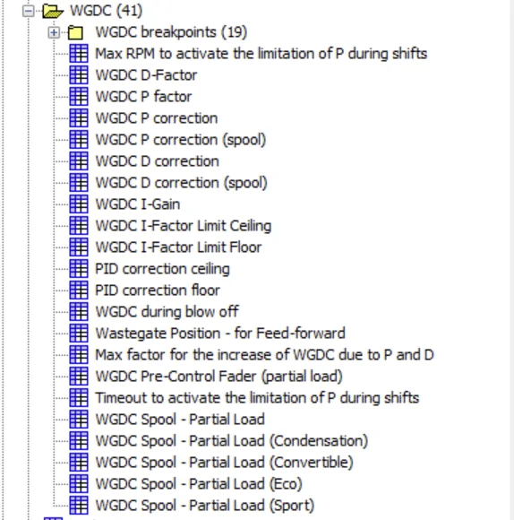

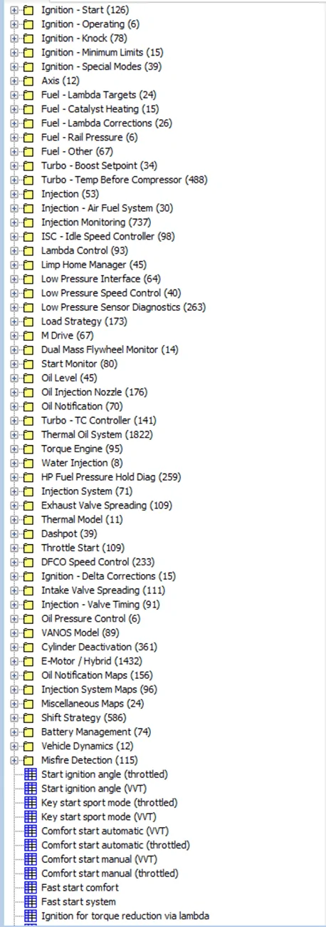

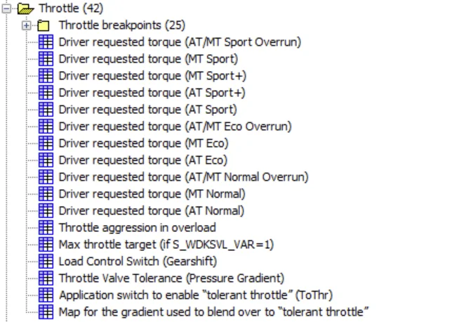

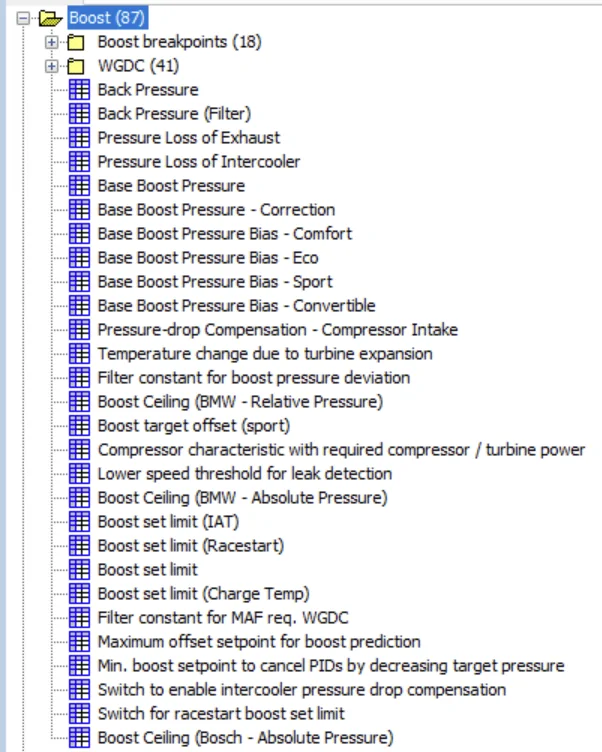

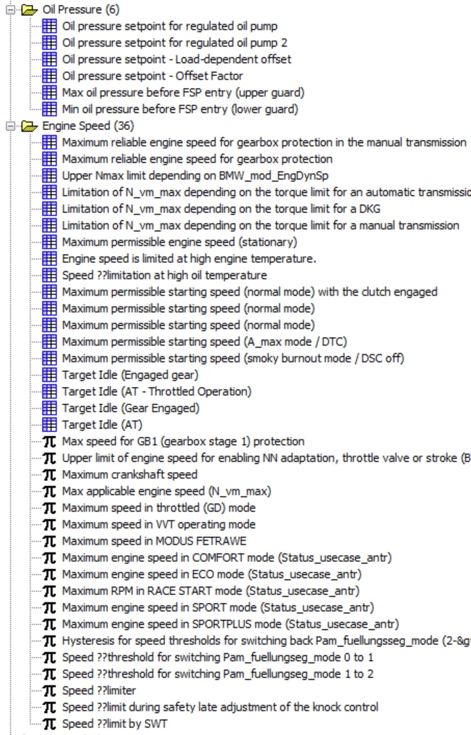

Speaking of thousands of tables, you might appreciate this project I just did where I defined over 4,400 tables in one BIN version that will help me define more tables in other bins:

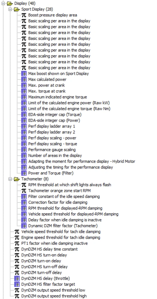

I've also been putting some time into defining tables in my personal BIN (some tables are the ones you mentioned):

100% agree, which is why I created that thread. I have also been defining tables above and beyond what is in MHD XDF files. Many of which are the ones you mentioned. I haven't had time to update the tuning thread here but it's on my list. I'm also open to helping individuals if I can.

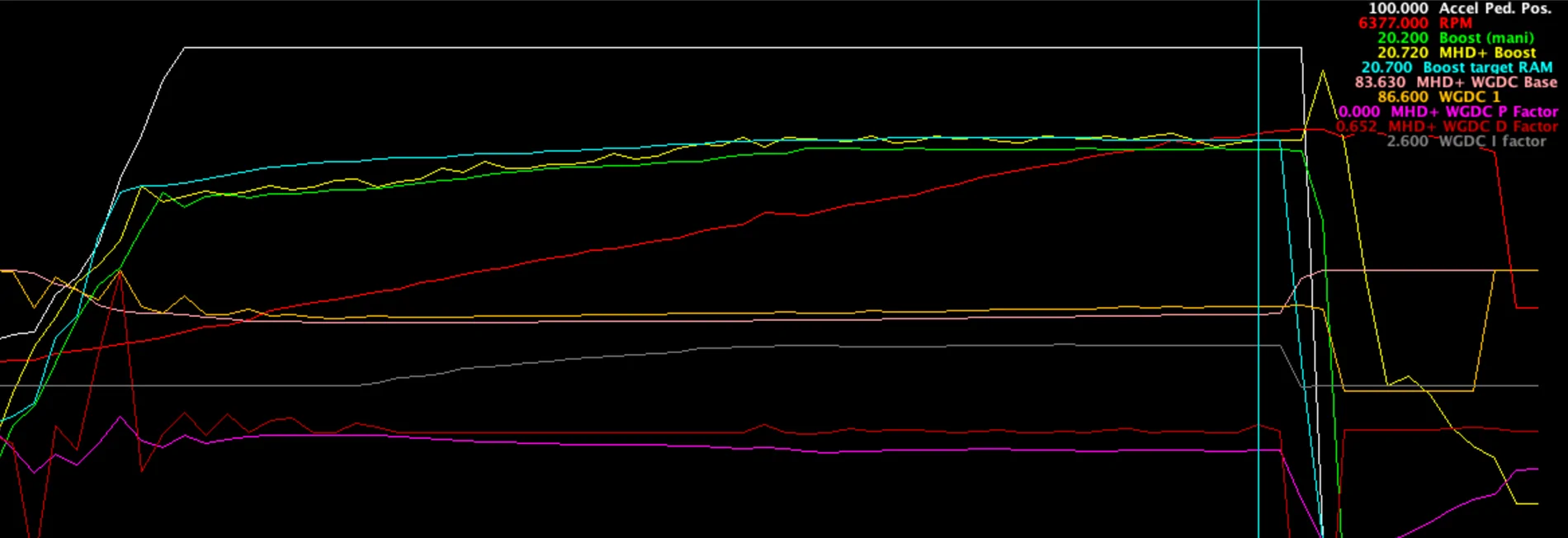

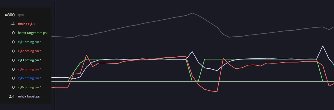

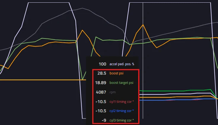

https://datazap.me/u/coloneladama/log-1771531155?log=0&data=2-3-6-17-33-34-35-36-37-38&solo=2
pretty big shortcomings... here's shift behavior you can expect. Don't worry, MHD says you can always just "shift better" or use NLS (no lift shift). Its not their job to make a map that works with MTs, its your job to change how you drive.
serious knock and 10+ psi overboosts are totally fine and need no improvements, don't worry the limp mode does reset after 20 minutes or so.
Its not even hard to fix it genuinely, I hardly know what I'm doing yet on MHD and had shift boost spikes resolved on Revision 2. @QTR FMS - This is MHD+ boost control at .2 psi deviation with a barely tuned PID.

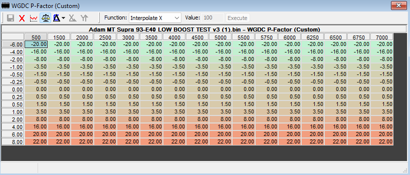

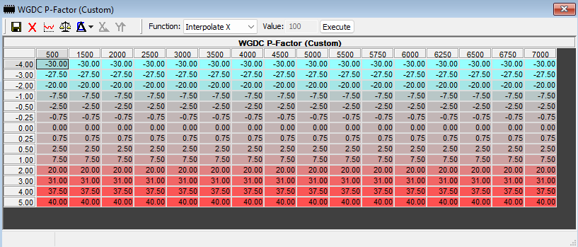

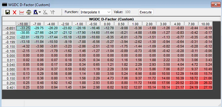

Initially, I didn't want to use MHD WDGC and PID, since it was rpm-based and didn't have a spool setting and i saw that MG1 logic more advance and overal better, but now that I think I figured out how the tables work i might change my mind.

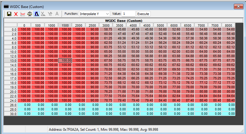

here is what im gonna try to test today, i want to see if i set 80% wdgc in the spooling area and get the P to raise my wdgc to 100% fast enough until maybe 5psi error, then slow the P down. This should fix partial throttle overboost issues you had in the other thread by using the P for spooling rather than setting 100% in the low rpm area.
This is the WGDC I just built to start testing with, i will lower the WGDC below 2500 once i test the P.

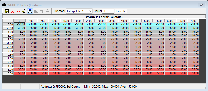

this is the P, not sure if the values are correct, from my understanding this table is not a gain table but rather WGDC adder based on boost deviation. i will rescale it later and make 5 psi 100% duty cycle.
my D table is still 0 not sure how to populate it.
don't, it looks right for under 2500 :) Always at 100% under boost threshold rpm
This is a good starting point for WGDC base, I'd probably drop another 5% across the board as you always want a positive PID response.
Yes, the P table (and D) is a WGDC% adder
Here is what mine was in the log I shared, but it actually needs to be even more aggressive.
This is the p-table I try next. It may be a little too much, but spool was a bit slow on occasion.
I haven't really optimized d-factor yet, it definitely needs work, but this was the base table Bryan shared.
Spool pretty much sits at 100% WGDC then starts to blend to the MHD+ WGDC somewhere around 5 psi below target from what i've seen.
that is why I re adjusted the Y axis breakpoints of my p-table. If its not using MHD+ logic when boost deviation >5psi, then clip it there and get more granularity in the table.

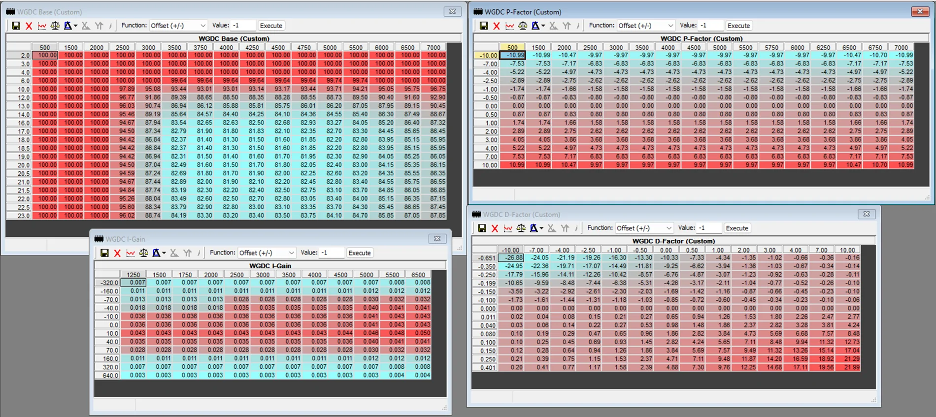

That P table is crazy aggressive in the higher deviation areas. That means P can give up to 50% more WGDC. If you need to have it that aggressive, than your base WGDC tuning needs more work.
D is dampening. Slows or speeds up P response.
For larger turbos, P can be more aggressive without as many ill effects, on stock turbo, you have to make sure it's not too aggressive or it can get erratic.
In simple terms. Your base wgdc should be the main tuning table and you use PID for error correction for different ambient temps and driving conditions.
I am currently tuning my personal G-series M240i, here are my in-progress WGDC, P/D, boost target tables.
E50. Stock car, stock dp, drop in air filter.
You can see I need to tweak P and D a bit, and some tweaks to base WGDC.
