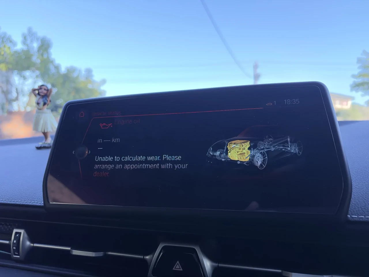

So I flashed to the latest MHD 98RON OTS tune today and sure enough, I got the 30E08 - Power management Battery below upper limit error and CEL. Cleared fine of course, but I also got this on iDrive.
Didn't clear on the drive or after a brief stop. I'm going to let it sit for a day then go for another drive and see if it goes away.. like it hopefully usually does.
Of course, if you mention any of this to MHD they just deny the flash had anything to do with it, even though these errors never happen any other time. 🙄

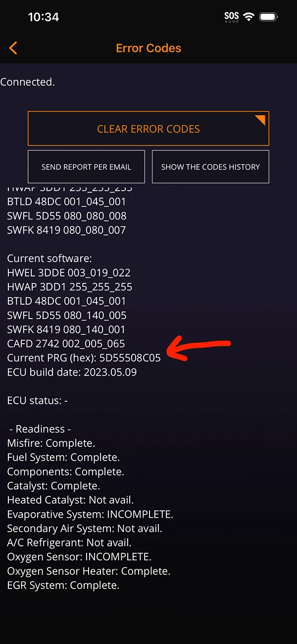

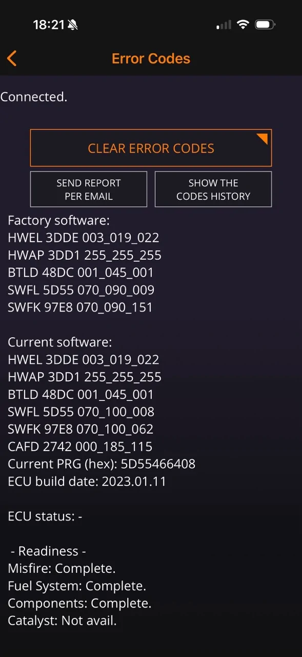

Out of curiosity, what BIN ID is yours?
I get this every flash. Never had that idrive error though.
Do you have a theory?
I flashed again today and while the battery CEL appeared as usual, the Oil one didn't appear until after a drive and engine on/off cycle. I suspect it will once again disappear after a rest. Instead of oil, I've had tyre pressure reading errors in the past.
I don't know why it's doing this but it's as if the flash somehow destroys some recent data and until the car gets new data, the ECU thinks there is some kind of data logging error.
I reached out to MHD and they just shrugged their shoulders and told me it's not their problem.
i have the same cal id and no issue, are you using original battery or different one? if its different did you reprogram it?
Nope. Stock battery - Never replaced. And I'm using the orange universal MHD OBDII dongle, as an aside.
