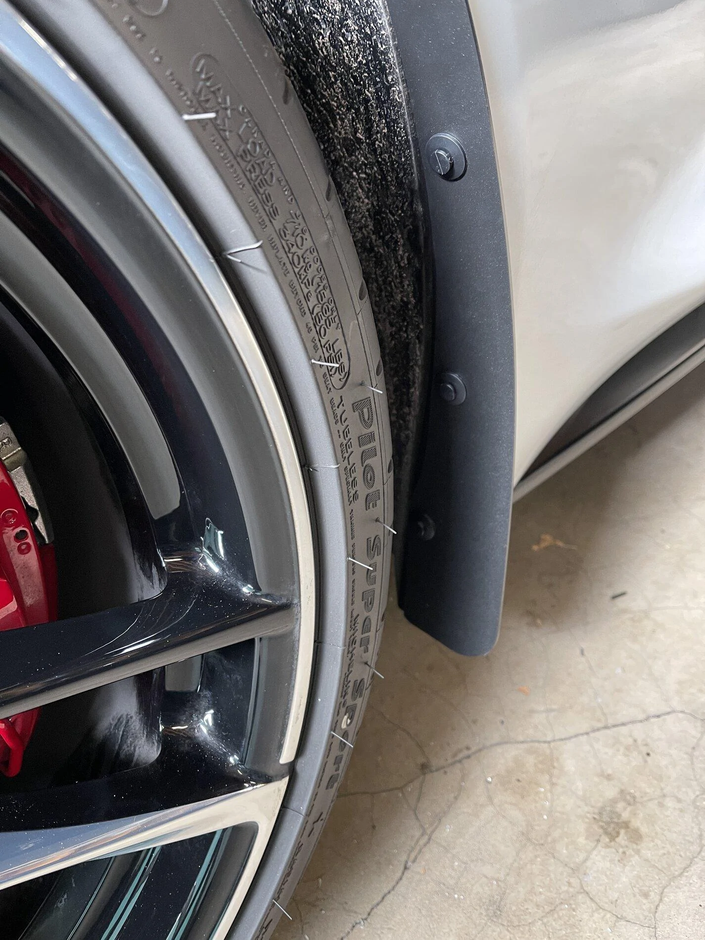

I have been delaying installing these and realized that I lost the plastic rivets for the front that came with the ZL1 flaps. Does anyone now what rivet size is recommended? I see it is recommended to go a little longer than stock but cant find the stock size...
Wow, I literally last night just had the same problem. My kitten carried off the little bag with the replacement plastic rivets, and we can't find it anywhere. We hit up Autozone, and found they carry a large selection of 1/4" (hole size) plastic rivets. The existing holes in the fender are just a tiny bit smaller than 1/4". I used a sharp 1/4" drill and widened the holes every-so-slightly, then the 1/4" rivets fit great. The one's we bought were about twice as long as the stock rivets. No big deal, there's plenty of open space behind these.
Here's a pic.

Great. Thanks! Ill check those out. When I called the dealership to see if they had just the OEM ones they said they didnt have any and had to order them.

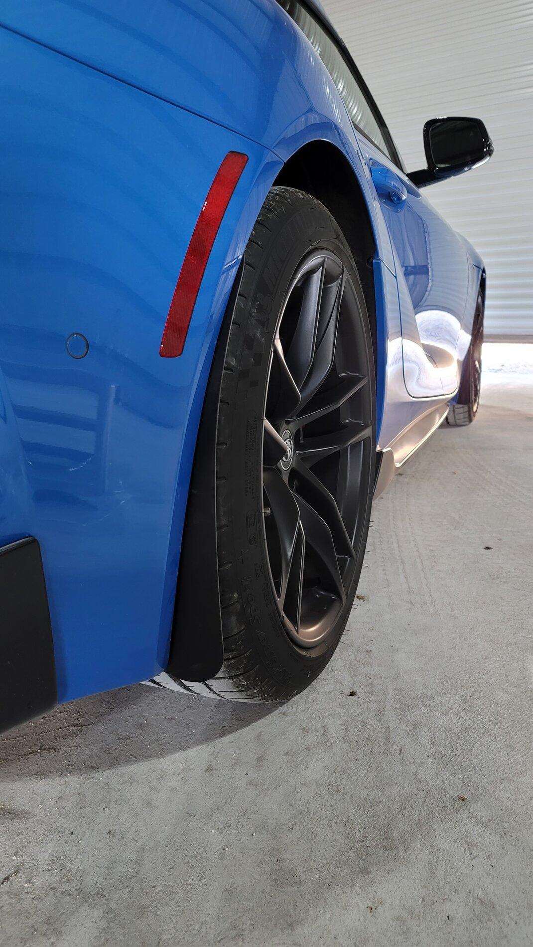

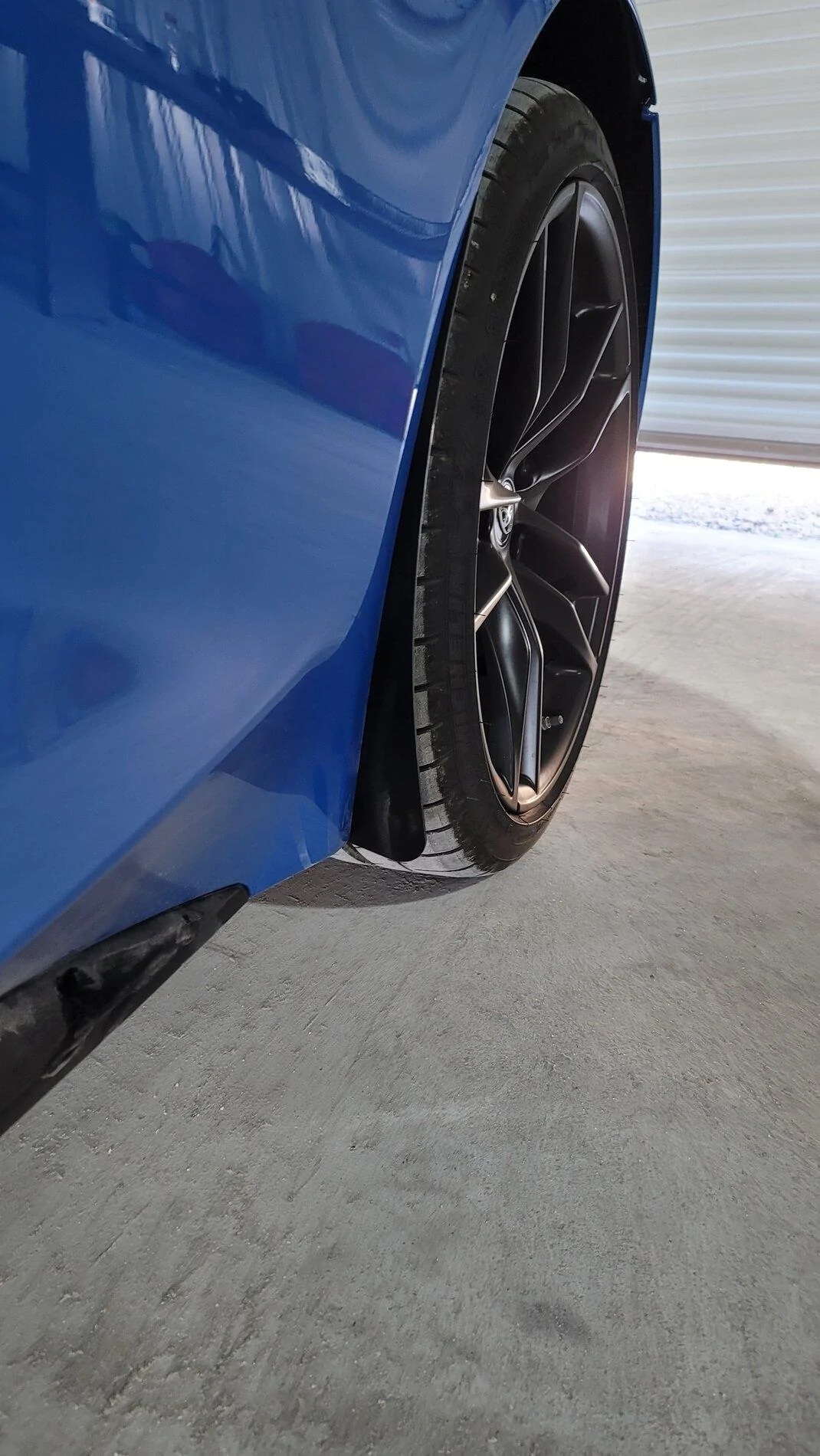

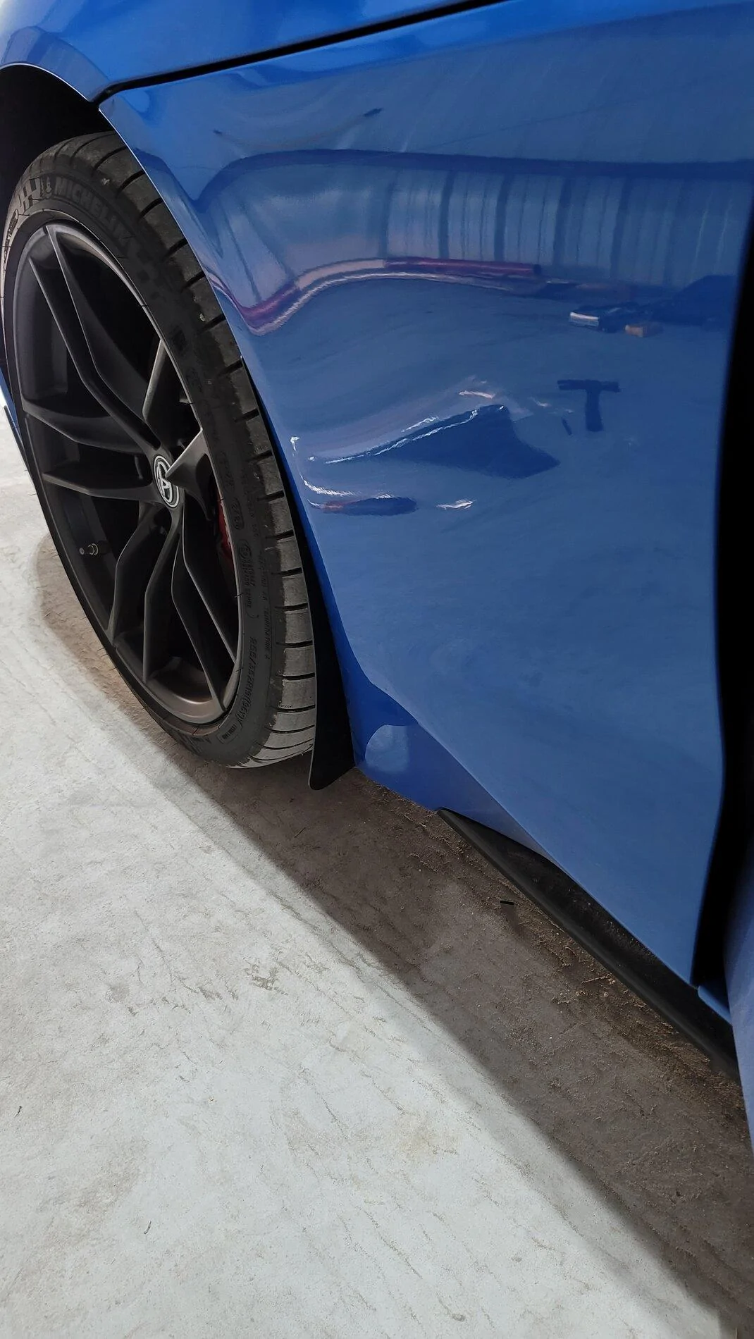

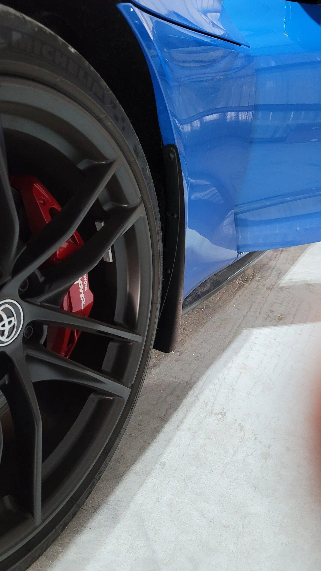

These flaps look good. They look integrated and match the other black trim. They should help with chips. What other areas are prone to chips? What are you guys doing coverage wise for paint protection film? What are the MUST DO areas on this car?

Did these on mine as well. I actually like the look of them. Install was pretty easy, Didn't have to remove the rear tires. I was able to put a screw driver bit in some locking pliers and secure it in.
