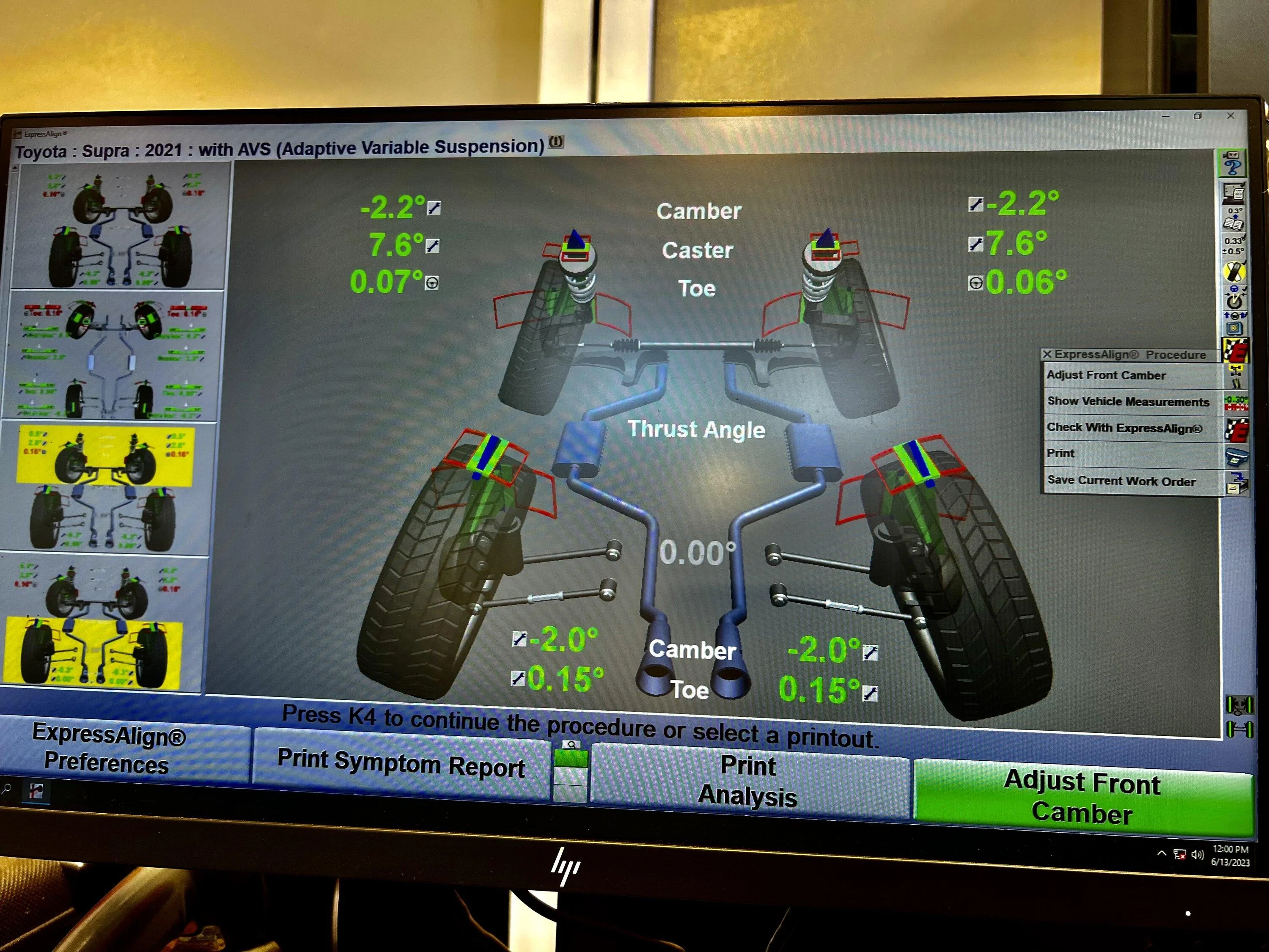

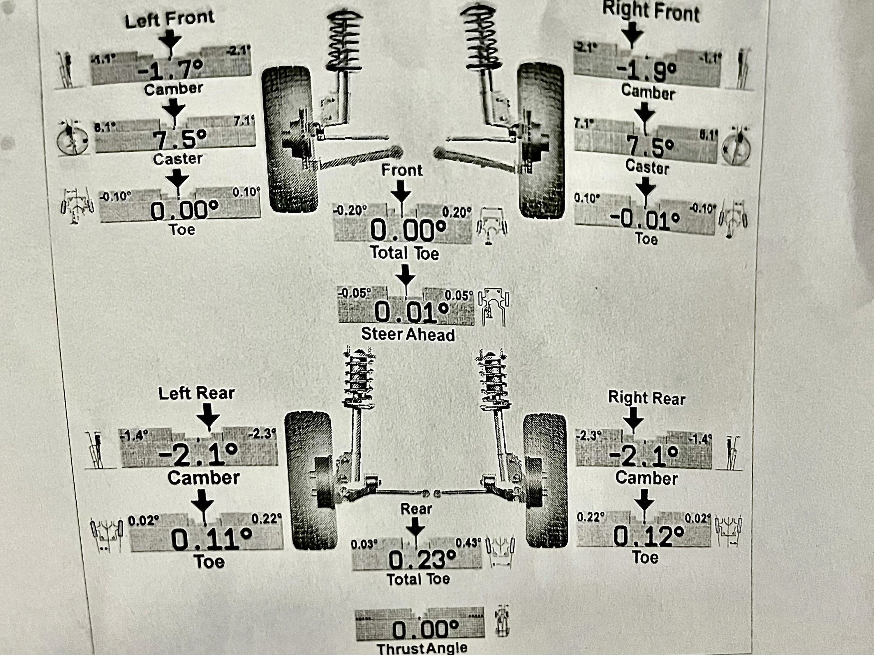

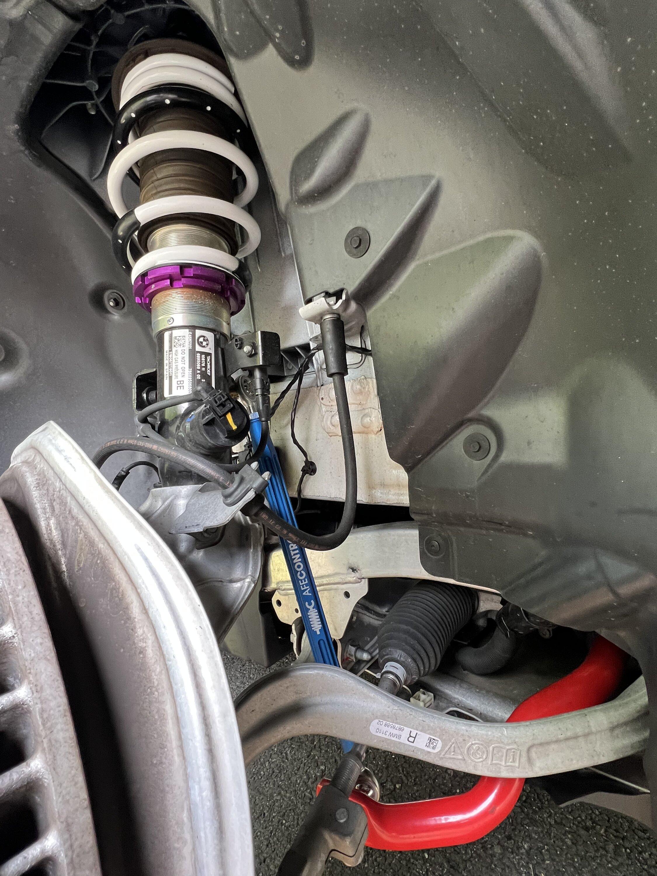

Had my Alignment readjusted and these are my new alignment settings will see how the car will feel on the track and check back.

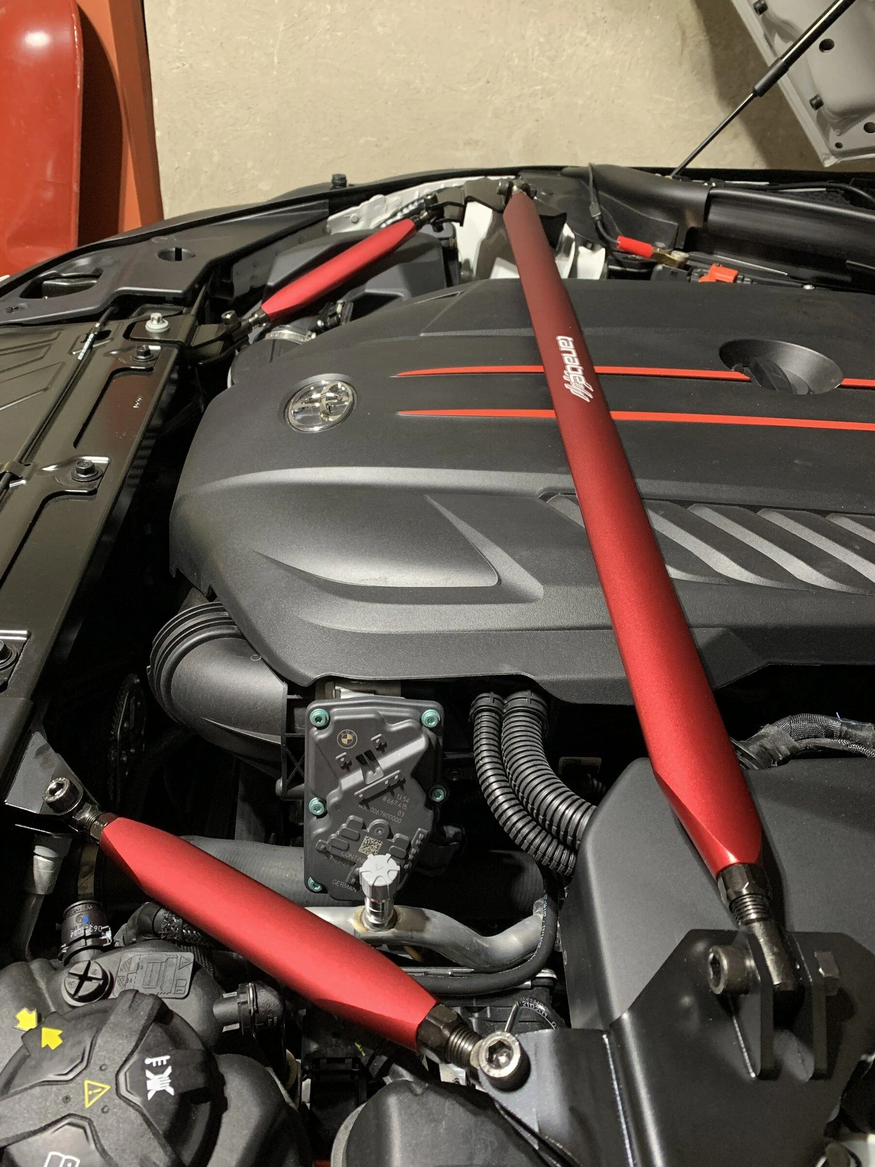

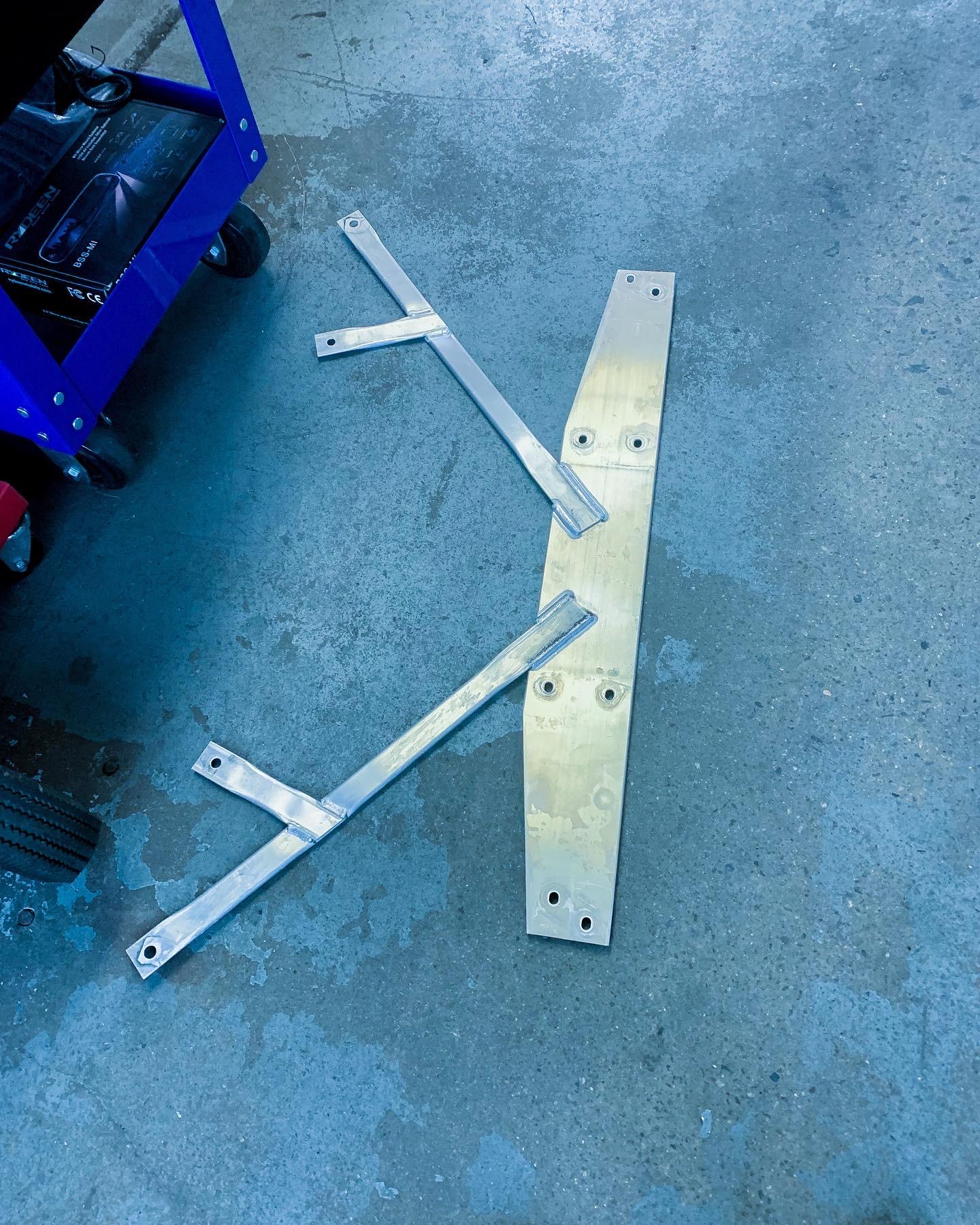

Added a Tanabe Brace in the engine bay solid mod ?
Did you consider adding the tanabe quick release levers? I like the tanabe brace cos looks like you can remove the bars for car servicing access, while leaving the mount points in place.
I thought about getting quick release too, but the bolt placement at the side bars looks like it may not have enough clearance for the release levers.

Did you cos user adding the tanabe quick release levers? I like the tanabe brace cos looks like you can remove the bars for car servicing access, while leaving the mount points in place.
No I do not have quick release levers. I did not know that Tanabe had that as a option.
