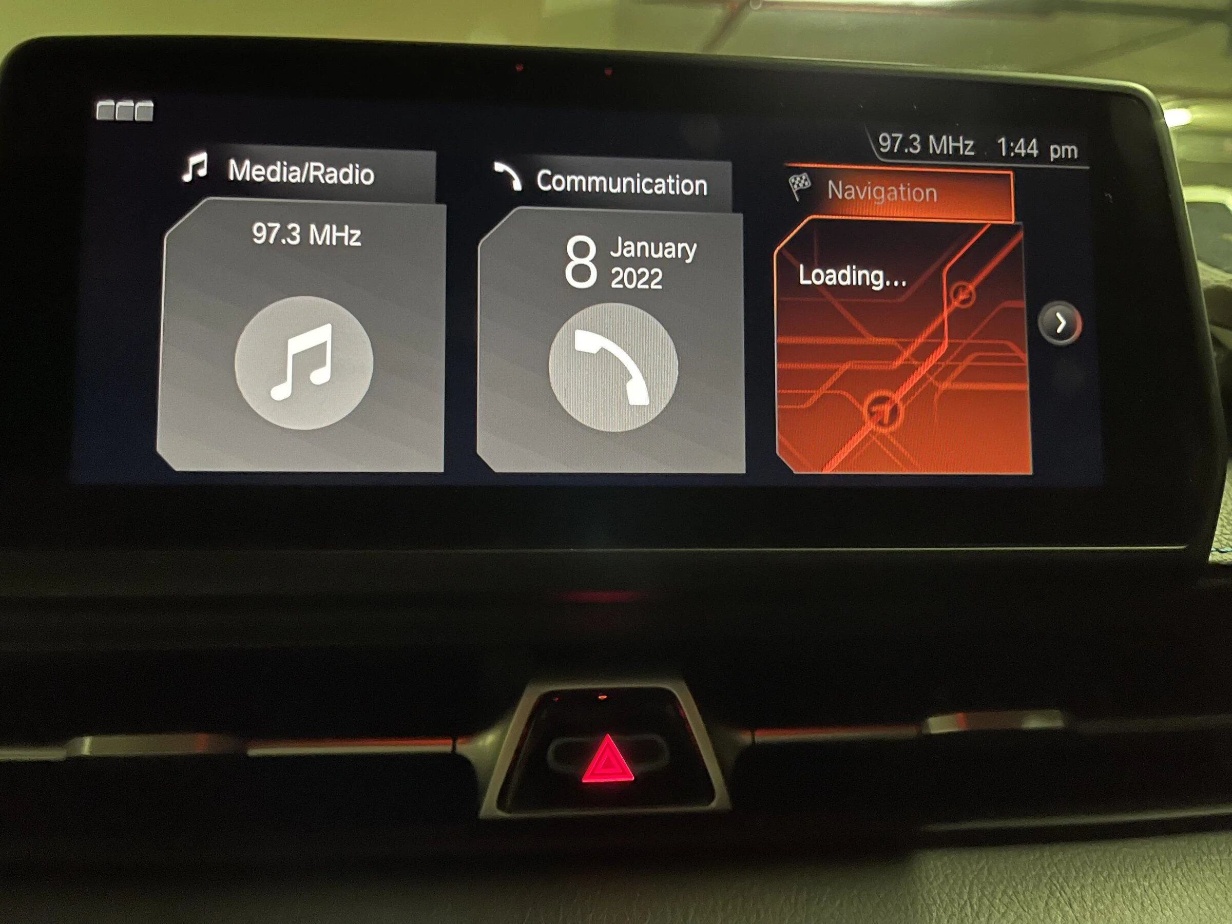

Navigation not loading after software recall
SVR
Dec 3, 2020
UAE
2021 Supra A91
It seems this is a common issue. I wonder what % of Supra's have had this issue?
They told me before they did the update, there’s a chance that the navigation will stop working
