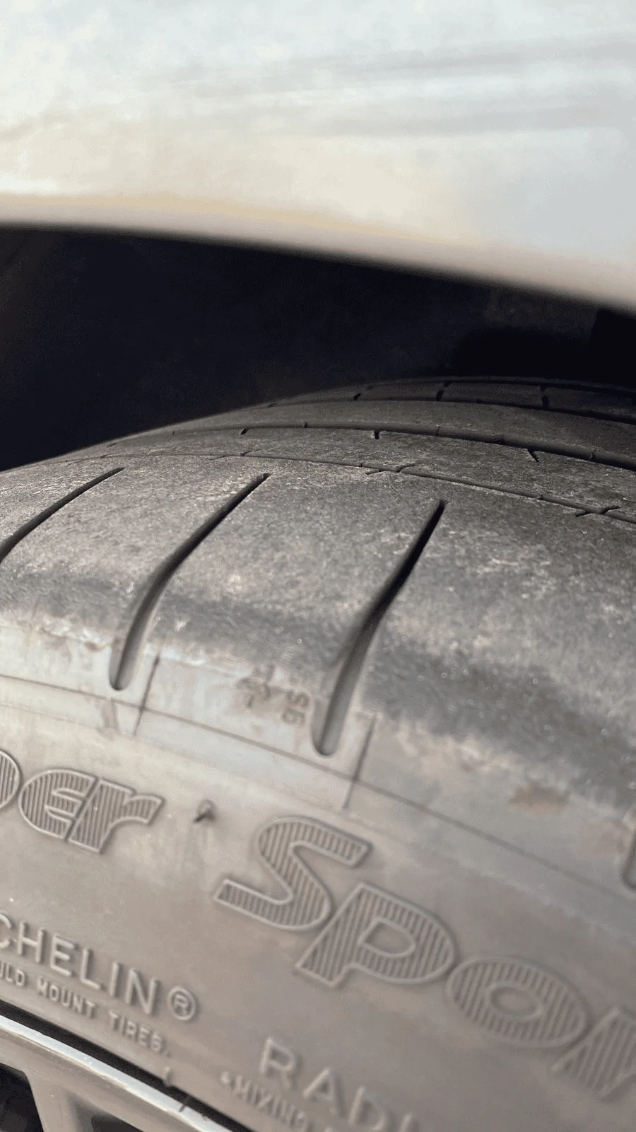

New tires to go with 93 octane - e50 flex tune
