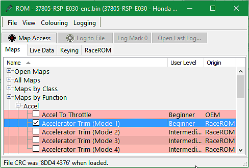

Or even better... since I think the throttle mapping can be tuned as well (not much you can do with the rest without physically swapping parts). Maybe I'm wrong on that, but at the very least the tune should make the existing sport map less twitchy compared to stock.
Edit - yep, although some features may be limited by model/version/etc., but definitely available:
