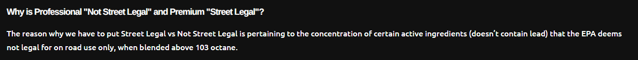

I'd say that's egregiously dramatic.. There's zero evidence it will 'destroy your cats and O2 sensors', aside from the orange tinting. The active ingredient is MMT, which is the same compound found in most unleaded race fuels. I used to get Texaco 100 octane at the pump ("street legal") that turned plugs orange -- why, because MMT -- and I burned literally hundreds of gallons of that stuff back in my MKIV BPU days. No cats, but it never affected either the OEM or wideband O2 sensor (and I laid down higher dyno numbers and ran quicker and faster in the 1/4 than most, FWIW). Boostane has no specific warnings or guidelines for cats vs non on their site; however, some of the FAQ content is worthy of a read, i.e.,
I'm sure that has to do with the concentration of MMT that the EPA has drawn a line at for road-going vehicles. Just as you can get 100 octane straight from the pump, but 106+ unleaded is not available, ostensibly due to the concentration of MMT.
I don't have a dog in this fight, aside from combating misleading information. It works extremely well and I've never experienced any meaningful downsides and I've yet to find anyone that has first-hand. As far as the plugs being tinted, anyone doing the things that necessitates higher octane is (or should be) checking and changing plugs frequently anyway. And if your 'race car' has cats, you're doing it wrong.

Hahaha. You're spot on? I've used it in my 97 supra and it killed the O2 sensors in 10k miles and the cats were collapsing. (stock car) As for now it seems to have no disadvantages to cars that are catless or running high flow cats. No issues the last 25k miles other than mild discoloration. I do believe the concentration matters. It should be noted that all octane boosters are not the same. Lucas Oil only uses 1 to 3% MMT vs Boostane at 3 to 6% I recommend finding a safe mix for your car regardless. VP used to make a octane product as well. We used them on DSM engines at the track
