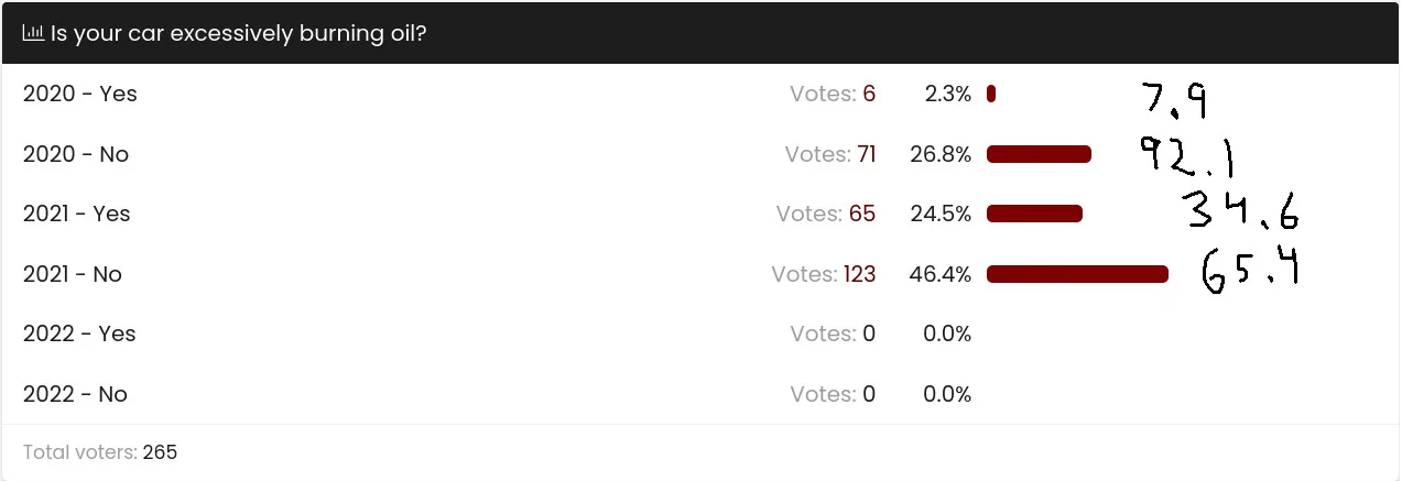

Thanks bunches.
Also maybe change the stats reporting so the percentages apply just to the year.
So for year 2020, 7.9% were oil users.
Or maybe not. But thanks again!

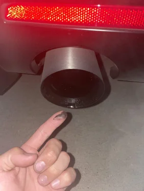

Oil just above the min line now. Every drive it gets lower. Started it up and checked the tips and seen the typical black covered pipes, but this time the left one had liquid in it. Is this oil? What does this mean for me?
I think it might just be condensation. How many miles on the car?
...... That looks bad...
When was the last time you washed your car and did you detail the exhaust tips? My car has right at 4,000 miles on it and last weekend was the first time I've actually taken the time to detail the exhaust tips fully, but that being said, they looked NOTHING like that! That does look like condensation build up, which is normal with these cars on first start because the car is designed to rapidly heat up the cats so that you can drive it really quickly, but the exhaust soot you have on your exhaust tips looks a bit excessive to me.
Edit: Looking back at the picture you posted, that does kind of look like a little oil droplet on the end of the tail pipe.
i never cleaned the tips before. tbh its prob nothing but this whole rapid burn thing has me worried about everything now..:confused1:
Forget what I said about it looking like an oil droplet, I looked back at the picture even closer this time and it's clearly just condensation pooling up. In that picture it actually looks like there is a ton of build up on your exhaust tips. Maybe try cleaning them really well with some soap/water and 000 Steel wool and then see how long it takes for them to get coated in soot again. Also as many people have stated, you could try swapping to 5w-30 Liquid Moly and see how that works for you. Some people have said doing that fixed the issue entirely and haven't seen a single low oil sign again at all.
Edit: Also, what is that "etched" look on your exhaust tip? It almost looks like when someone tries to peel plasti dip off of a wheel or something.
huh didnt see that before :hmm:
