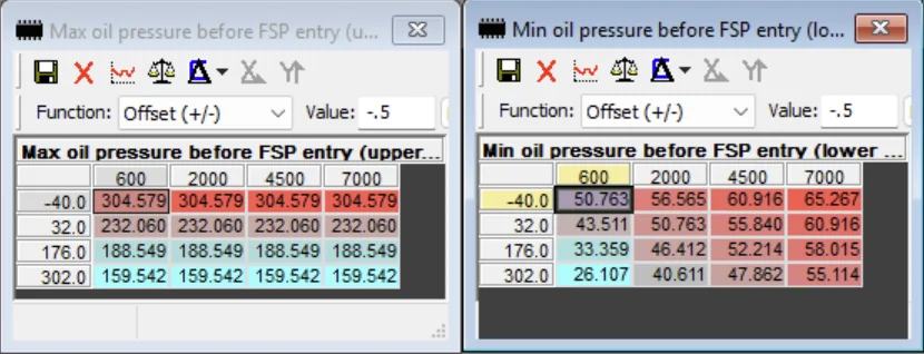

I'm defining more tables in my DME and I found these two that might be of interest in this thread.
Max and Min oil pressure thresholds before it sets an error.
Axis's are oil temp F and RPM. Table is oil pressure in PSI absolute
