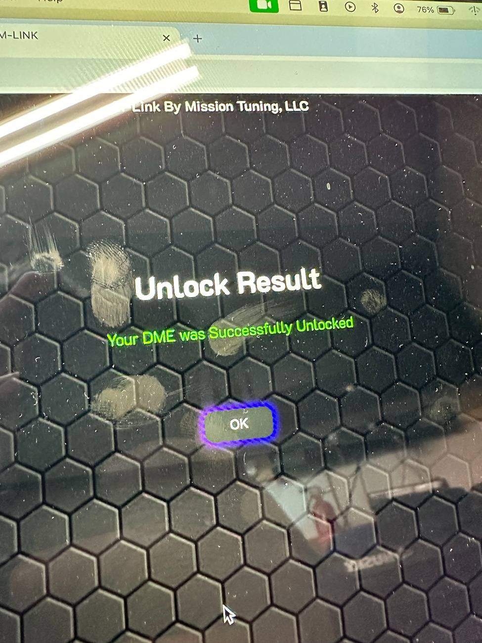

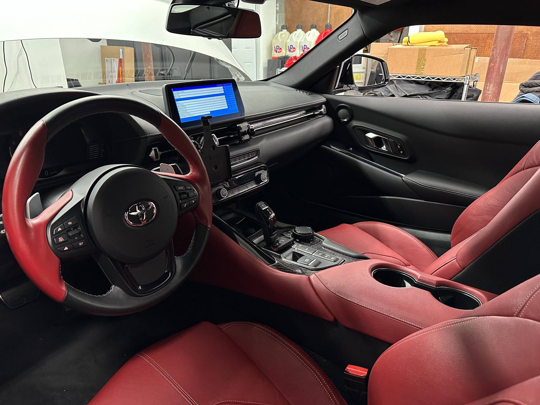

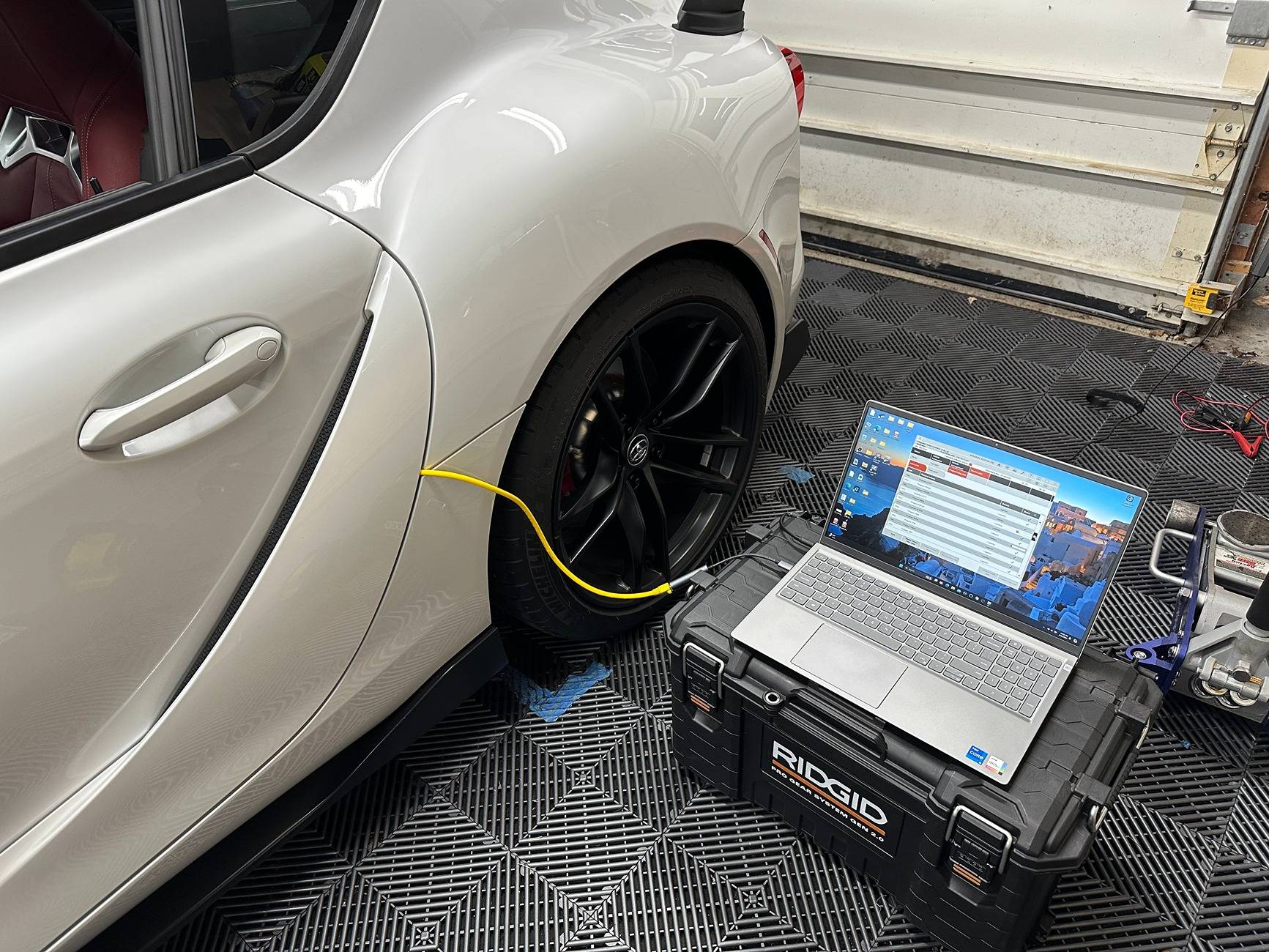

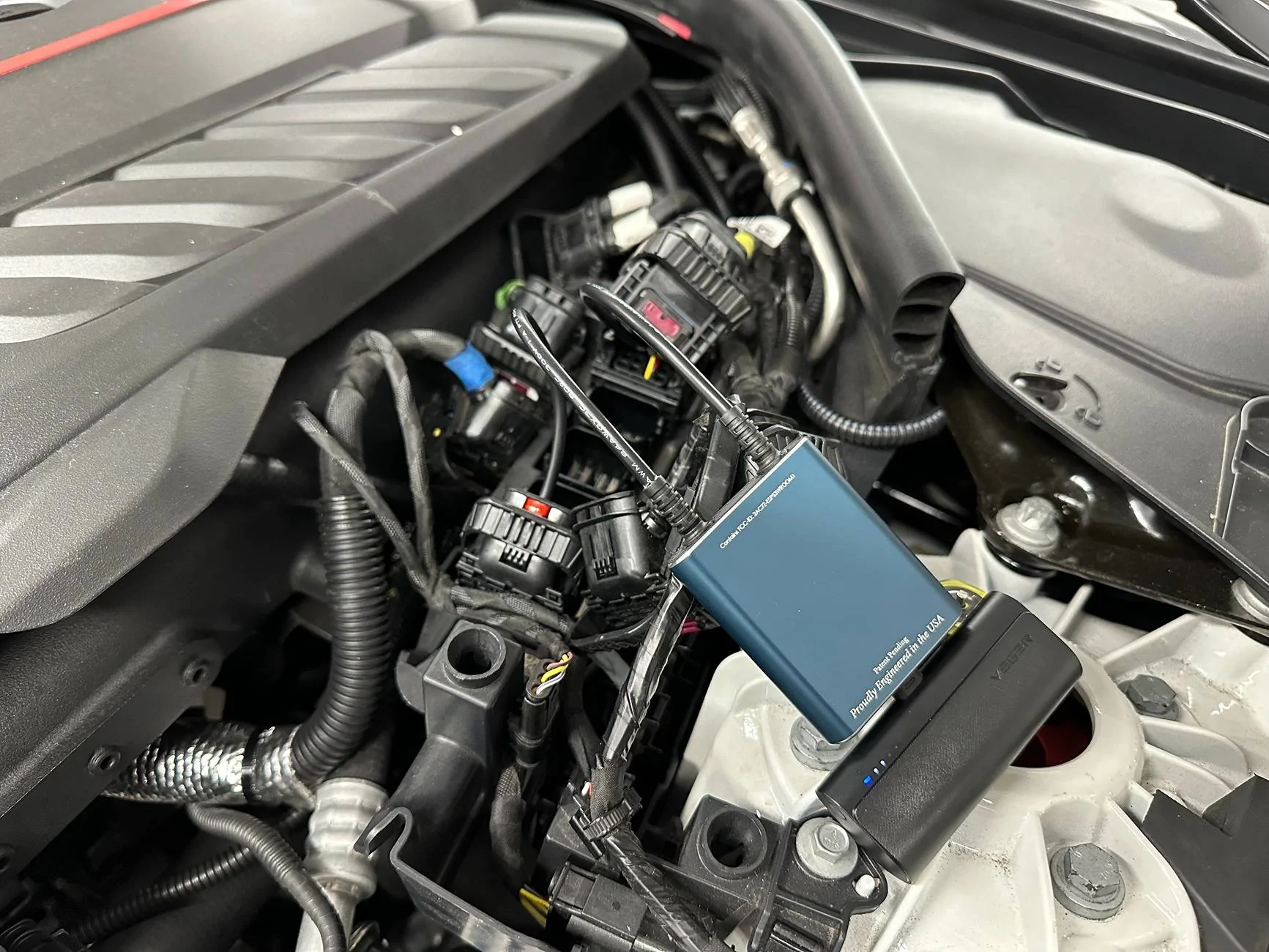

You will just need to bench unlock, no FEMTO needed. I updated my 2020 ECU last year via ISTA/ISTEP and just had to do a bench unlock.
Good to know. Thanks for the info and pics.
