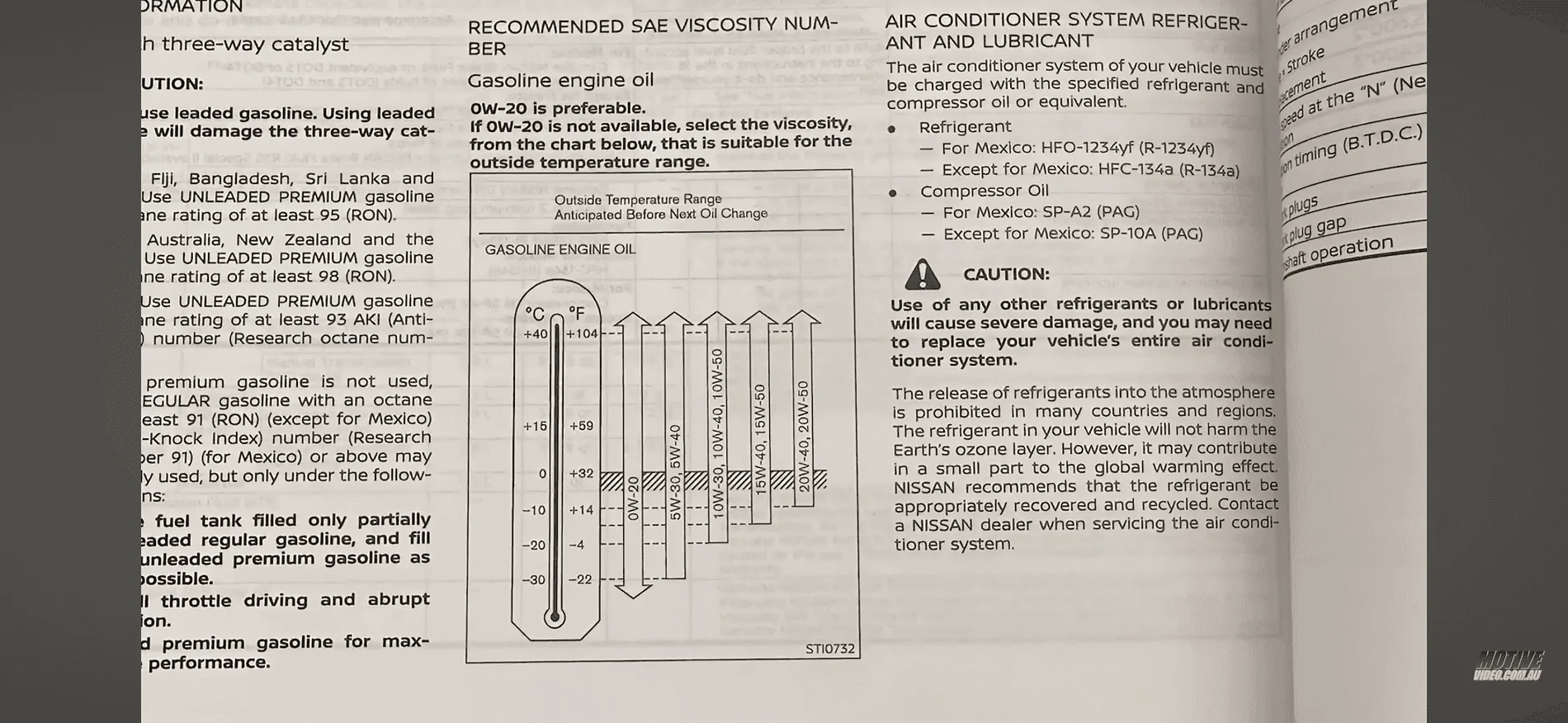

Different car, different engine, interpret how you will. Taken from a Motive Video YouTube channel video, it's apparently from the owners manual of the 2023 Nissan Z in Australia.
8,805
17,280
Oooof. The OP is *really* going to have a fit with this post.
