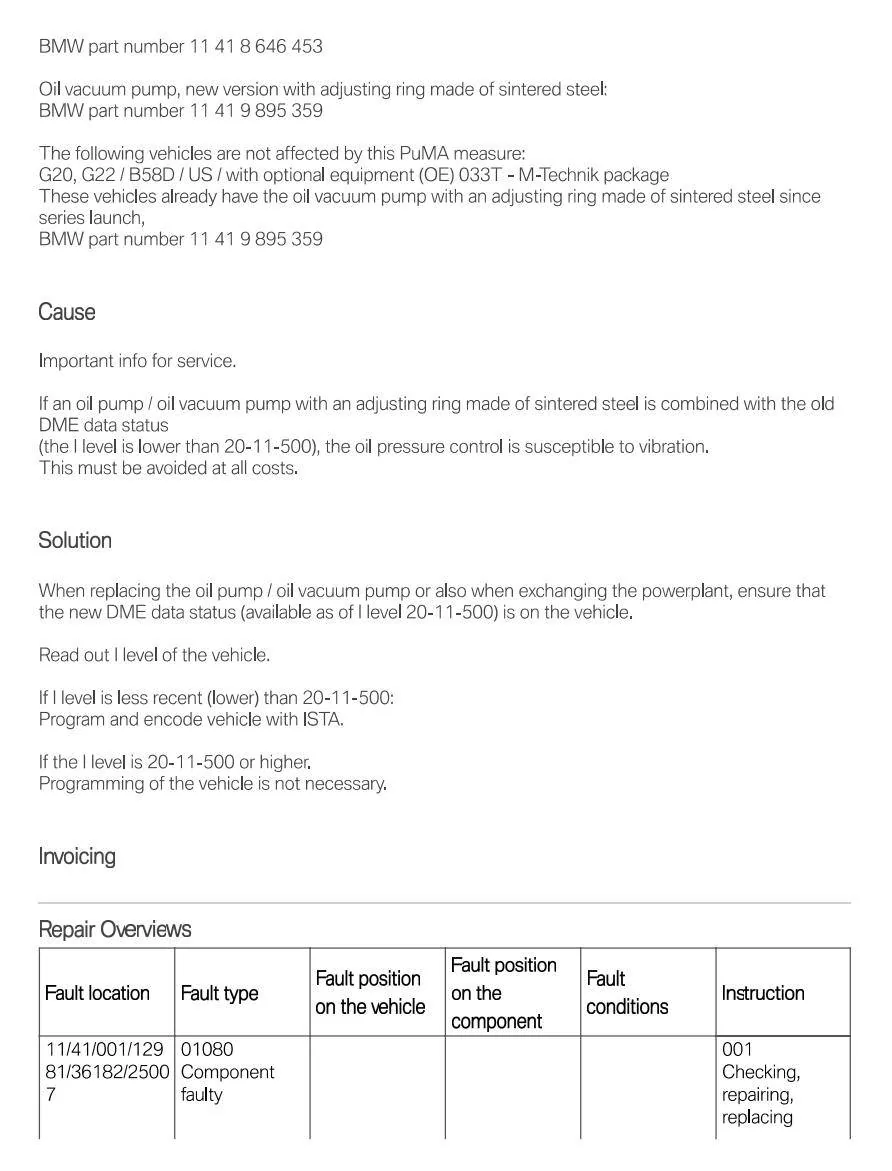

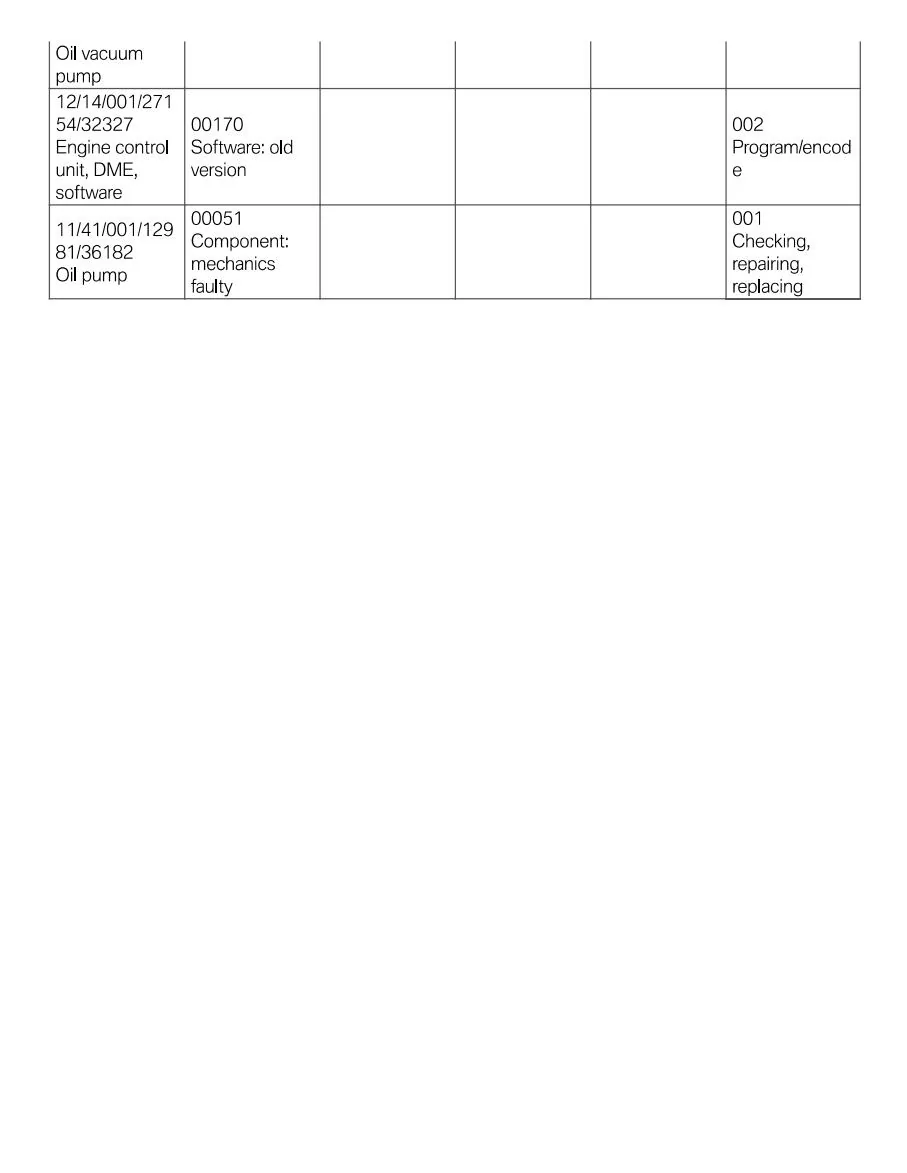

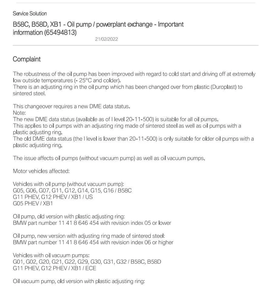

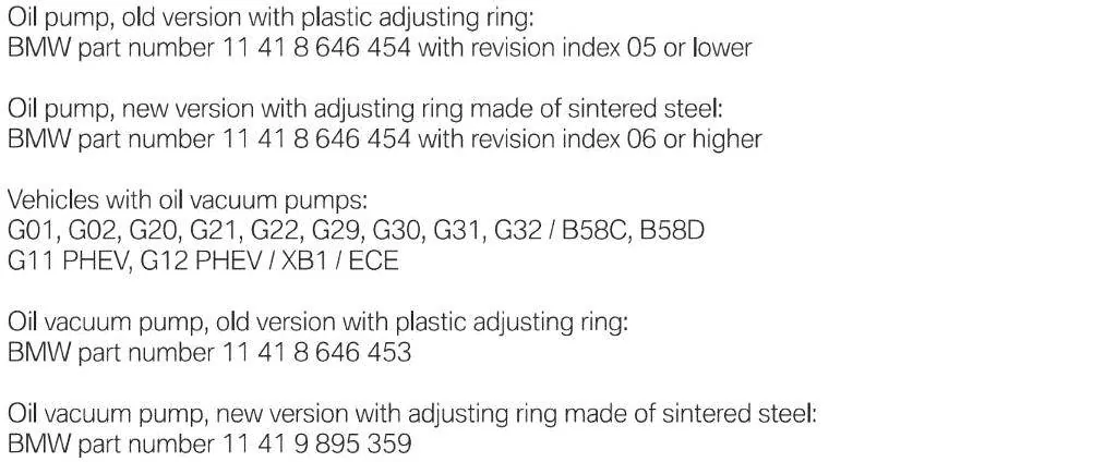

I think the issue here is that Toyota dealerships were never sent a bulletin with the change and superseded revision index like BMW dealers were. You drop off your car for warranty work or order the part, Toyota dealers keep nothing for the Supra in stock, so the parts guy orders the newest part from their warehouse, and you automatically get the updated part that fixes the problem.
The issue affects the earlier cars up to mid-2021. For reference, my build date is 07/10/2020 and is affected. I am outside of warranty - just barely past 60 months of ownership - but to be fair, I wouldn't want anyone else to perform service to my car anyway. Sure most of you can relate.
The part number for the old and new pump are identical (as you can see from the extremely helpful post above this one). What you have to make note of is the revision index (06 and higher is the correct part with the sintered steel adjusting ring), and for my fellow DIY-ers, note that you need a software update as well. I will attach the BMW info in case it helps.
This is the most tangible/‘official’ information I’ve seen posted here or on the BMW forums thus far. A few thoughts…
  1. Is BMW outlining two separate types of oil pumps, one with a vacuum pump (11 41 9 895 359), and one without (11 41 8 646 454 index 06+)? A quick check on a BMW parts website confirms this is likely the case. Most G series models have the vacuum pump except a few such as the X5.
  2. The model and timeframe overlap between failing oil pumps and the earlier ‘brake booster’ recall Is interesting; vehicles produced with B58TUs between 2019 and early 2020. I’m wondering if there’s a relationship between the two; e.g. the recall addressed a situation where the crank briefly spun backwards thus breaking the vacuum booster. Was that also about the adjusting ring? To be clear, this is 100% speculation on my part. Page 6 of this document provided by the NSTHA has a good summary of the recall.
  3. Tied to the above, this is the first I’m hearing of an associated DME update for failing oil pumps. If I’m understanding the document correctly, it is outlining a minimum i-level from 2020. This sort of ties to my point above, and is perplexing.

Yes, exactly. Sorry I didn't share the whole document, I just wanted to keep the dealership and my friend anonymous since I am pretty sure this isn't supposed to be shared for public consumption. But I just cropped the dealer info out.... we need this to keep our cars on the road!! Here is the entire document.
Hope this helps!
Thanks for posting that info from BWW. I hadn't seen it before:
According to that info, the revision index 05/06 distinction isn't relevant to our cars. That part is the 11-41-8-646-454 "oil pump" used in things like the 740i and X7.
The part that matters to us is the "oil vacuum pump", part numbers 11-41-8-646-453 (bad plastic) and 11-41-9-895-359 (good metal).

f series bmws have been using the plastic oil pump adjustment rings forever, including in the m cars. on the supra there are 3 versions:
plastic ring, plastic vacuum cover (mahle)
plastic ring, metal vacuum cover (omp)
metal ring, metal vacuum cover (omp)
the middle one is the one with issues

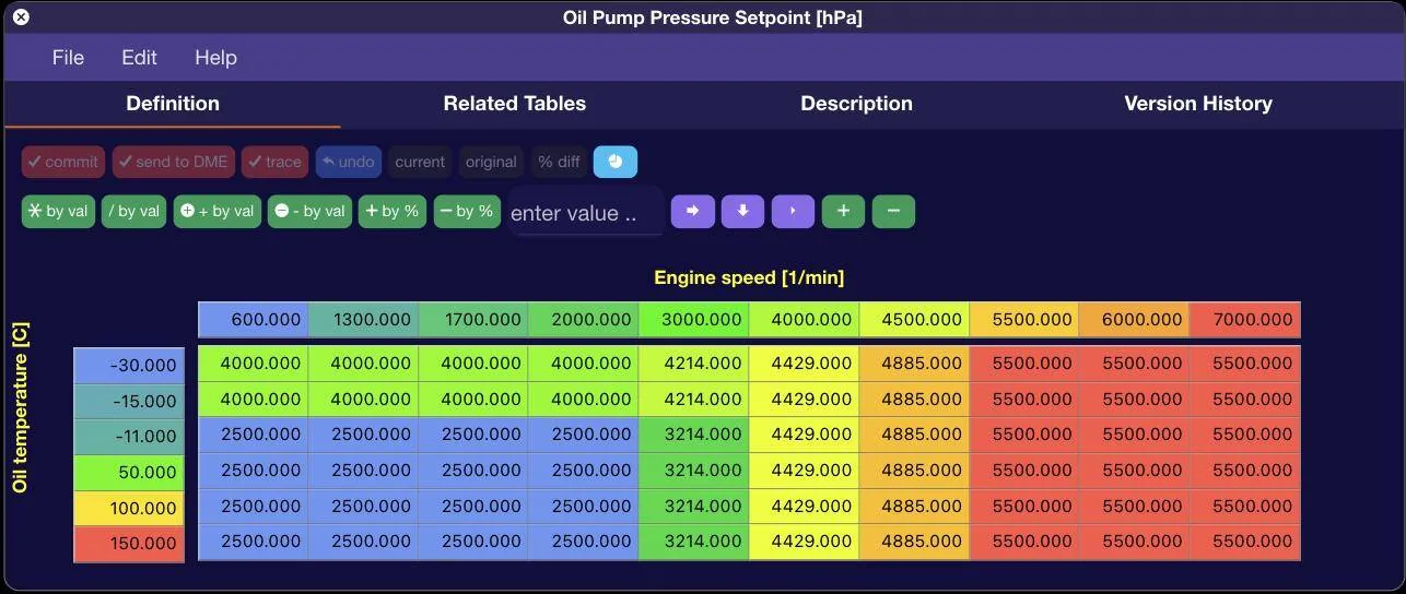

Has anyone seen abnormal pressure measurements in BM3 when the oil pump is damaged but still functional?
The pump failsafes to high pressure, so if you are seeing abnormally high pressure...
So does normal pressures in BM3 exclude pump issue? Thanks razorlab for the info.
8,835
17,332
Not clear on what you are asking.
Do you just want to know what OEM oil pressure setpoint is when everything is working correctly?
Here you go. It's in hPa to convert to PSI and subtract your ambient pressure depending on how you are logging.
I had the low oil pressure warning come on and was unable to check oil level in the Toyota oil settings. Found this thread and thought it was my oil pump. BM3 oil pressures are normal. I'm out of warranty with miles and mods so cost will be on me. Debating if I need to change out the pump as when I got the 2nd low oil pressure warning it was on for 10 seconds and went away. No CEL and car drives fine. Worried I'm driving on borrowed time or if there's something else I need to look at. Thoughts anyone?
