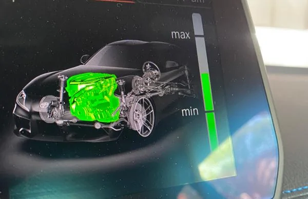

Thanks for this -- much better to establish the data rather than try to aggregate posts ;)
FWIW, I'm not sure I'd qualify as "excessive" but voted Yes since there has been some consumption.
Additional items FWIW..
Daily Driver: Yes
Time since oil change: 3000 miles (verified "max" at fill up since I did it)
Driving style: Hard but also cruising 55 miles a day
Track time: ~3 hours consecutively

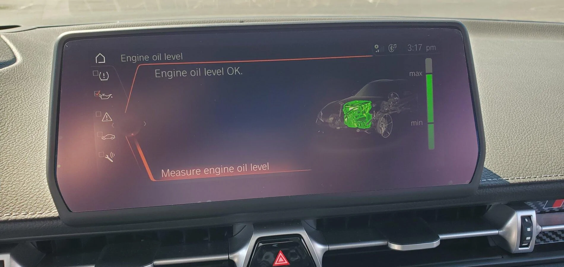

2021, 3.0 B58. Every time I hop in the car it's almost exclusively in sport manual and I'm driving it spiritedly. Oil checked at 2,200 miles, no oil change done yet, and it's at the max fill line.
